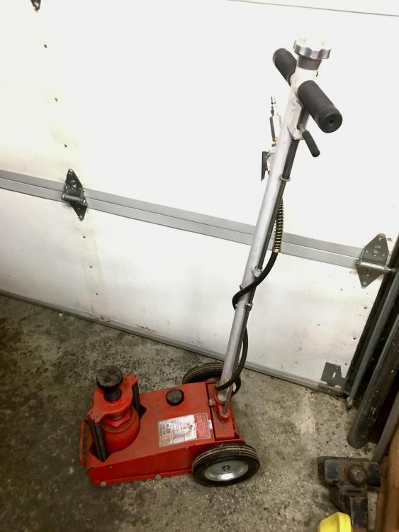

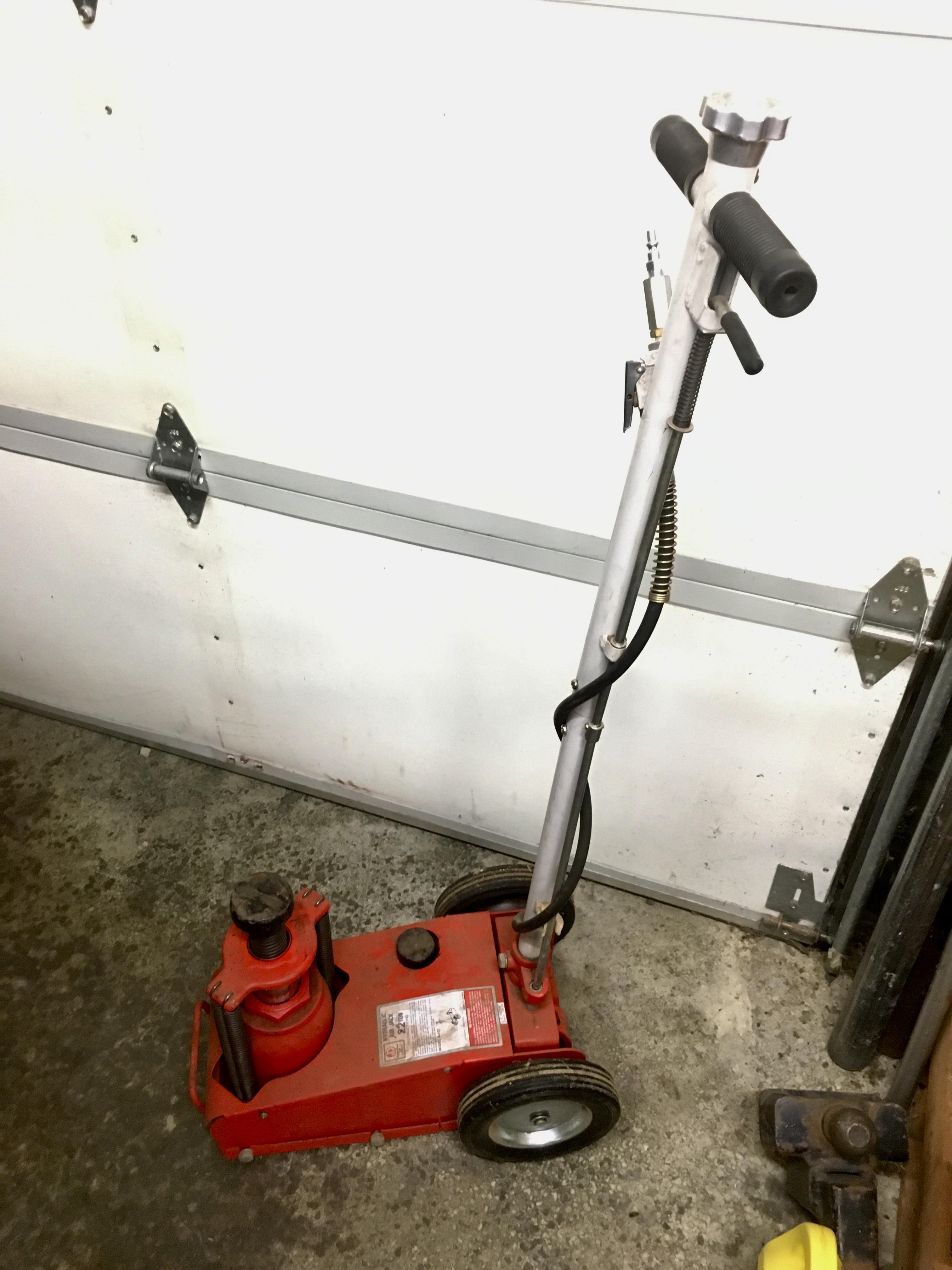

I had to add another jack when I got the Ram 3500 in 2001. It weighs around 8,000 lbs or so. The options were another floor jack like the 2 ton Snap On only rated to lift more, which are large and cumbersome, or an air over hydraulic heavy duty jack.
I chose the latter. Rated at 22 tons it is a bit of overkill, but the design makes it easier to use in tight spaces. And it proved useful when I picked up a motor grader 15 years ago, which weighs in at 25,000 lbs.
