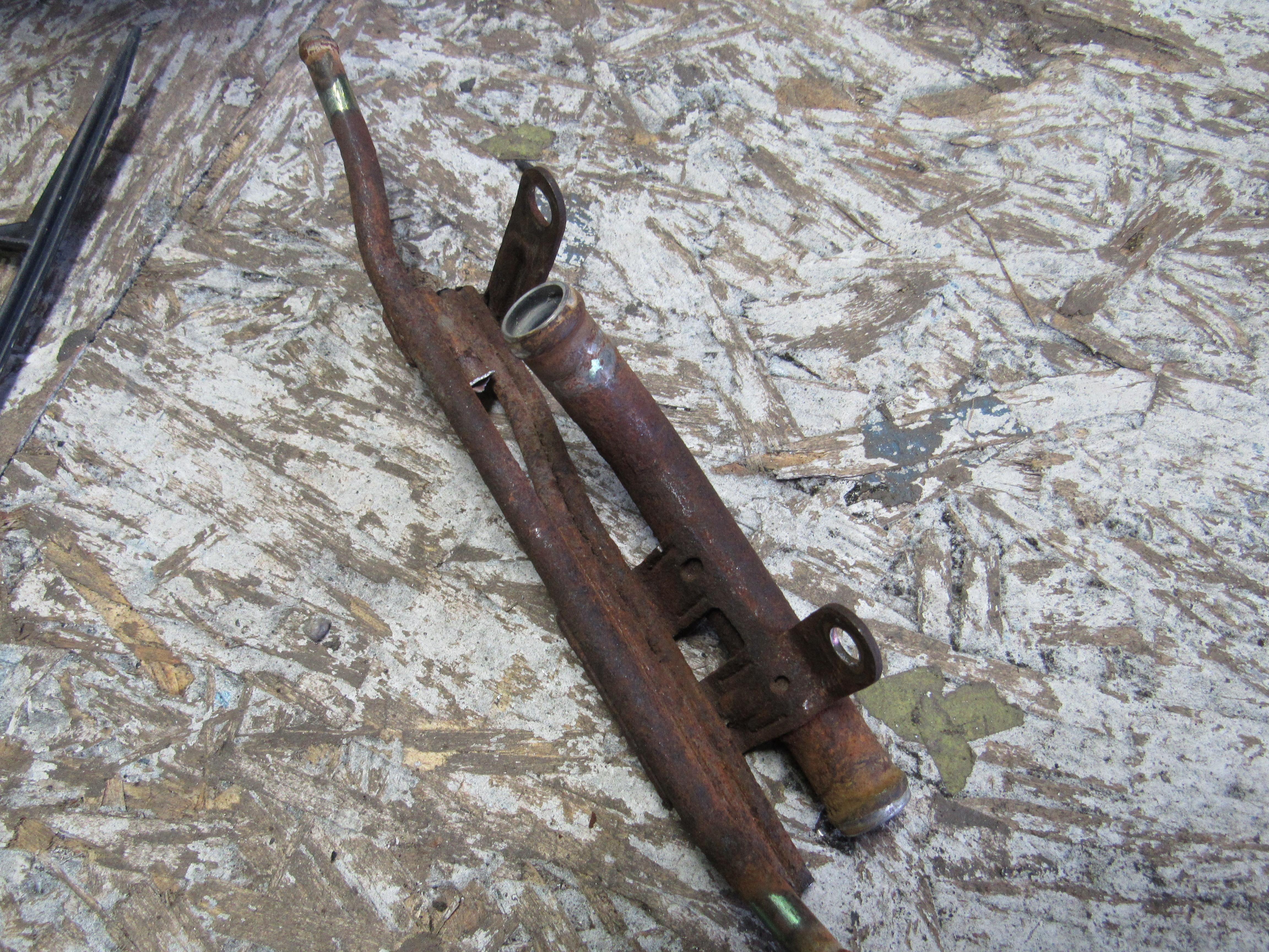

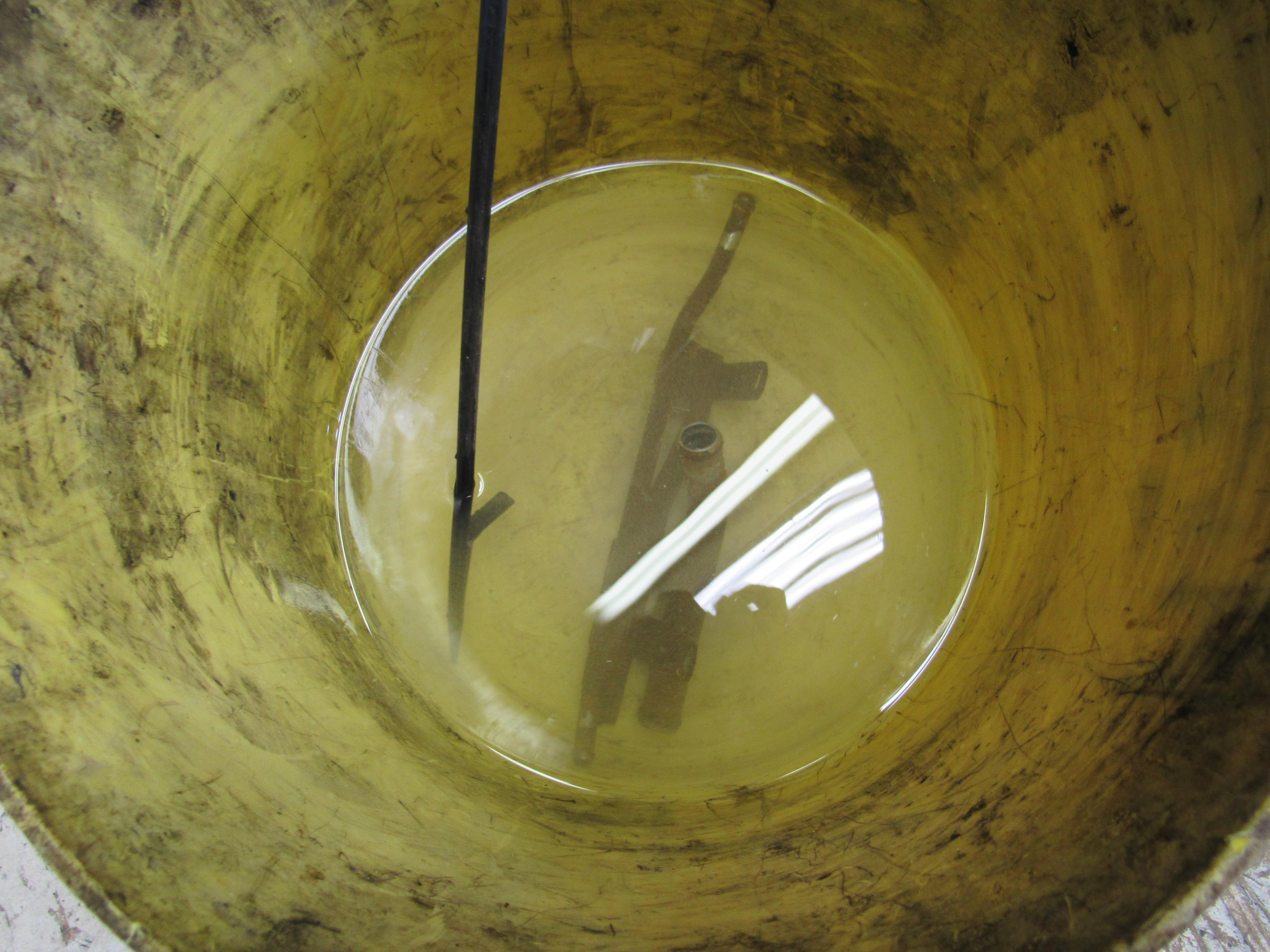

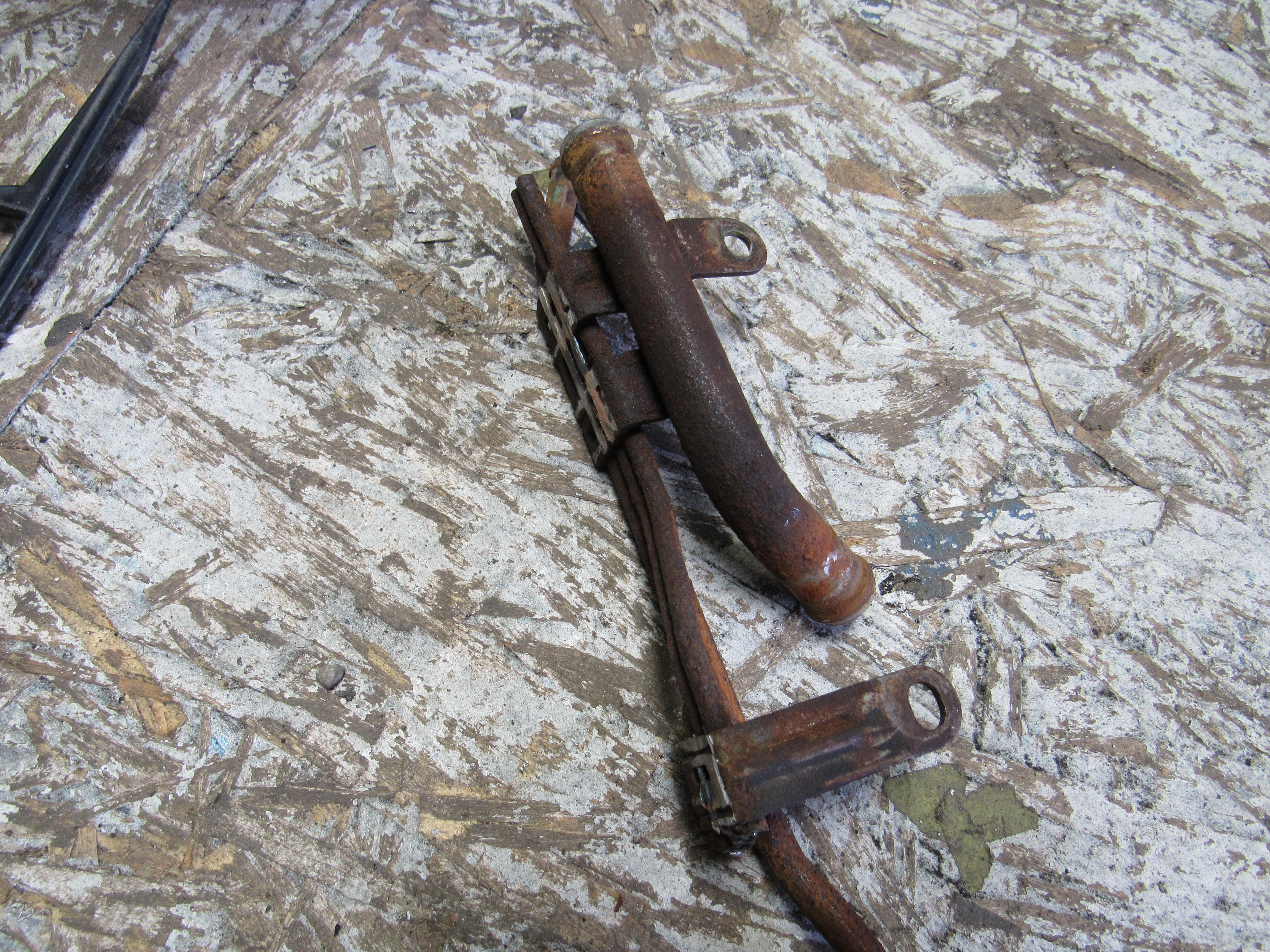

The test piece is from the KA24DE engine I'm using in the 510,  2 cups of Citric acid in a gallon of water, all I did was scrape the worst of the flaky rust off.  The shop is cold, just above freezing, when the water is room temp in the summer rust removal happens a lot faster.  If you splash some on your skin you just rinse it off, there is no drama, no burns.

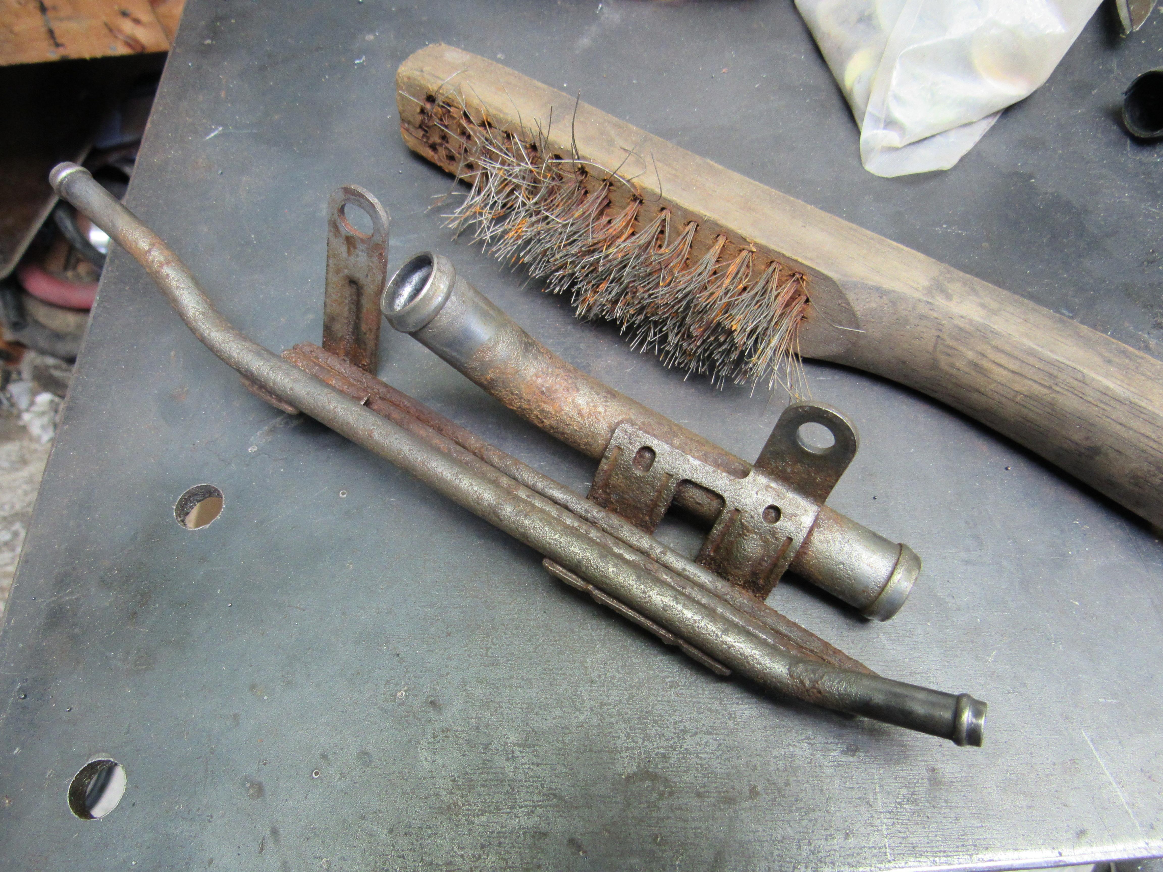

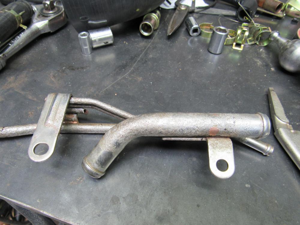

These next 2 pics are after 20hrs soaking, took it out of the bucket and scrubbed it with an old wire brush and rinsed. The last 2 pics are after an additional 24hrs.
Now that might seem like a long time but I have lots of that so I'm good.  Muriatic acid is 10x faster for sure but I have never found a way to completely neutralize it, the rust always comes back under the paint,  so far that has hasn't happened with the Citric acid pieces.
Top tip...  Saw the first 1-2 inch off the brush.. you have a good brush again!  That piece of wood gets in the way with brushing.. now no longer! :pow:
Use a steel saw..

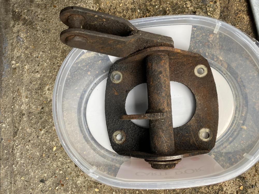

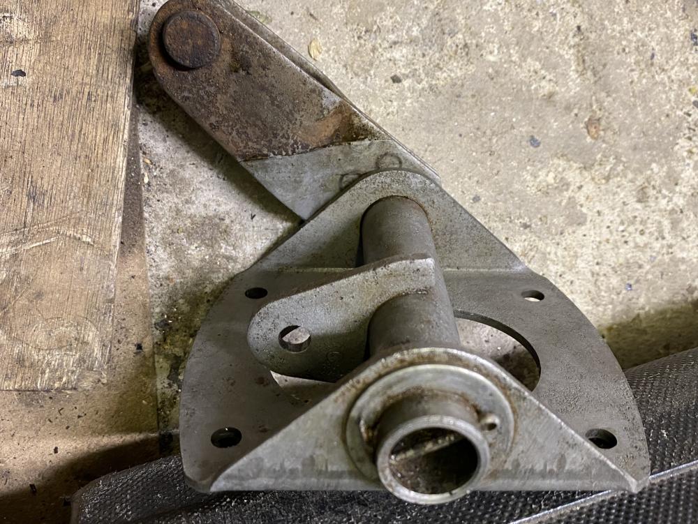

Just to offer an alternative: I was frankly amazed how good this experiment went.
I bought 6 bottles of the cheapest / nastiest bottled lemon juice off the supermarket shelf.
Poured into an old ice creme tub and added lots of salt - no scientific measurement, just what felt right. If I had to quantity I would say 2 table spoons.
Degreased parts with thinners, then left them in the lemon juice and salt tub for 12 hours overnight.
See for yourself:
c495ef564176067777947ecf812d7d77.plist
Why did you add salt?
I read somewhere that it speeds up the reaction. Interesting thing was that the garage / the solution smelled like sulphuric acid after the 12 hour soak. But I’m no chemist.

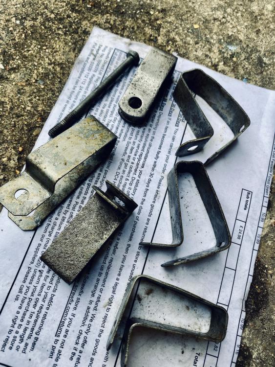

I reused the solution many times over and it worked well ...
8f9645d27b9e9ca052c22dd29752f1db.plist
1d36141e4fb6f18b4404288735e38ca4.plist
Before this, I wasted way too much time with a wire wheel and drill achieving lesser results!
OK I’m gonna shut up now, I feel like I’m thread jacking!

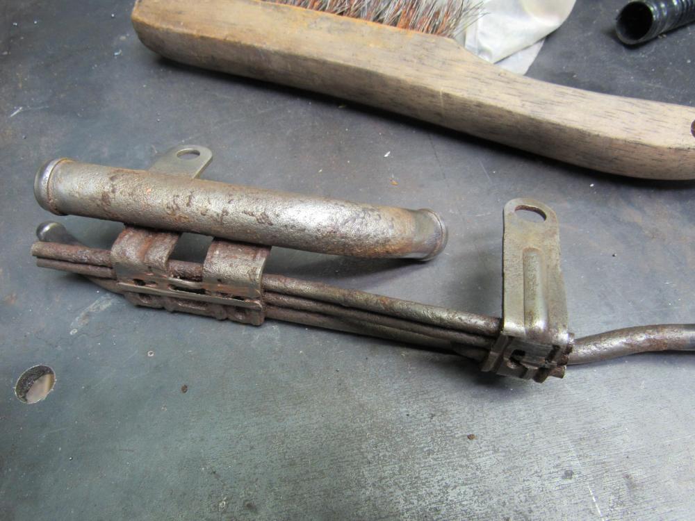

Brothers from a different mother, I tell ya.   I've gone through thirty pounds of the stuff in the past two months.

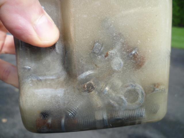

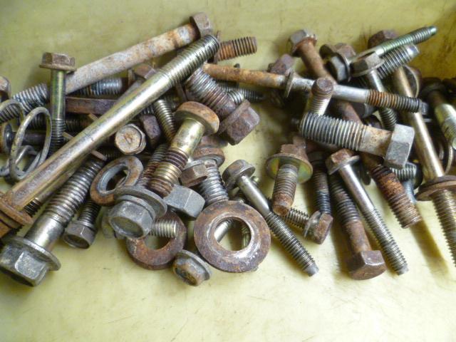

It's really hard to get a good picture of the results, but I tried. Here's a handful of misc hardware. Before:
I put the stuff in a wide mouth plastic container for a couple hours. When I first put the stuff in, it bubbles and becomes a little milky looking from all the tiny bubbles. I think that's the remaining yellow chromate and zinc plating being eaten off:

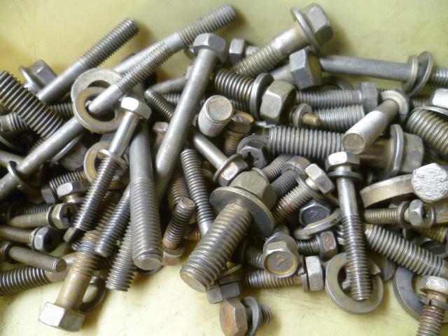

And then after a couple hours. They aren't sparkling perfect, but are a whole lot better than when I started:
Here's about the only good shot I have of before and after:
That's a trick used with acetic acid to speed up the reaction. Apparently acetic acid works better than citric (but it stinks) and the addition of salt makes it work even faster. So fast, in fact, that they warn you not to put anything aluminum in the solution because it will be damaged. I don't know for positive sure if it has the same effect with citric, but like Granny, I did the same and added a little bit to my mix. I figured it wouldn't hurt, and may help.
From what I understand, the citric does not convert the rust to anything, but it is "chelated" instead. And my (quite limited) understanding of the whole thing goes like this...
Rust is not normally soluble in water, but additions of certain additives (like these mild acids) make it so that rust IS slightly soluble in the solution. I think that makes the acid additions to the water "chelating agents". So once you add citric acid to the water, rust becomes slightly soluble and "washes" off the parts. Doesn't happen quickly, but it happens.
So back to my very limited understanding... There are several different combinations of iron and oxygen that can be called "rust", and the addition of salt changes the ionic characteristics of the solution and makes a broader range of them soluble. So in other words, "a wider range of rust types are soluble".

Does surface rusting restart once it is out of the solution? Or the chelating removes all of the rust particles and as long as the part is dry between removal and plating, it won't start to rust?
So with my solution, I dropped the parts into clean water straight away to flush them. Then I would drop them into a container of Jenolite and ensure all surfaces were covered. This converts the surface into something that turns it purple and supposedly doesn’t rust.
3abf32e50abb7c65ca338abf9c66d9f3.jpg&key=a44140339d9124df25912592ec3310b9db9bbd7fae04eead2ec7b539a2186104
The parts I didn’t Jenolite started to turn dull all too quickly as those pesky o2 atoms started to attach themselves!!!
After the allotted time and drying throughly, I just painted them; as at the time we were in serious lockdown and I couldn’t get to the plating place.
