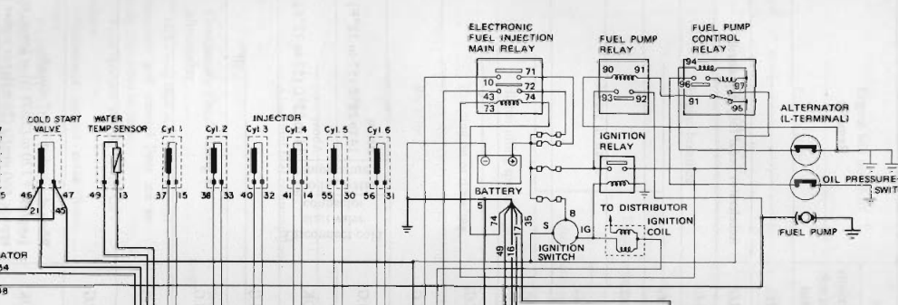

don't understand what you are saying. Jumping the cold start vale terminal? the engine is turning over? you mean something your are doing is causing the starter to engage?
It maybe possible to energize the starter solenoid by applying power to the positive side of the harness that plugs into the CSV I suppose, IIRC they share a common lug on the ign switch "start". But if that is what you are doing that is the incorrect way to activate the CSV to depressurize, You only want to apply power to the csv, not the harness, and frankly you don't need to do that, just put a rag around the fuel line at the fuel rail and loosen the hose clamp. there is not that much fuel stored, the rag will catch it and keep it from spraying.

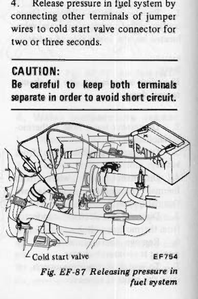

Here is standard practice.  If you do this without disconnecting the plug you might be backfeeding the ignition switch or some odd thing.  Maybe you had the key On whereas before the key was off.
Oohhh sh*#*#*    that's showing the terminals on the cold start valve itself. I must have been inhaling too many gas fumes! I was touching my jumper wires to the plug not the terminals on the cold start valve! The scary thing is, is I've done this correctly many times. Thank you
