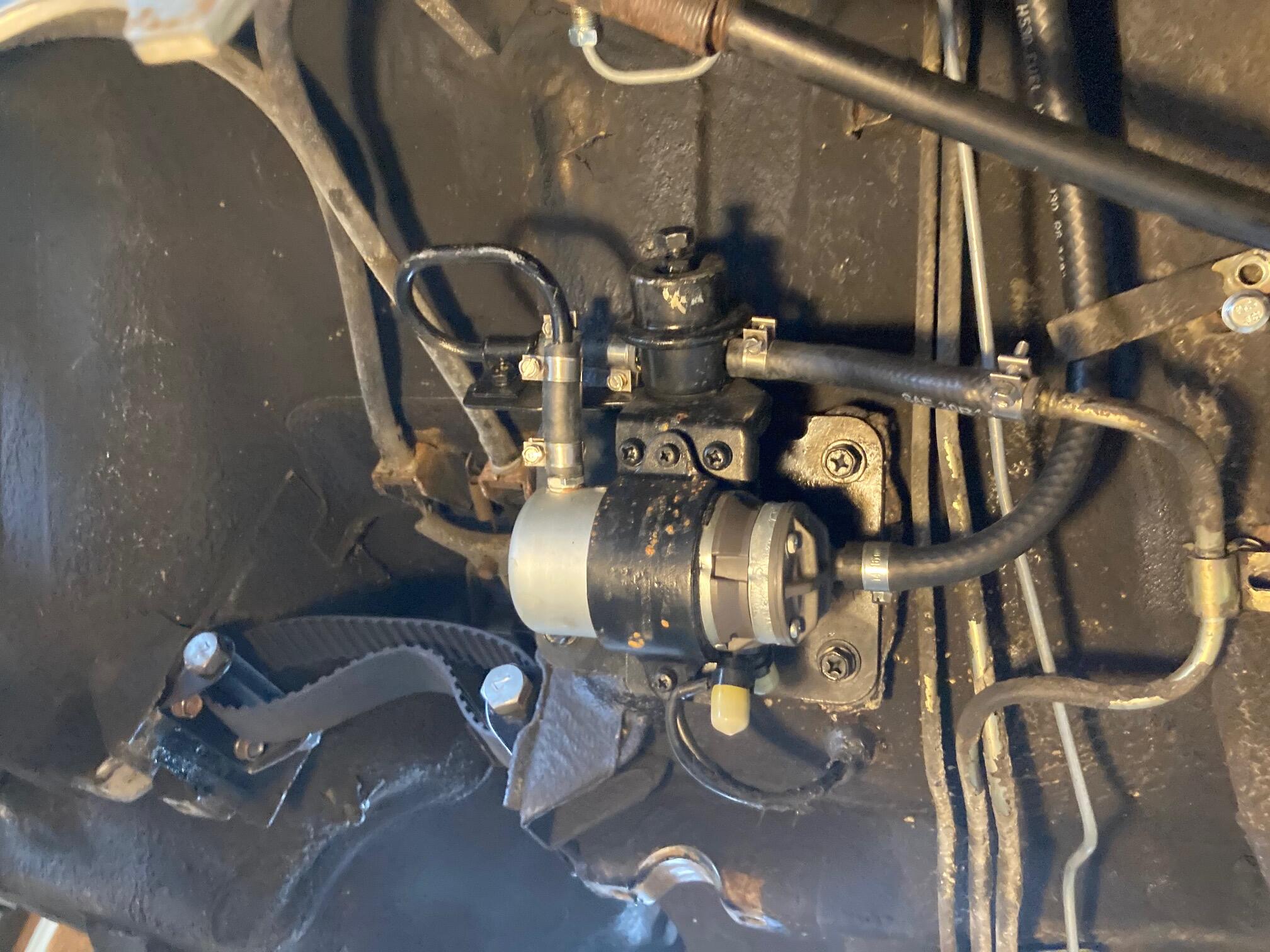

The bottom tube is for bypassed fuel keeping the pressure from getting too high, it's returned to the tank in a proper set up. Seems like we're discussing a very missed attempt to put an NLA dampener "looking" part on a high pressure fuel pump. The PO was going by looks instead of function. Had he searched he would have found an alternative.
If that is what the device is, then the bypassed fuel would pour out the open port, onto the ground.

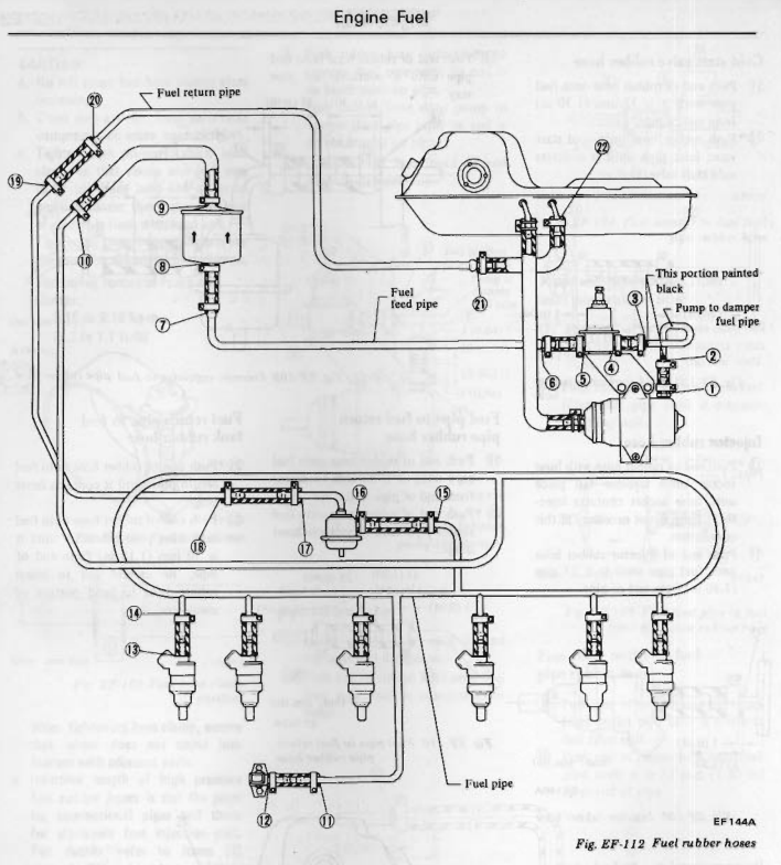

So the device on the BAT car is item 16 in this diagram, which would be mounted near the injector fuel rail, under the hood, not at the rear of the car downstream of the fuel pump.
In zspert's photo they could have used a straight 5/16" hose barb and saved some money. That FPR is not even a good stand in look-alike for the proper part. A '75-'77 FPR would have been a better con.
On 6/29/2023 at 6:23 PM, zspert said:
Now, what was he trying to address with this trick?
Maybe just saving some money?  Didn't have spare hose or tubing?  Had a spare FPR laying around and needed to stop a fuel leak so he could sell it?

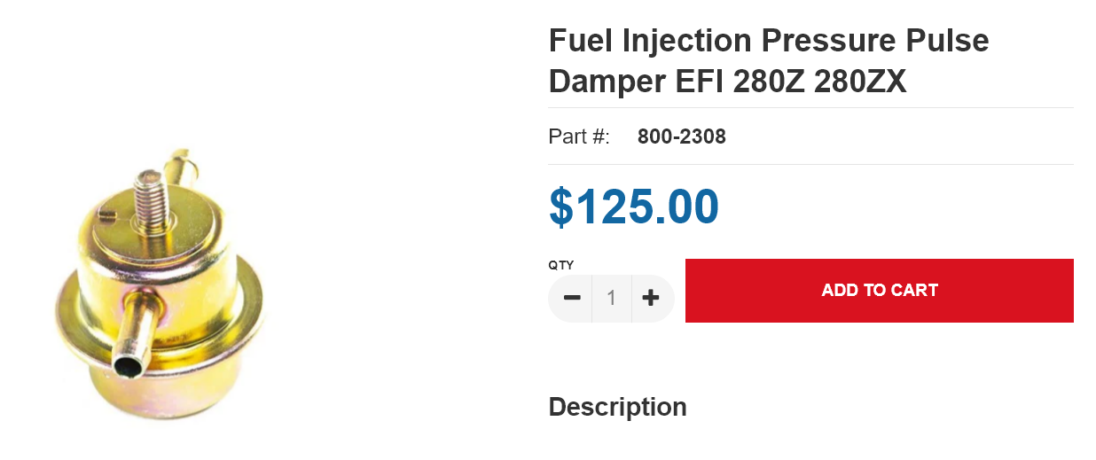

There was a thread in the past about alternatives.  They're out there but if you go to the Z specific web sites, that looks like a quick and dirty good idea.
https://zcardepot.com/products/fule-injection-pressure-pulse-damper-efi-280z-280zx
