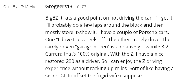

I know the bidder of the $110k. I didn’t know he was going to bid, but I did point him back here to see what is being said. I think that he did. He purchased a BAT 280 awhile as a driver and is planning to back date the bumpers. He has always wanted a orange 70 to add to a couple Porsches and a Ferrari collection. He is real, not any part of a plan to raise the valve.

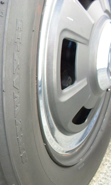

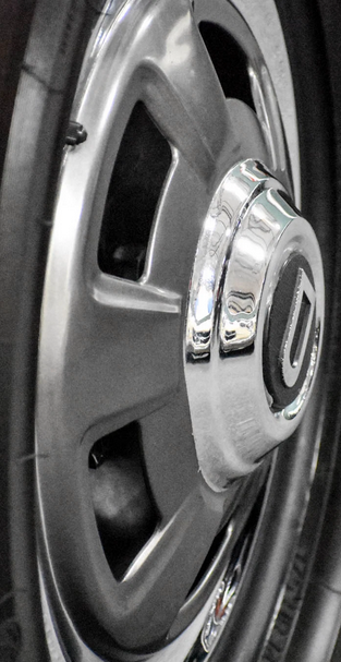

Real on right (Thanks @kats)
Left is badly painted or fake; too much chrome showing.
Are those both from the video?  In the video the front passenger cap is not the same as the rear.  Actually, maybe just the right front is "real", by your comment.
Nit nit nit...  Such fun.
I agree.. who knows.... for only 30k there has been a lot of things lost or poorly replaced.
What's more interesting about what you're showing is "how did they get on this car?".  The fakes/repro's probably weren't available in 1981.  The car went in in 1981 then came out and went to Malamut "Museum" in 2002.  And, apparently, is still there, Wob seems to be selling the car for Malamut.  There is no real seller after Malamut, it's all Malamut.  Wob is his agent.  And Wob says he has known the car since "Day 1".
So, one of those two parties must have added something to the car that went into storage in 1981.  People are right to be suspicious, some things are not 100% transparent here.
