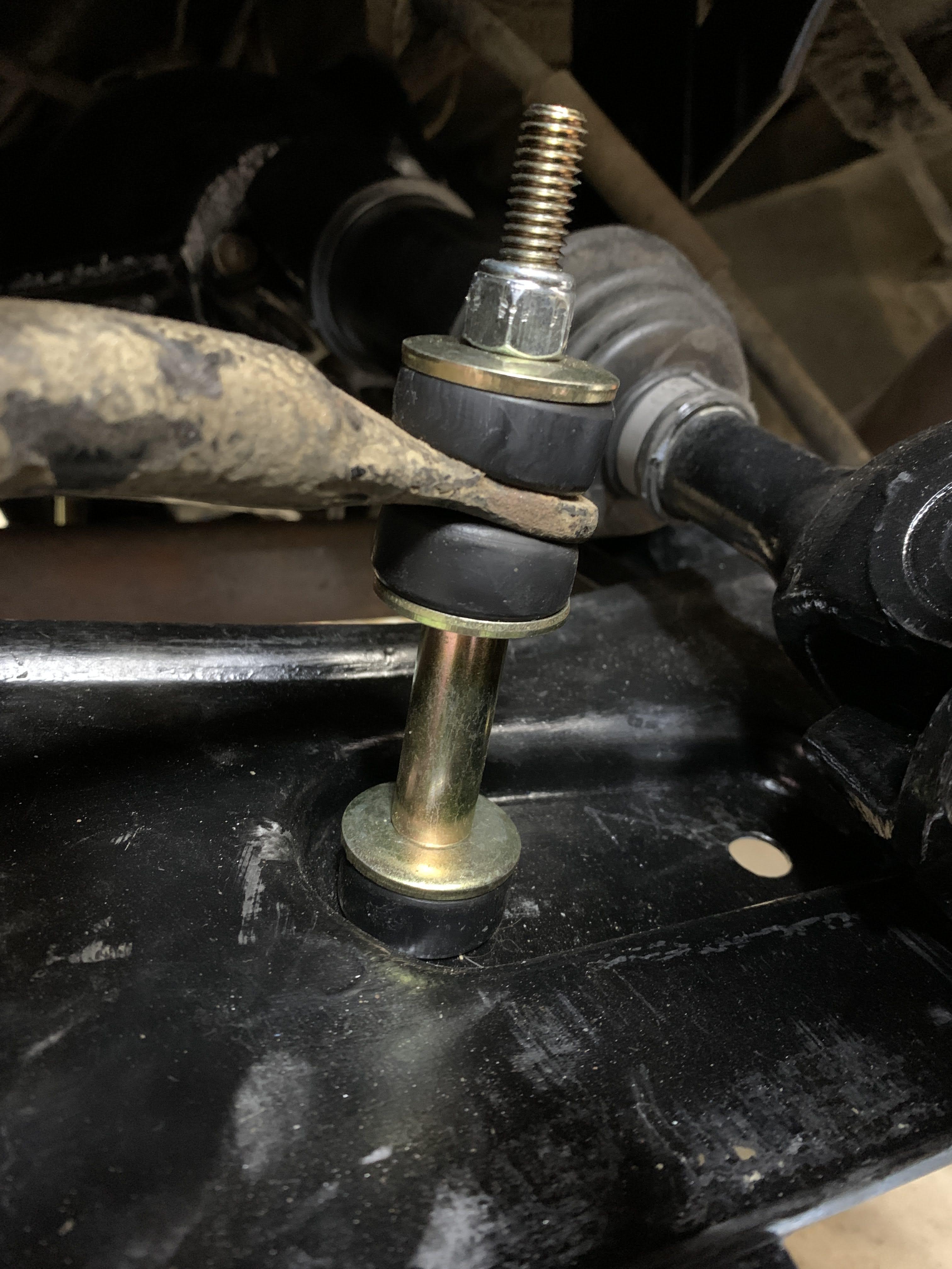

Interesting. I’ve never seen a metal sleeve that fits inside the ID of the bushings. Just the ones that set the spacing between the two bushing stacks. Stock end links that I’ve cut off, or any of the after market ones I’ve bought since have never had one. What you get is in the picture below.
I totally agree there SHOULD be a sleeve to set the bushing compression, that would eliminate the guesswork of how much to tighten them, but that’s not the usual reality of what you have to work with.
Tighten enough so bushings are compressed so that no metal to metal contact is possible and the bushings can still compress enough in use during travel. If your sway bar hole or hole in the control arm is all ovalized out, they weren’t tight enough.
Edited by zKars

 I tightened the nut until the rubbers started to bulge slightly.
I bulge the rubber just slightly more than the diameter of the steel washer. Always seems to work out well.
  • 2 weeks later...
It looks ok. That is about what I did on mine.
Did you use another longer bolt or shorten the spacer tube? My bolts were just long enough and I needed a block of wood to compress the rubbers to start the thread.
