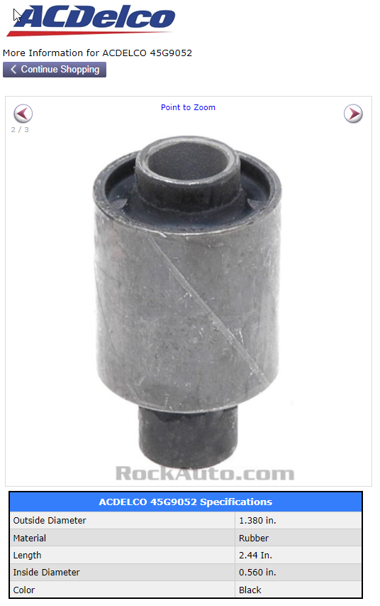

Did a bit of measuring this morning. Front control arm bushings are the right diameter, 35mm OD. and could be pressed into service (sorry). Not exactly the right dimensions but....
They have a 14mm hole rather than the required 10mm hole. The stick out of the two ends of the center tube is too much on on side and not enough on the other, but since you'd have to have a 10/14 bushing made anyway, you could make it the right length, just has to spot welded in place.  Over all body length is a bit short, but depending on where you position it in the body of the mount tube, you could put
Anyway, there is a way to make these work and get stock rubber in the trans mount. Actually a bit stiffer perhaps, the stock bushing doesn't fill the entire volume with rubber (looks about half), there are some voids, where as the front control arm bushing has solid rubber.
And Rockauto shows an aftermarket source from ACDelco for $6.72 CAD!!! A small fortune. About 17 cents USD
Edited by zKars
