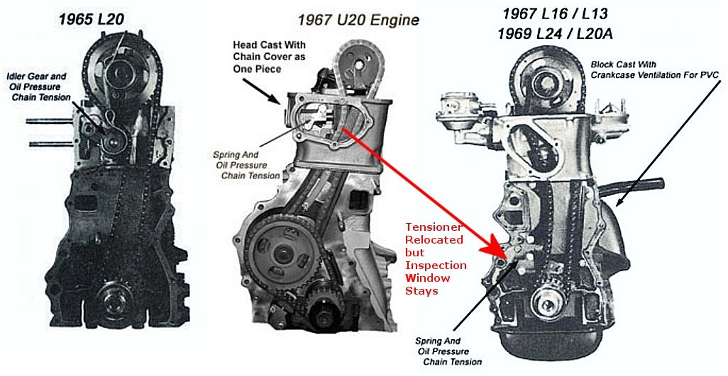

Kameari makes a pretty cool adjustable tensioner.  https://www.thezstore.com/page/TZS/PROD/10-5452
You can see the evolution of the tensioner position on Nissan engines. Thanks to @Carl Beck here: http://zhome.com/History/LSeries/LSeriesR1.htm
The inspection plate on the top seems like the tensioner was going to be placed behind it but it was later moved lower.
