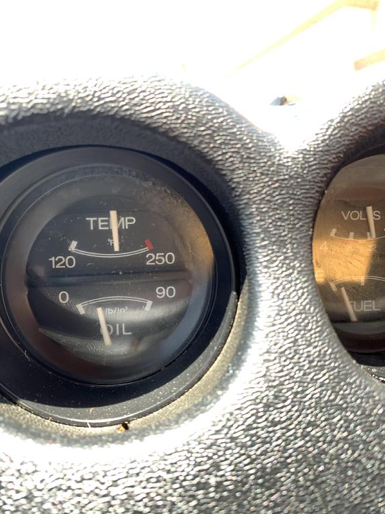

I did a coolant flush a few weeks back. I noticed that the coolant temperature gauge fluctuates between in the middle to slightly pass it. I checked underneath the car and no leaks. Fan clutch has no issues either. The Z doesn’t seem to be running badly.
i was wondering if i didn’t burp all the air out. It seem to sit right in the middle before I did the coolant flush. I relaxed the coolant with predilluted Peak coolant. What could be wrong?

If you are running a 180 degree thermostat, your temp gauge pic is spot on - not indicating overheating.  The gauge needle should swing a bit every so often as the thermostat cycles to admit cooler water and then closes.

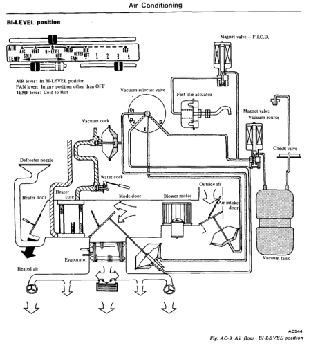

The other reason for cold air is a loss of vacuum at the AC control bottle.  Pretty common.  Split hoses.  The vacuum woter cack (water ****) is normally closed.
18 hours ago, BayAreaZ650 said:
The heater temperature was at max hot but only cold air came out from the vents.
The heated air will NOT come out of the vents. That is not how the system is designed. @Captain Obvious and I have had lengthy discussions on possible improvements.
The three positions of the control panel will be Bi-level, heat and def in order to get heated air from the system.
The two places that the heated air will exit is at the heater flaps or the defrost tubes.
Did you check the operation of the heat with the mode AS heat or defrost?

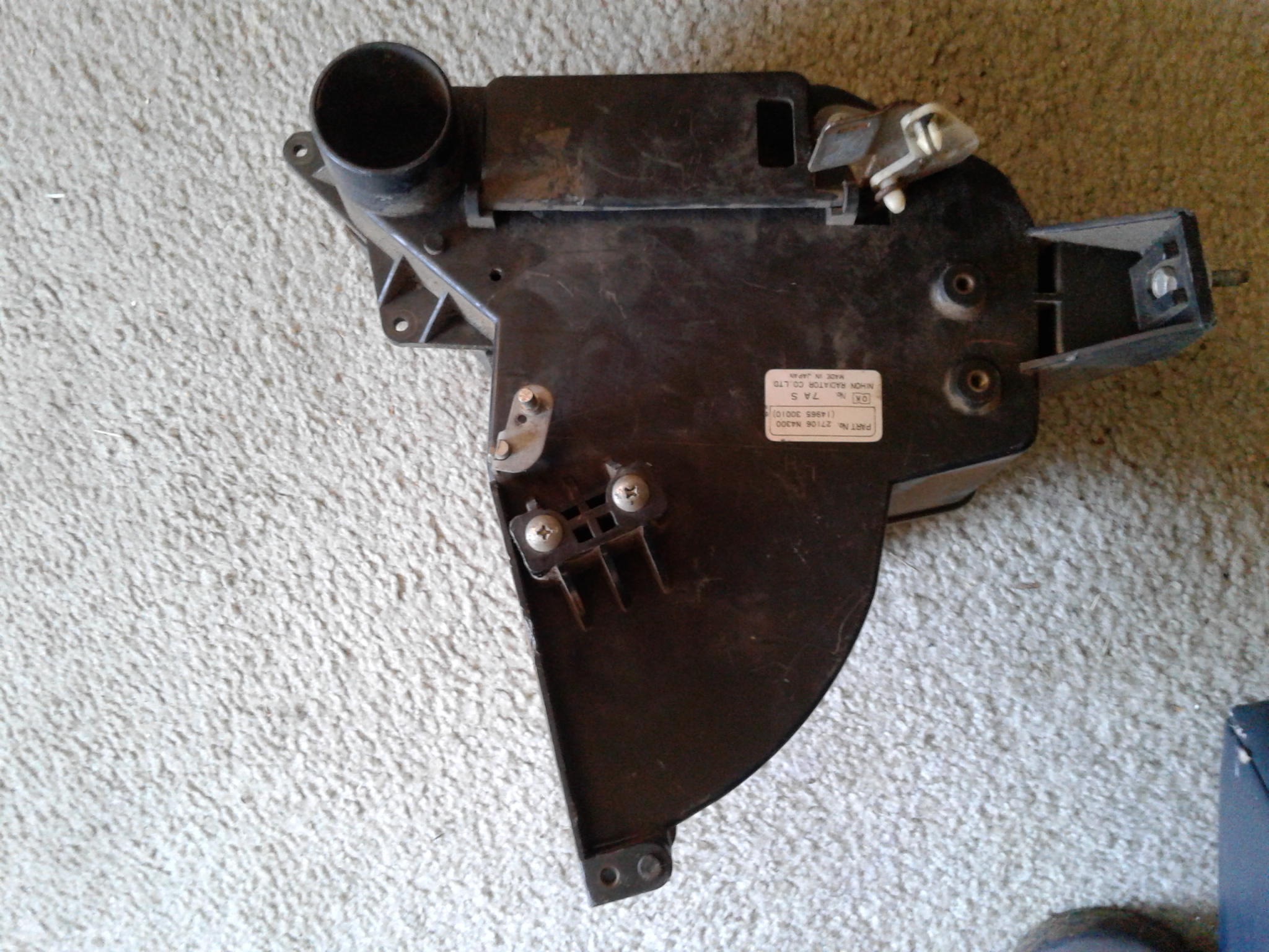

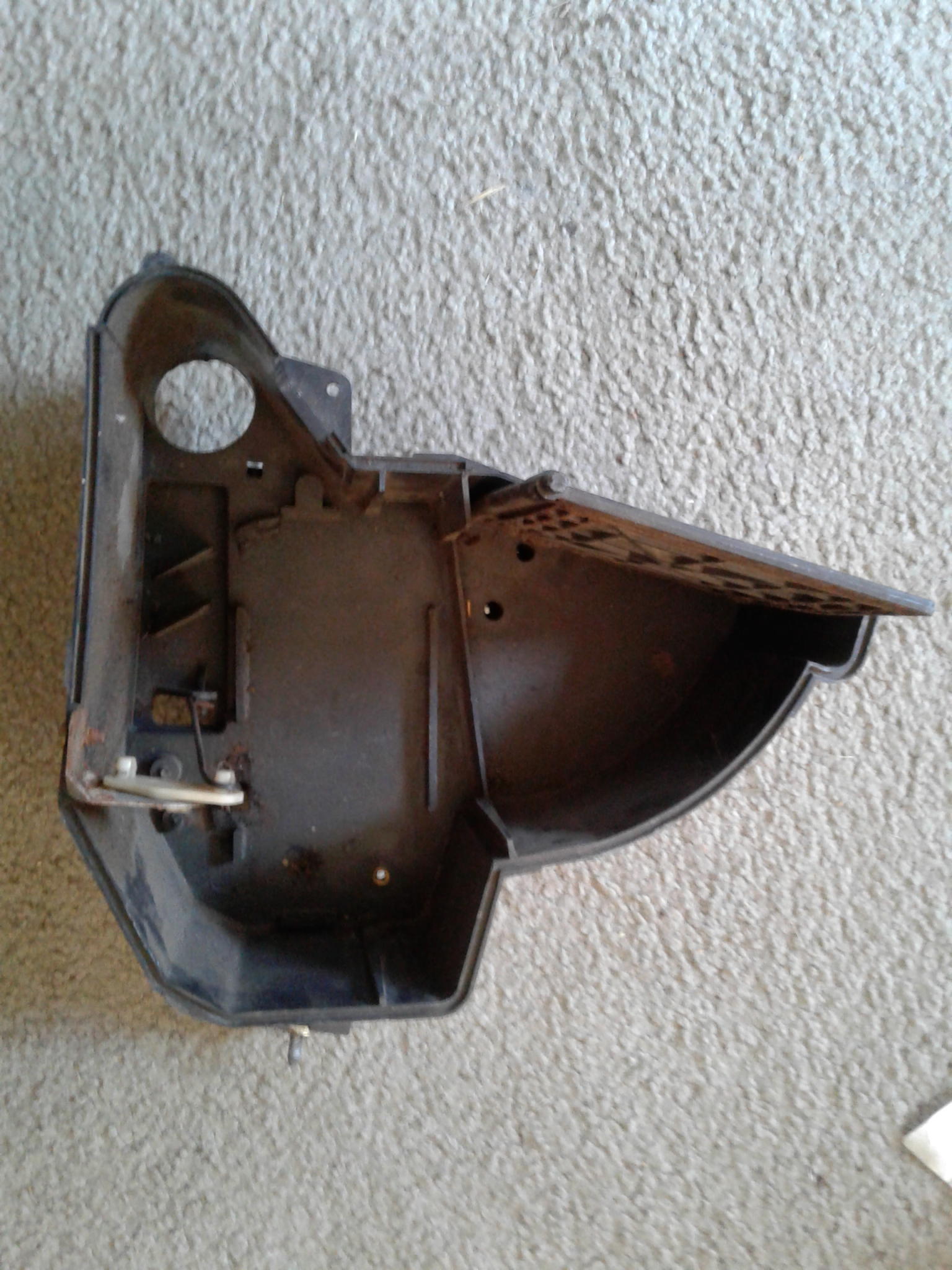

Attached are two pictures - One is showing the outside of the heater case that shows the SMALL flap the heat will come out of, the defroster tube, and about midway up, is the mode door flap that controls if the air from the fan passes through the vents or the heater door.
Second picture shows the inside of the case. The mode door could be lacking insulation allowing air to leak to the vents, or as @Mark Maras, @grannyknot and @Zed Head have eluded to, the heater control valve, cables or vacuum system (if factory AC equipped) is malfunctioning.

Thank you guys for all your help! The temperature still goes past halfway but drop back to halfway within 30 seconds.
That's thermostat opening, not sure you have a problem. Get or borrow an infrared temp guns and see what the actual temp is.
