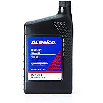

Is this what you are recommending
72 body and block, everything else 71, Tokico springs, Illumina, R180 CLSD, 83 close ratio, 3.90 gears, Ztherapy SUs, BRE 15X7 Libre wheels and BRE front spoiler.
Yessiree!

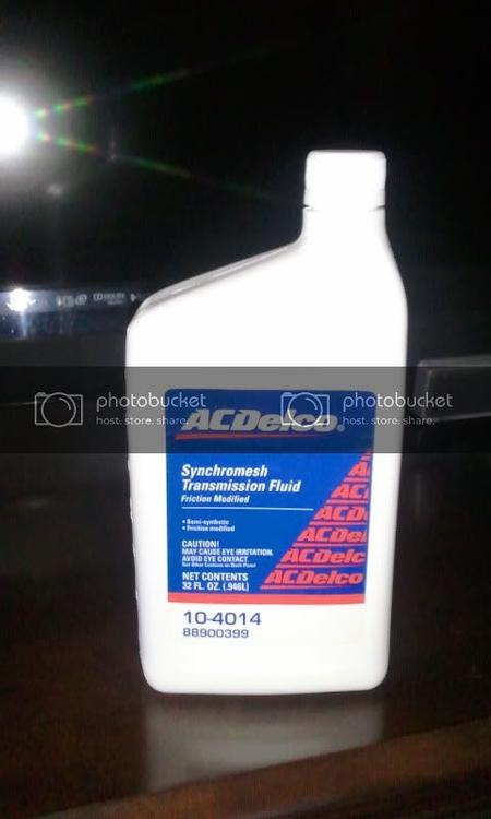

I mean---
whoa-wait a minute---that isn't Friction Modified!
You ought to be able to get A/C Delco Friction Modified transmission fluid from any GM dealer.
