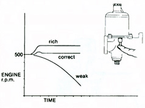

Had a visit this morning from our very good friend @240260280z.  He was in town this week for business meetings and came by before his return flight home.  He took me through the process to adjust and balance my SU's - much happier carbs now! :love:  Quite a nice tech session for the morning.

The one thing that Jim's car did that I never ever witnessed before is the 1/64" carb piston lift rod trick check for a/f at idle.  It must have been the Z Therapy excellent restoration (no leaky bushings) and the fact that everything in Texas is in great repair and done right!  One of my fav states!

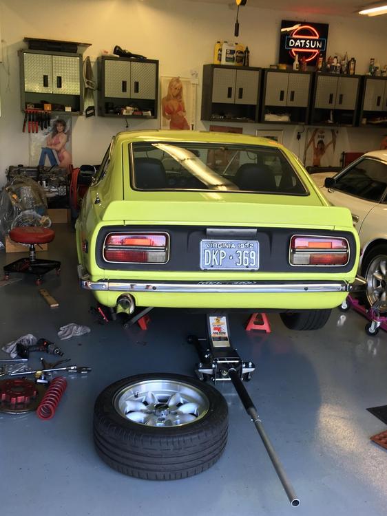

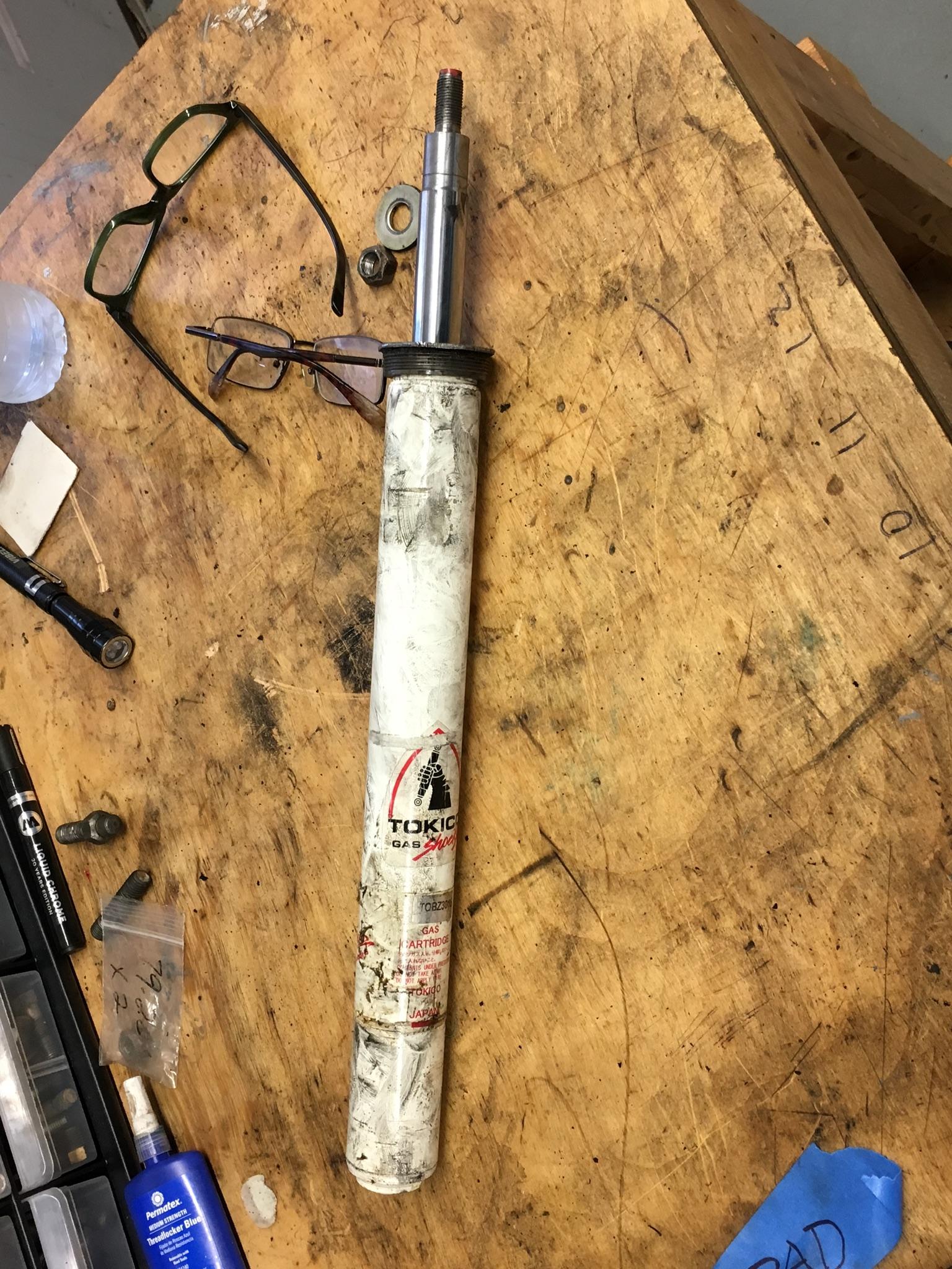

Pulled a blown shock out of my driver side rear coilover. Guess I’ll have to go back with Konis unless someone knows a Tokico source.
How old are they? Any idea of cause?
38 minutes ago, Diseazd said:
No idea why it was blown. I would guess no more than 5000 miles.
That was my suspicion on the mileage being low. That's what made it seem odd to me that it needed replacement. Had it been bottomed out at any time?
I don’t recall bottoming out at any time. May be just a bad seal or something. The only way I found out, there was a rattling sound coming from the strut at low speeds. I’ve never blown a strut before, at least not that I knew of......I’ll replace both rears with Konis....don’t think Tokicos are available anywhere.

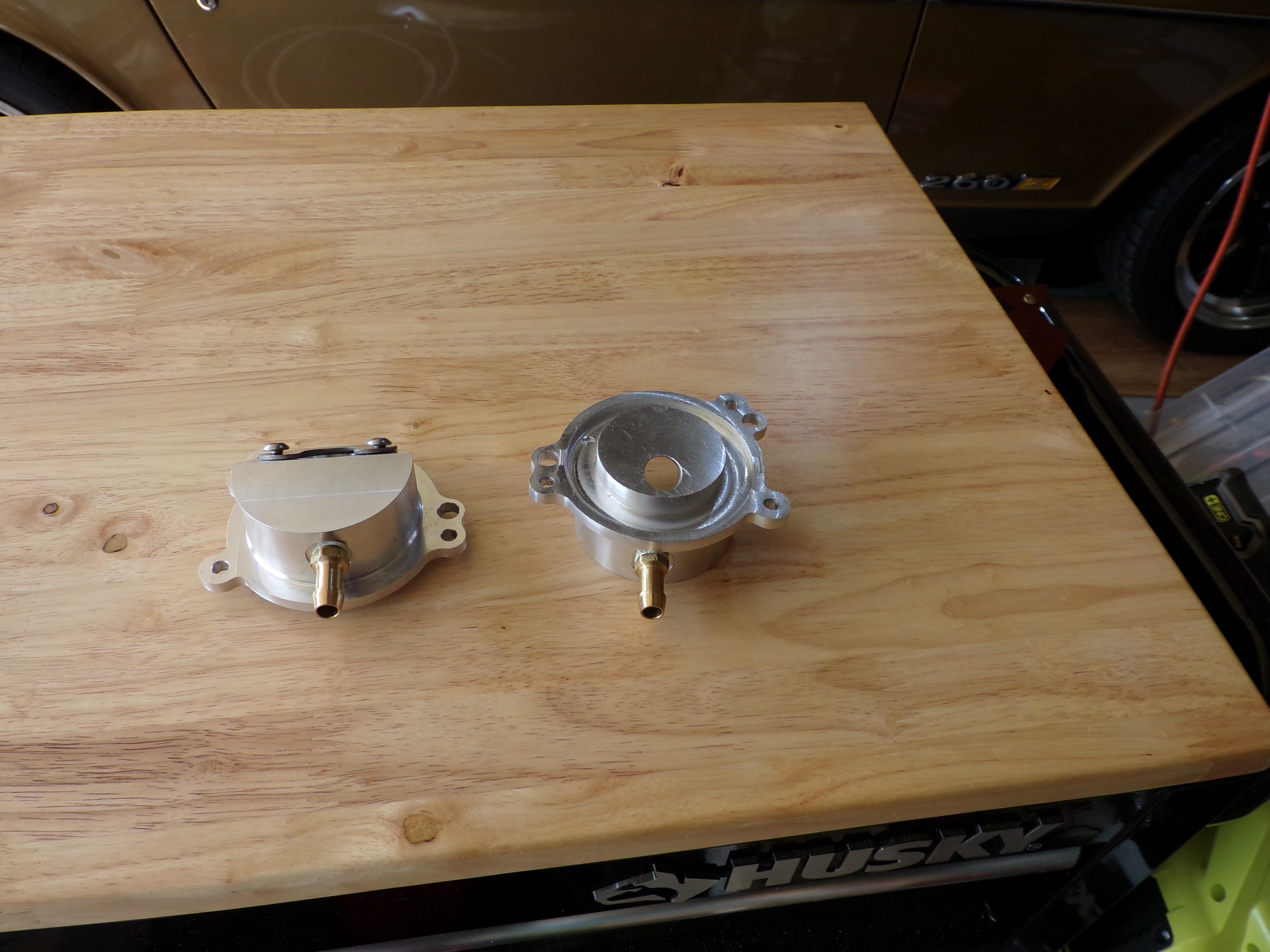

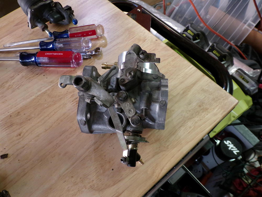

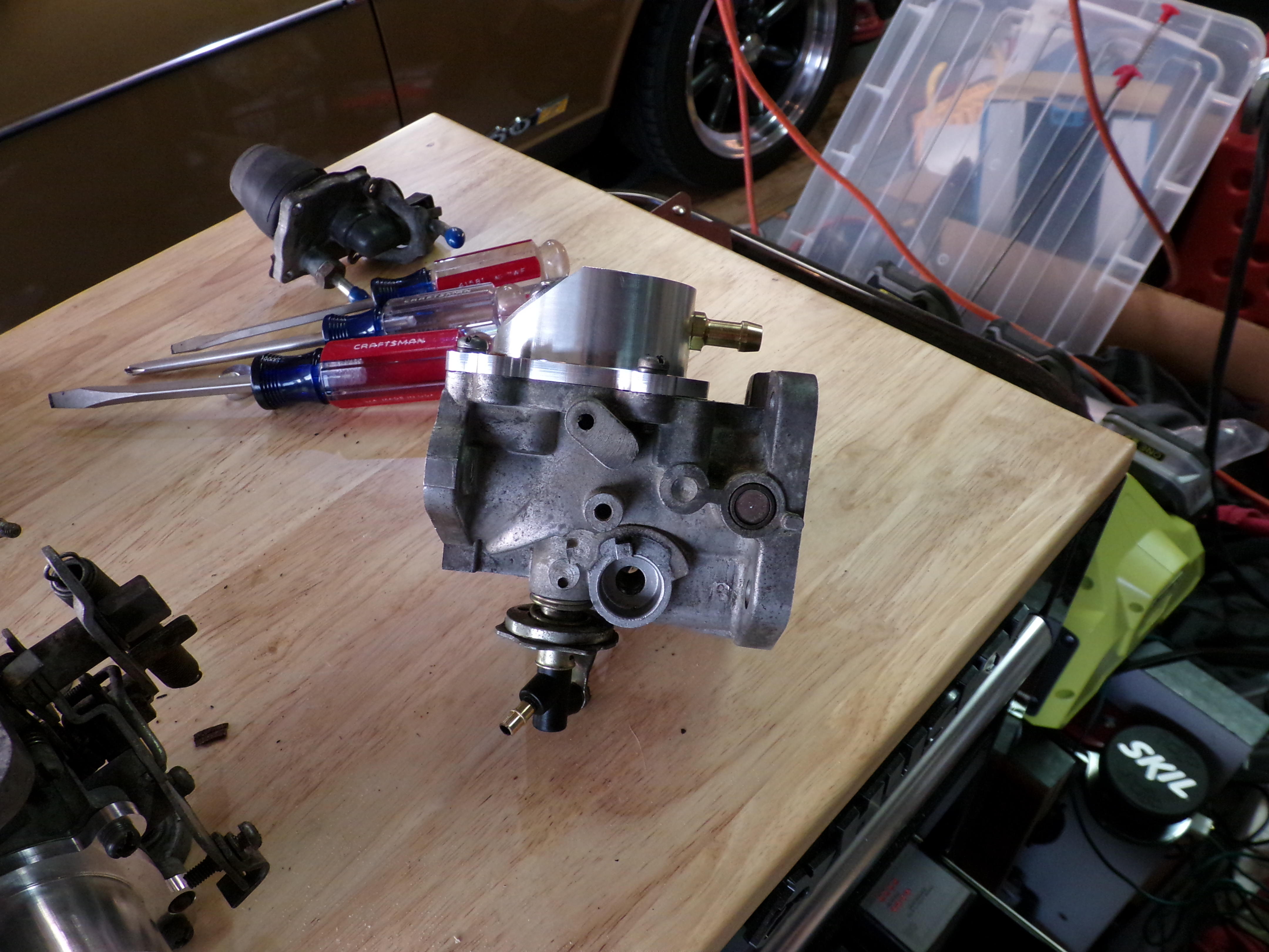

I'm taking the week off from work, so I started on the fuel injection conversion for the 260Z. I'm taking it slow at first. Today was just getting the carburetors fitted with the fuel injector adapter platesGEDC0705.JPGGEDC0736.JPGGEDC0737.JPGGEDC0738.JPG.
Best of luck with your FI project Steve!    Watching with much interest....
