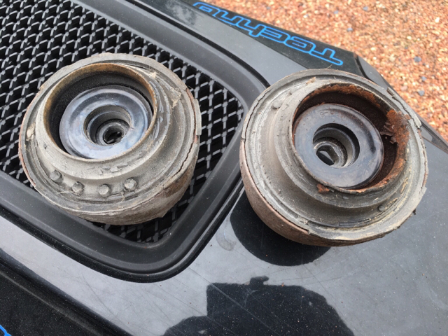

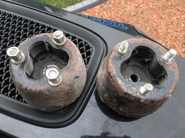

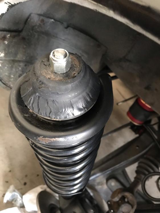

Went out to my car that is on jack stands this morning and the rear brake was hanging really low.. upon further inspection .. anyone seen this before
I am sure I have one for you...

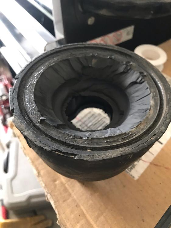

Yes, that exact same thing happened to me. My car had been on jackstands for a while, and one day I noticed one of the struts hanging lower. That's what it was.
I suspect many of us have this problem, or are about to have it. What causes deterioration of this rubber part? Heat? Well not engine or exhaust levels, just ambient exposure based on where you live.  UV exposure? Nope, pretty dark up in there. Mechanical stress? That thing is in compression a huge amount of the time and under tension almost never. So what's left?  Front ones might be prone to some twist and eventual tear if your steering bearings up at the top in there are seized so you are turning the rubber. I think it's just time that eventually lets whatever environmental factors that eat rubber to finally weaken it to the point of failure.  A bunch of my joints are getting prett creaky after 61 years too..
When I got my coil overs done, the company I bought them from insisted I send them my insulators so they could 'modify' them to work with their upper mounts. Turns out they only drilled the D hole out a bit and cut away some extra rubber around the edges, but what got me was, I didn't get the ones I sent back. I marked them. And shortly two of them failed just like this while hanging around in the shop on jack stands. Enough whining today....

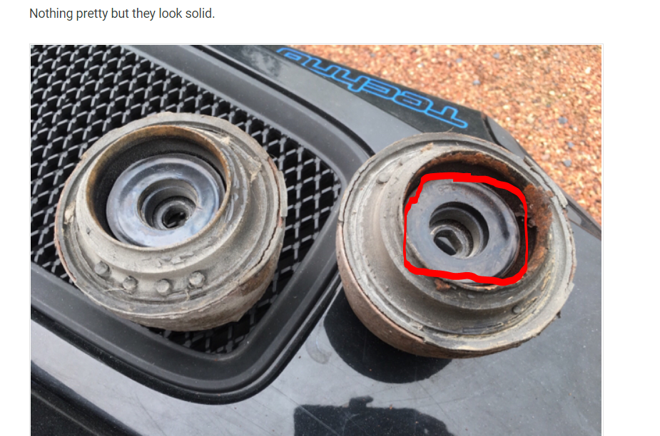

These rubber pieces peel out and can be replaced.  Might actually be under what I circled, those look bigger.  Courtesy Nissan had the parts a few years ago.  They'll give an extra 1/4" of lift.  I think it's why old Z's tend to be tail droopy.
