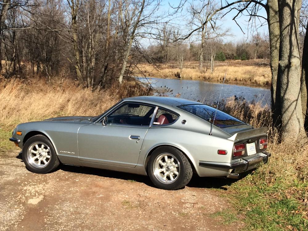

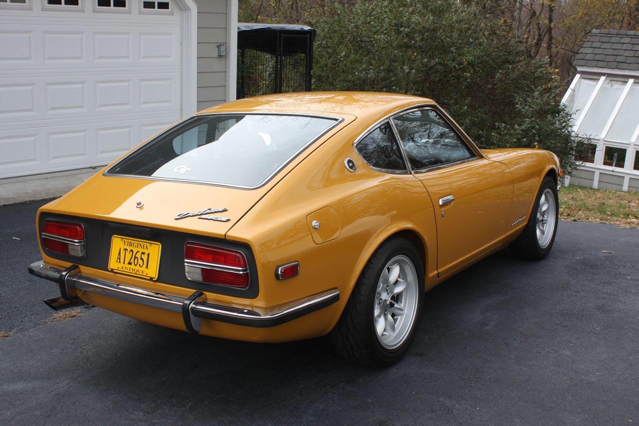

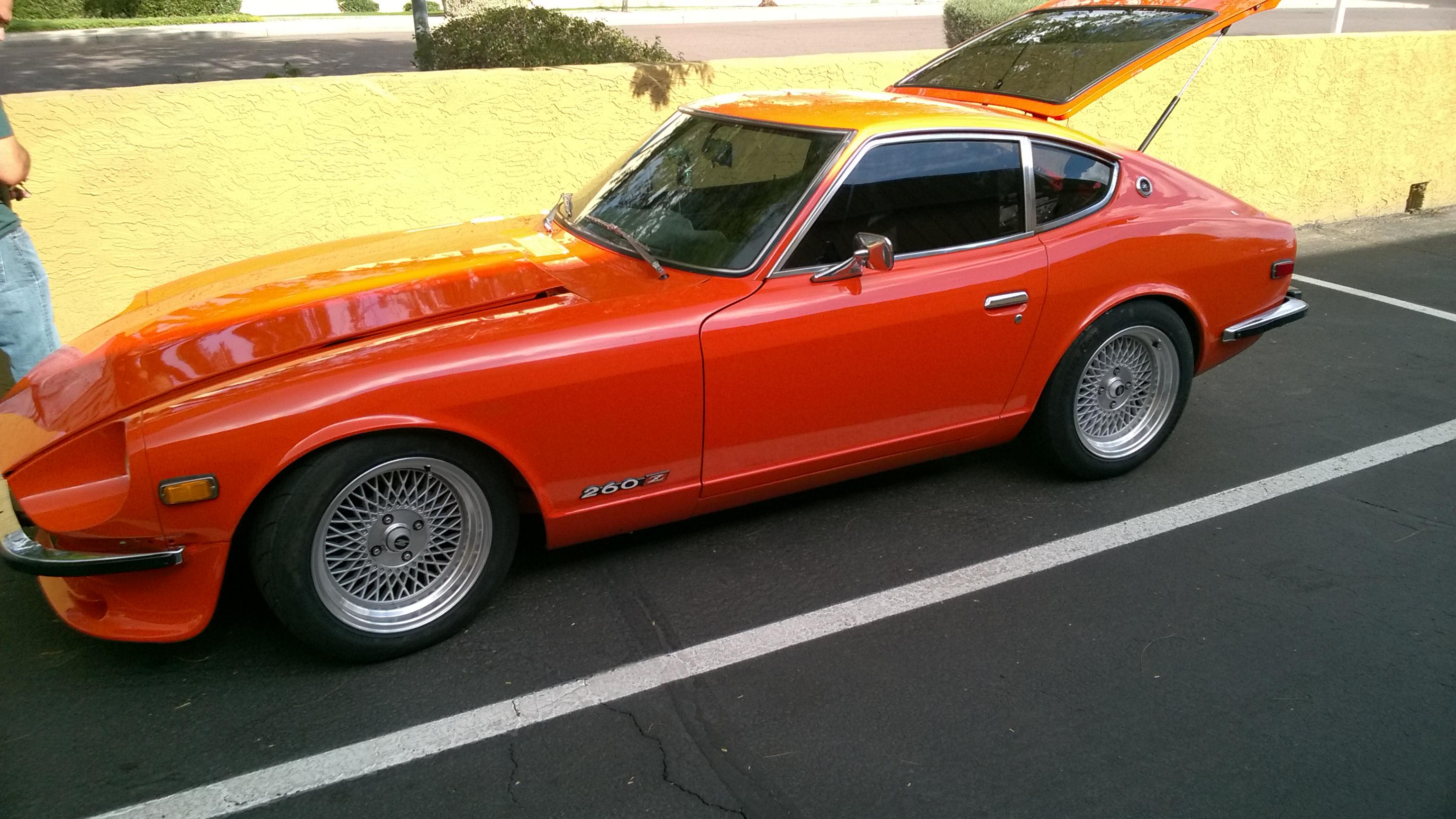

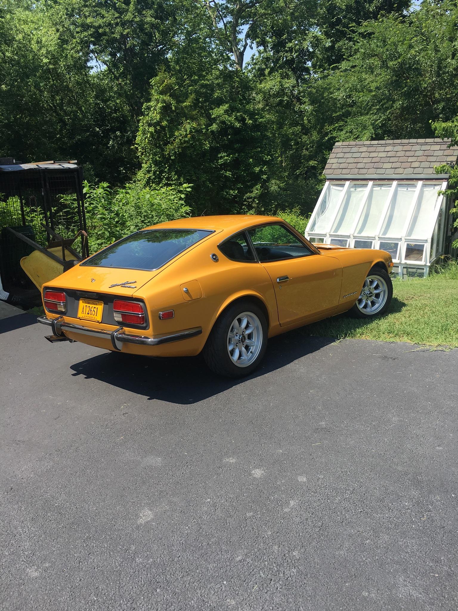

I went through this myself last year, the body should not disappear but it is often filled over when the fender lips are replaced or repaired. I don't  have a photo handy but it should be clearly seen above the rear fender lip.
Thanks for the pics and input.  It looks to be less prominent then elsewhere but still there above the rear arch and gone from the front arch.  Hopefully my body guy can get it right.
I have two cars.  One has a manufacture date of 6/70 and the other 5/71. Both cars have their factory rear quarters.  The lines do not end on either car but the lines on the 6/70 are much more pronounced than 5/71.  Its almost as if the tooling needed to be sharpened by the time May '71 came around.
I would certainly call it "less prominent" on the '71.
