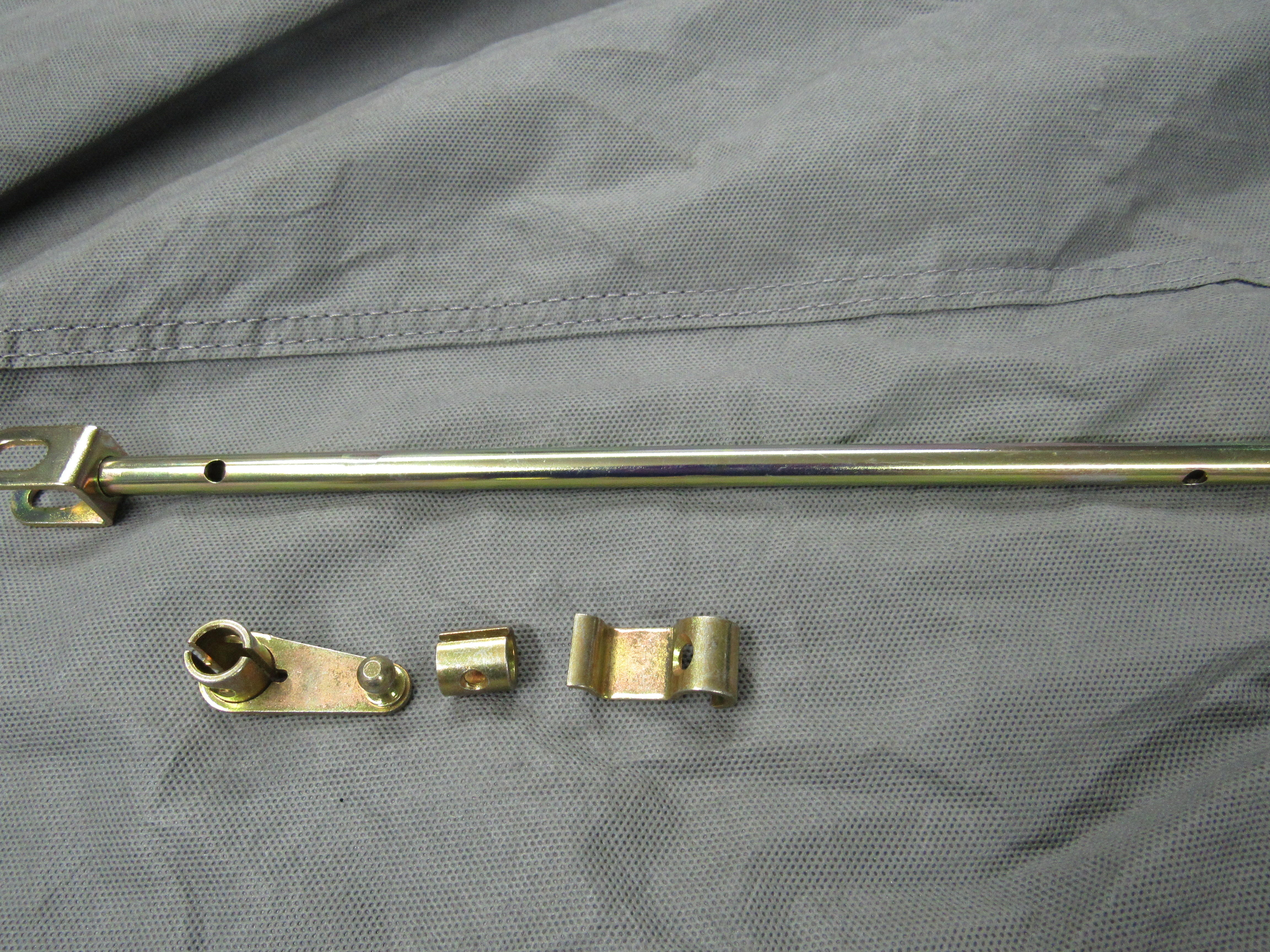

Yes, on all the showy/visible parts I cleaned, wire wheeled and buffed them, also I asked him to wire hang those showy parts rather than barrel plate them, so he had to charge me a bit more. All the nuts, bolts and common stuff was barrel plated.

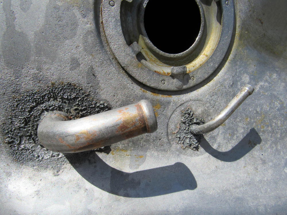

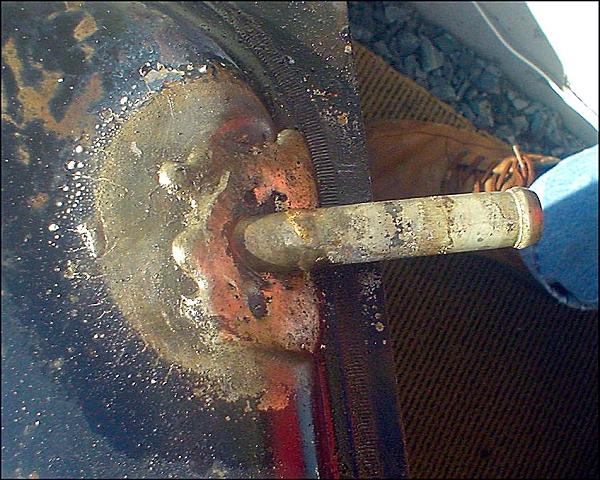

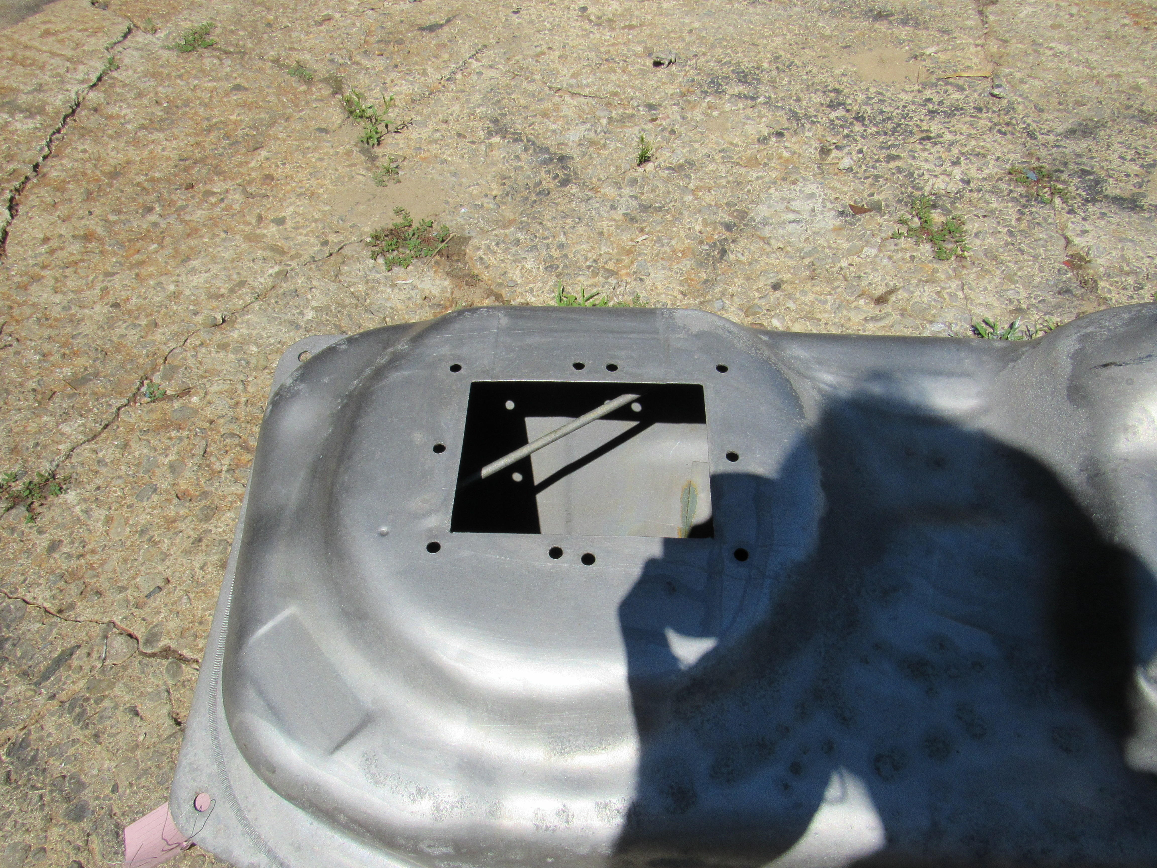

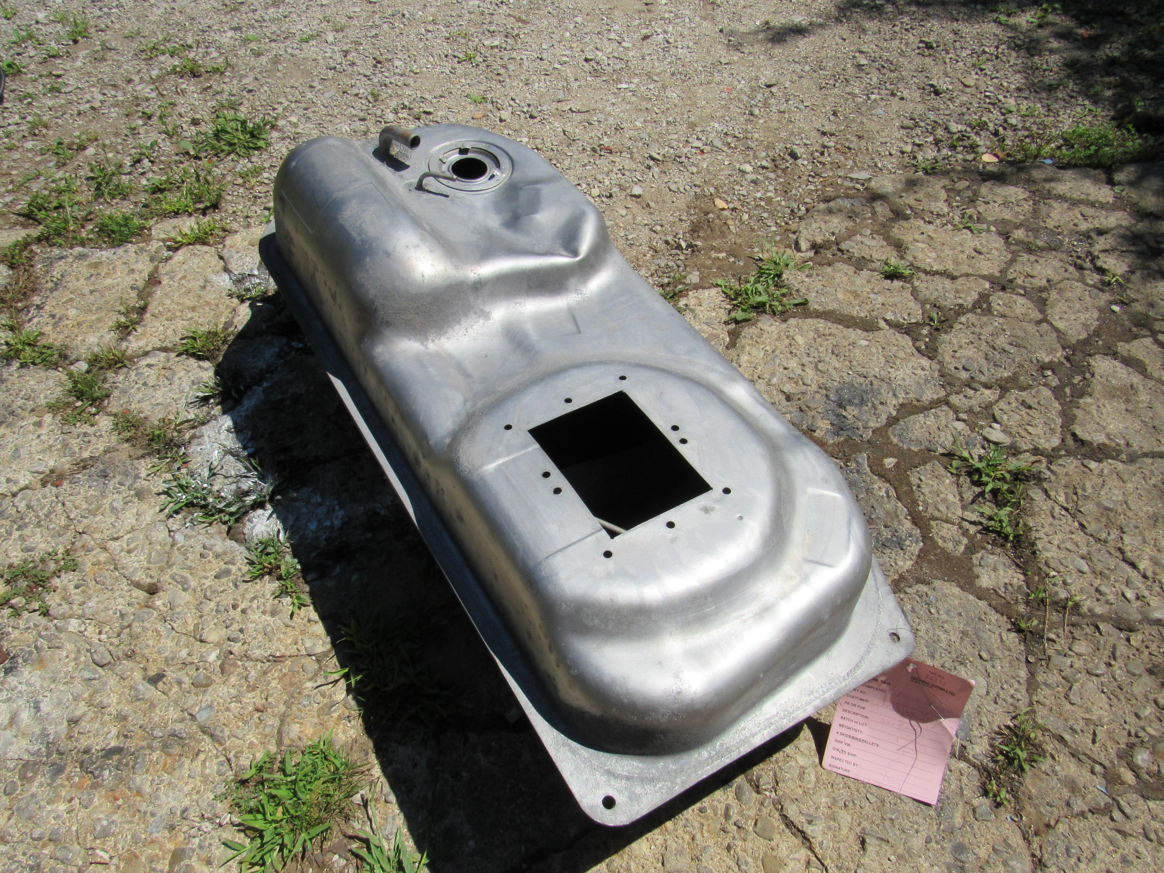

I picked up the gas tank from the acid dippers today, in addition to the rust it had a layer of Red Kote, so I took the easy expensive route.  One thing about having your car or tank dipped, there is something about the process that turns lead solder to liquid, I don't know if it is the heat or the chemicals  but I have noticed twice now a pool of hardened solder beneath a joint that had been smoothly soldered.
You can see how rough the solder is after dipping, so make sure you save a bit of your tank sealer so you can apply it to the outside as well around those soldered joints. Also got the pedal box disassembled, cleaned and painted.
