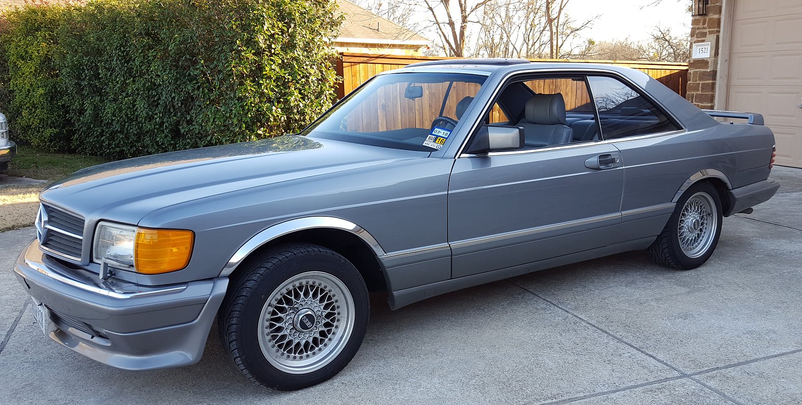

February 8, 20187 yr Author comment_541786 I don't think the 560's V8 is the engine the Datsun L motors were based on. I believe it was an older motor design. The engine in my 560 SEC is an all aluminum 5.55L SOHC V8. I have only driven the Benz 62 miles as that was the drive home when I bought it. I knew it needed a timing chain as I could hear it "whirring" at idle so it has been driven some what delicately. I have been gathering parts from various vendors and plan to get most of it done this weekend, barring any surprises or disasters. Organization, planning, and cleanliness is key on these engines. Link to comment https://www.classiczcars.com/forums/topic/59469-spark-plug-compression-gearing-and-power-feedback/?&page=4#findComment-541786 Share on other sites More sharing options...
