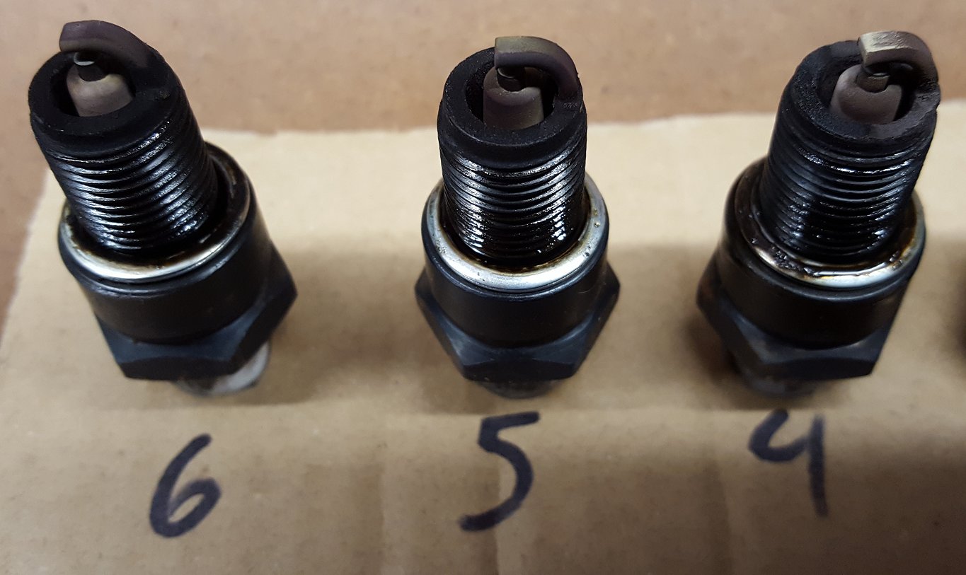

I have been gathering some baseline info in an effort to find out why my 240z feels to be lacking power.  It runs good, idles smooth, but just does not have any "plant you in the seat power" in any gear.  Below are the specs along with some pictures of the spark plugs I pulled.  I have not checked the timing and I know how important it is, just didn't want to put the used plugs back in to do so as I plan to install some new ones.

Triple Dellorto DHLA40 carbs, rebuilt, and appear to running a bit rich based on the plugs

Is it me or do the plugs look oily, especially near the washers?
They look really oily.
Hardway, you burning thru oil faster than normal?
I knew I would get some good questions and feedback!  Yes, the threads are oily as the valve cover gasket is weak.  The whole passenger side of the engine is grimy.  A new gasket is going on as well as cleaning up the engine some.  I don't know about oil burn as I have not driven the car enough to tell.  The oil level has not changed since I did it in September and that has been with a few 40 mile round trips to cars and coffee at 80mph and there is no smoke of any kind based on my personal experience and those that have driven behind me.
