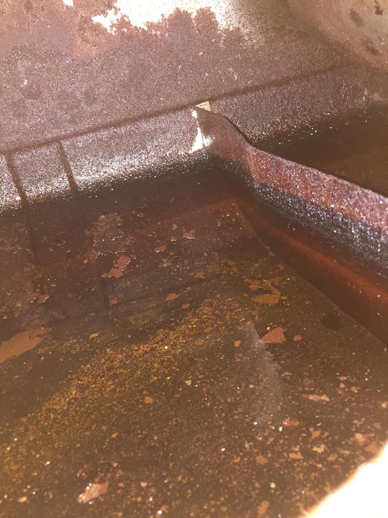

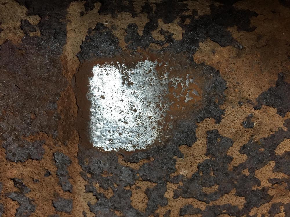

As a further demonstration of the advanced rust, the gas tank may be the most glaring example.
Most sad is the rarity of this tank with it's lack of the top/front and far left vent lines associated with the Canadian no-evap equipment. (Yes, UN, no UA, thanks Dan!).
I do not believe this tank to be salvagable. While it does not leak at all at any seam or through any rust perforation, there is nearly 50% loss of surface metal on the outside. The tank contained about 5 litres of incredibly smelly old fuel.
I did remove the sending unit. O-ring was intact, but the mechanism was totally rust locked.
Inside the belly of the beast.
Here I've ground away the surface rust to expost some remaining bare steel to show just how deep it goes.

2 hours ago, wheee! said:
I wonder if that tank couldn’t be saved with an internal coating and a thick coat of silver por on the outside. The high metal content version. Then a bond coat of primer and a final black coat.
I considered that. I'm sure the outside can be blasted, the inside cleaned, and massive money can be pored into coatings inside and out. Worth it? Not sure. Removing two vents from an otherwise good condition later tank seems like a better usage of time and funds. Or is that sacrilegious?
