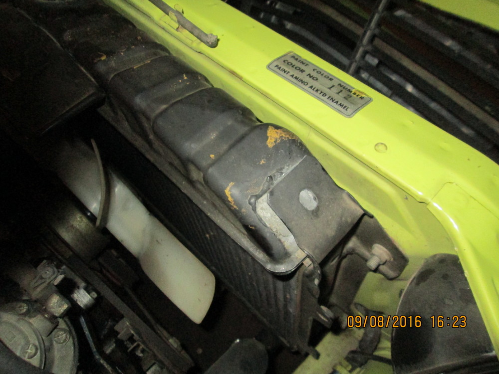

Get you a 280 3 row for $100. Sits 2" lower than the 240 radiator so you have to be more careful but it'll cool a lot better. You can also add a full shroud on the 280 radiator for even better air flow.

Yes, just pull the radiator out and take it to a radiator shop.  Normal maintenance and repair.  Don't butcher up your lovely car with a replacement 3-row with a shroud.  Or, JB Weld?  What on earth are you thinking?

Get that radiator professionally repaired, including a flush and pressure test while its at the shop - money well spent.  Have the shop pass on any quick paint job (if they still do that), then clean up the tanks and frame and give it a good coat or two of gloss enamel.

hmmm... My car's VIN is 5/70 and the tab that came unsoldered was the lower pssgr side.  I think that what we have here may be a process or material problem, rather than a worker problem.  Fortunately, the fix is easy.  And on the 'glass half-full' side of the equation, I can't think of too many other places on the 240Z where things just 'broke'.

My 2/72 build did the same thing at the exact same spot.
In my case the radiator had the core replaced as the origional was plugged up too bad to flush.
A while after I got it back this happened so it could have been done poorly at the radiator shop.
I took it back and they repaired it and never a problem after that. Over 20 years ago now.
Pull that radiator and have a shop fix it right. And have them also flush it and/or rod it out. And a good shop will also paint it up nice.  Glue or JB weld is not a legitimate fix. And siteunseen offers an excellent alternative. A 3 row and shroud is the best cooling solution. Radiators with shrouds work much better.
