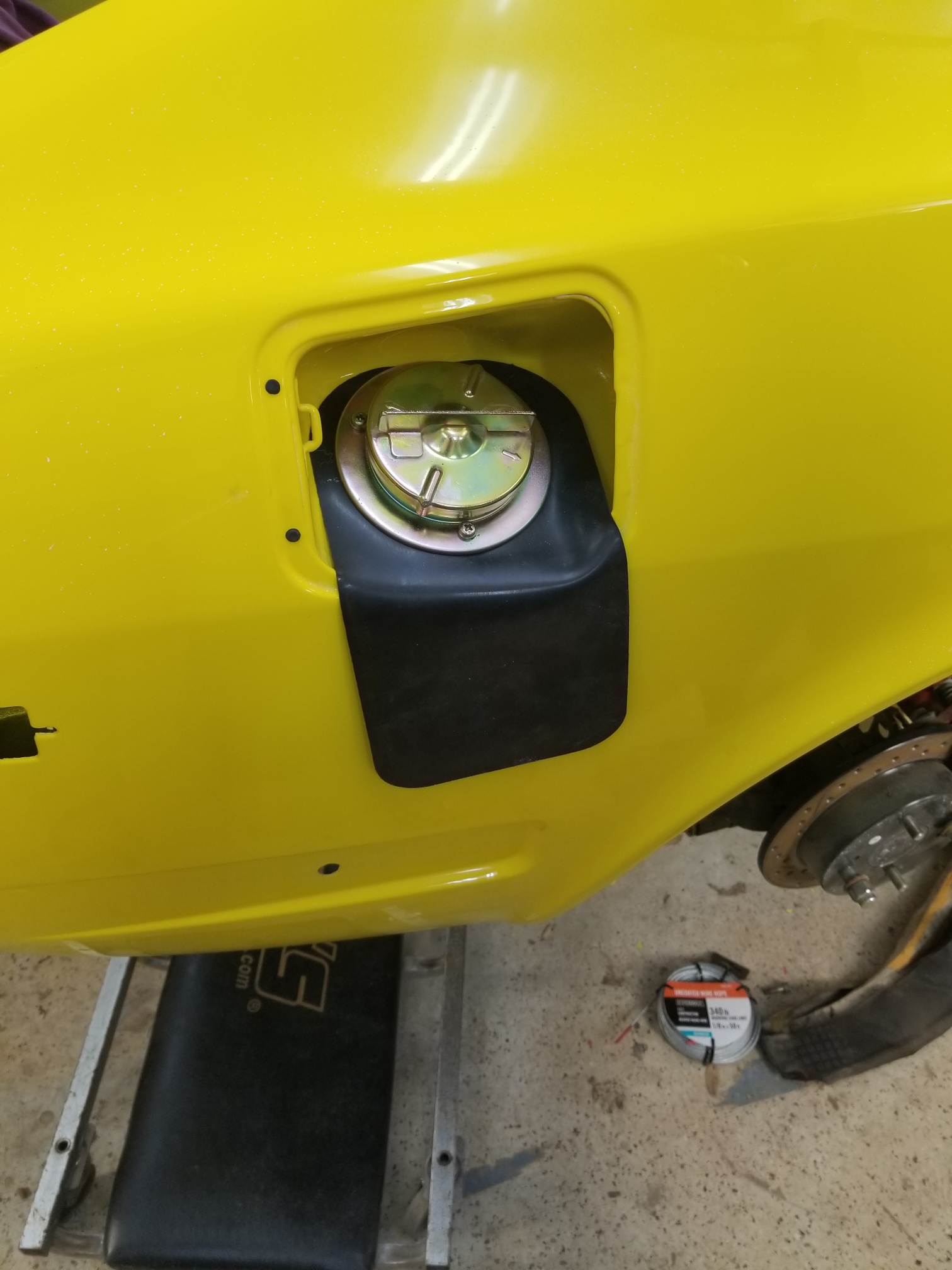

Installed the gas flap and ring today

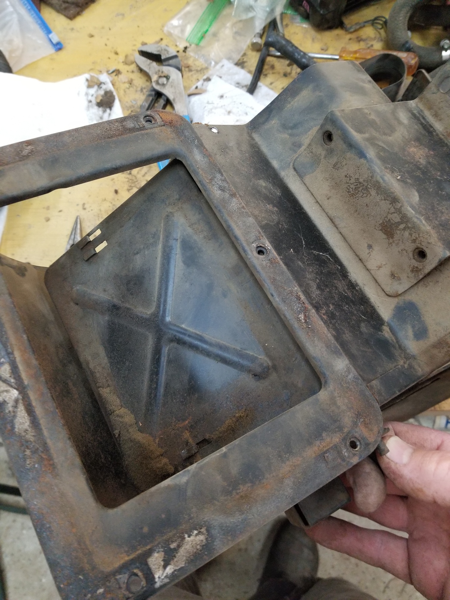

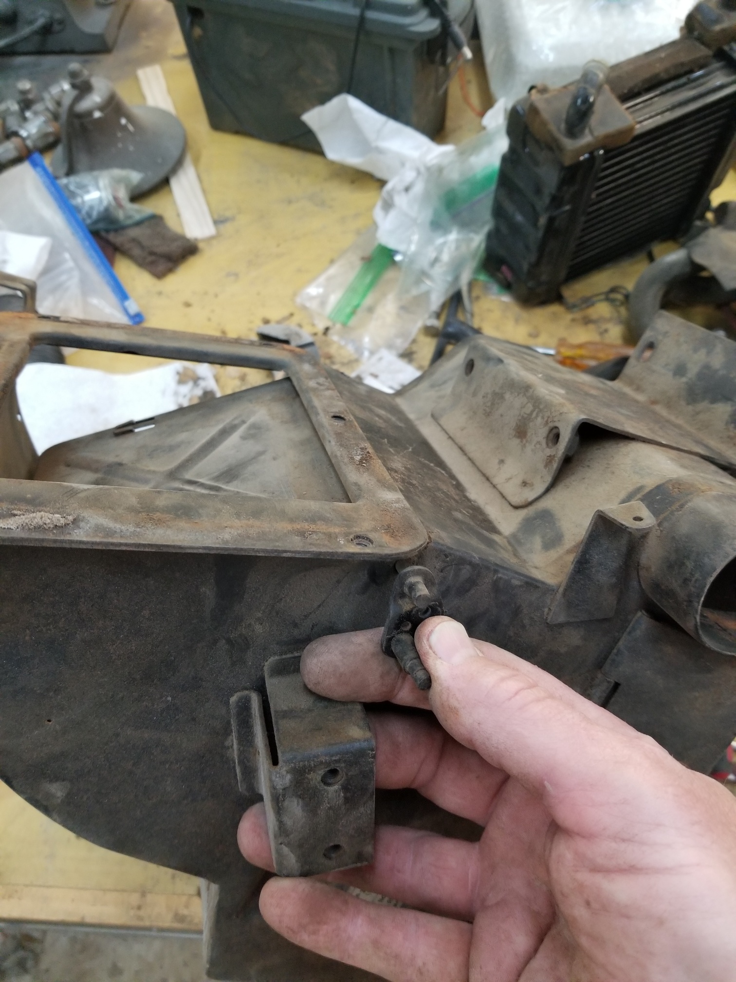

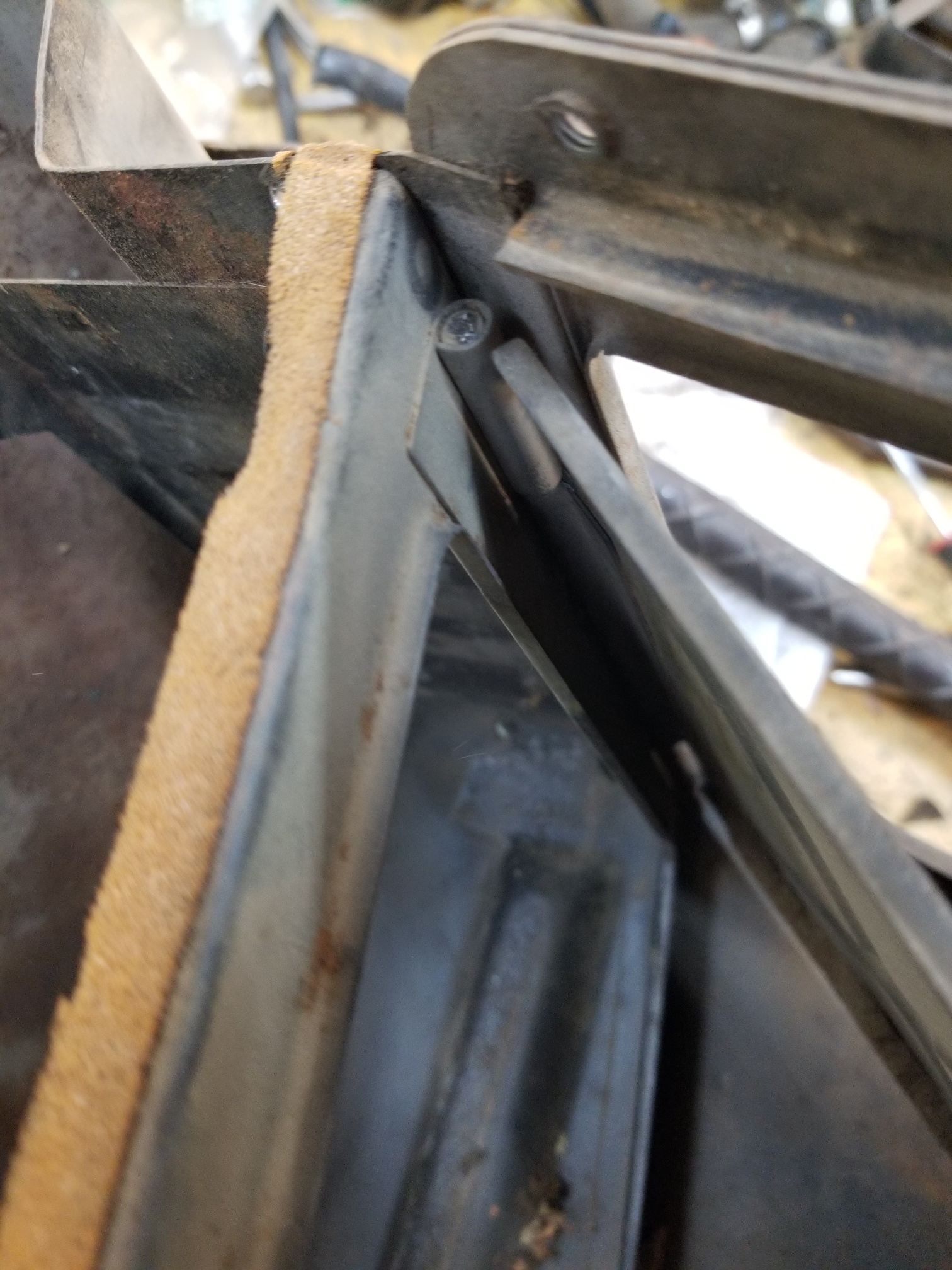

Also I was stripping down the heater box for freshening up
Do anyone know if I can get this flap out? I don't see anything retaining it but it seemed like it didn't want to come out. I would also like to two floor heat flaps out too but I don't know how to de-assemble those either.
When I re-built my heater box several years ago, I left all of these flaps in place.  After cleaning up the inner and outer surfaces of the plenum and flaps, I sprayed the inside with a rust-inhibitor paint and then the outsides with matte black.  I then cut replacement pieces of foam (adding an outside layer of soft vinyl for the pads destined for the big flap).  If you go to the 'Resources' section, I think that my full write-up is still there.  Also included at the time was a set of templates for all of the foam pieces (these were designed to be printed at 1:1 and then glued to the peel-off backing sheet of the foam).  If you can't find these docs, let me know and I'll re-post them.  It's finicky work, but doing it properly produces a heater/blower that works effectively and quietly.
