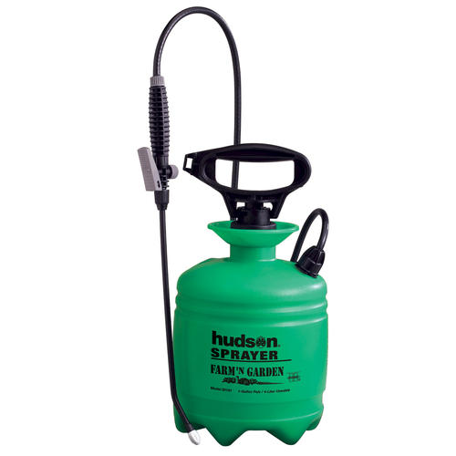

Super Clean with a designated water only garden sprayer.
Spray cleaner long enough to loosen grime then rinse with
the low pressure sprayer. With the long nozzle you can direct
rinse water exactly where you want it. No over spray.
