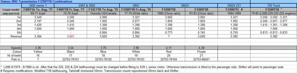

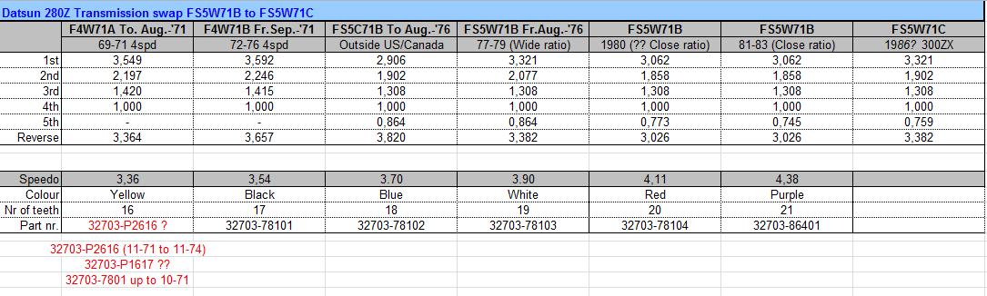

Short answer on the transmission would be: Close ratio 71B with a 3.7 or 3.9 transmission. There are a lot of variables, like highway use or just cruising around town which will influence your decision.
Im running a 82 280ZX 5 speed with a 3.7 diff from a 300ZX. The combi works well, but finding a close ratio 71B in good condition is getting harder. Another option is the 71C.
Here is a snap short of some data I have on the combinations. Based on my 280Z.
post-25317-0-46799000-1446483003_thumb.j
post-25317-0-66530200-1446483021_thumb.j
