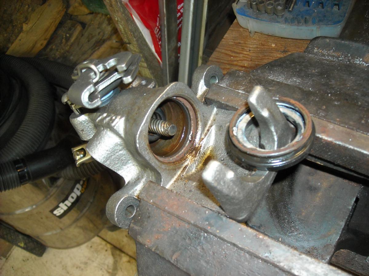

My new rebuilt 1988 Maxima rear calipers came in from Rockauto yesterday, they are going on the rear of the 240z.
They look great, all new bolts, seals. The first thing I do is start tearing them down, a friend who over at the time asked me what the heck I was doing.  I told him I always tear down rebuilt calipers because quite often there is crap inside or the pistons are too worn.
He slapped a $10 spot on the bench and said "I call BS, they will be perfect inside"
I'm $10 dollars richer.
I'm not saying anything bad about Rockauto, I love them. But I find this sort of thing in probably 75% of the calipers I buy from any auto parts store.

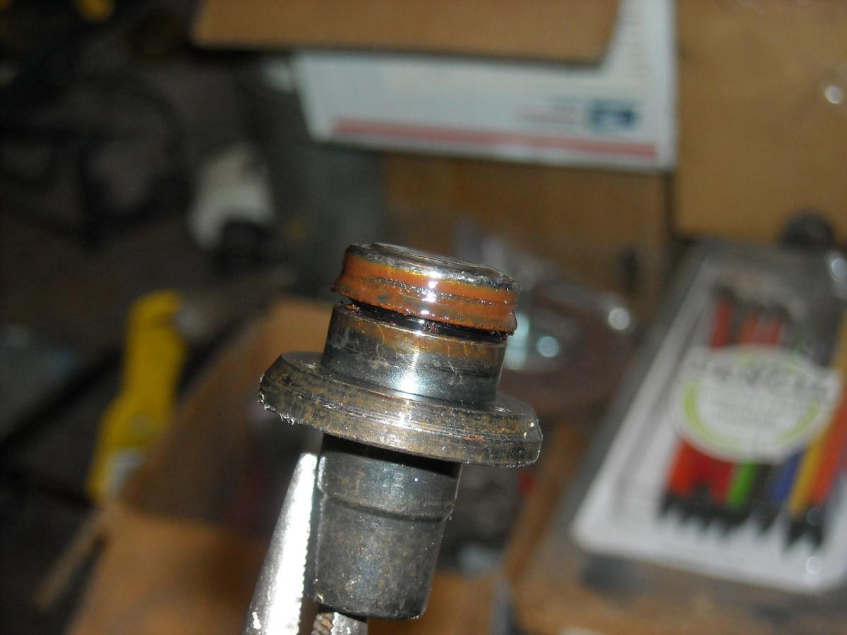

The seals were all new, as were the pistons, they just weren't properly cleaned before re-assembly.
Chris

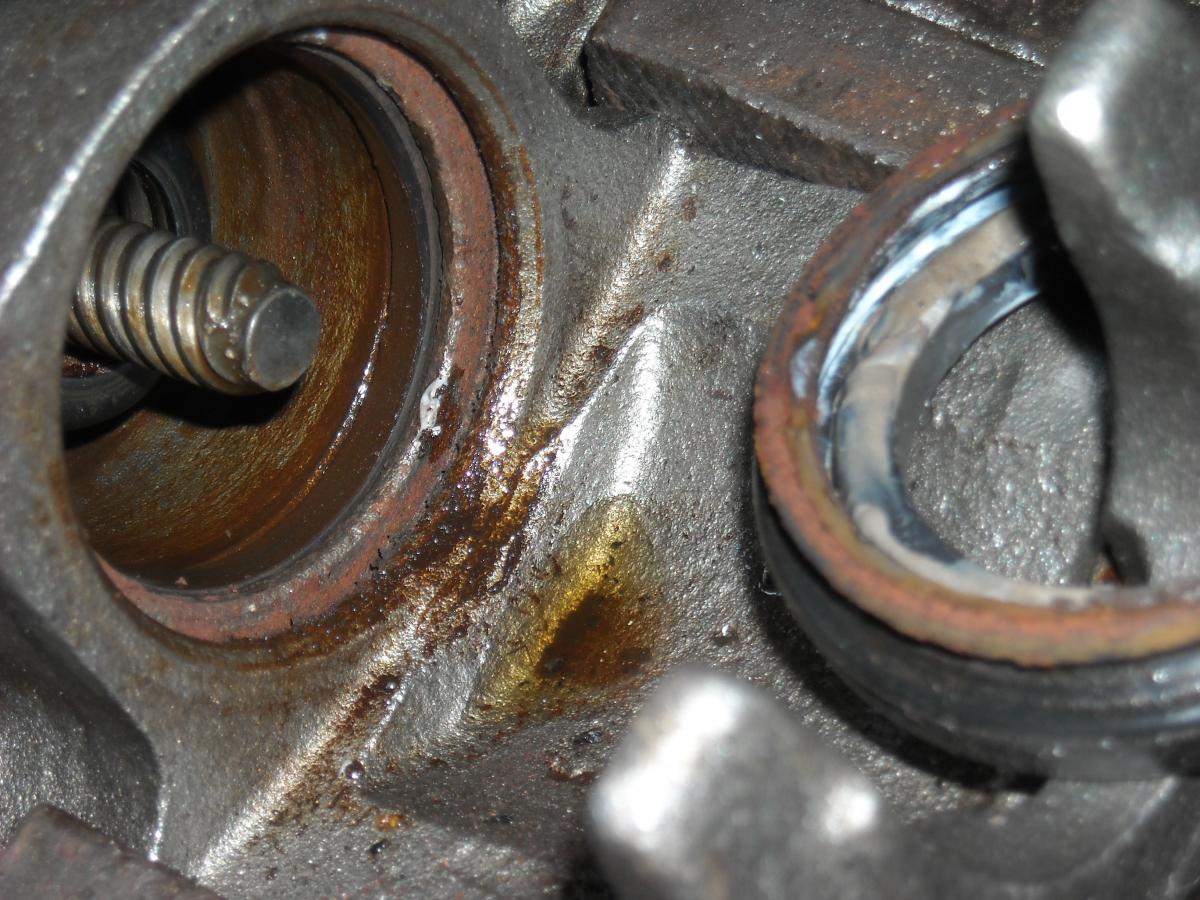

How did you go about cleaning them up? If I am looking at the picture right the cylinder bore looks pitted.
For this one I used Evaporust, the bore is pitted but it doesn't matter as the piston is supported by the center screw and the seal that sits above the bore surface.
I probably am too anal but just can't stand the thought of brand new seals getting scratched and torn by rust before I even install them on the car.

I can see why it's a wholesaler closeout and only has a 30 day warranty. That is terrible quality. The rust in the bores is totally unacceptable. I definitely would advise Rock Auto about this. They need the feedback so they don't purchase more parts from this particular Manufacturer.
