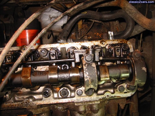

Have you checked out if it has a falling-apart cam oil spray bar? They are made of a series of tubes and cast blocks swaged together and can warp, if they warp bad enough the end tubes can collide with the cams or even fall all the way off.
