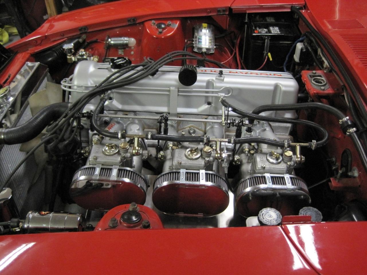

Hello Gents,
As the title states I am experiencing some issues during deceleration when coming to a stop using the gears. I can put the car in neutral and it stays running. But when I use the gears to help with the stop especially when coming in hot and fast the engine just wants to die. It always dips to 500 RPM and most of the time just stops running. It idles good, it runs good going thru the gears, sounds freaking awesome! but the damn stop.....
Been tuning the carbs for a few weeks and I think it is real close. Idles at 1000. Fuel PSI is 3.5. Fuel return line is capped. I barely have the 2-3K rpm stumble. I can tell it pulls very nice all the way to 5500 but that is as far as my butt is calibrated....anyway I think the cam tops out of 6400???
Timing set to 12 degrees at 1000 rpm and 34 degrees advance at 3000 rpm ( no creep when rpm increased to 4000)
I have read many Weber tuning manuals and haven't come across the "dies upon decel" troubleshooting steps. The carbs were good when they came out of a L24 and have been sitting for a few years. I cleaned them up like a rookie would and did a minor overhaul using the Peirce Manifold kit. Change the chokes and the idle and main jets per Peirce Manifold tech reps guidance.
I don't have a clue what my next step should be other than checking for some restrictions in the carbs.
Here is the specs of the engine:

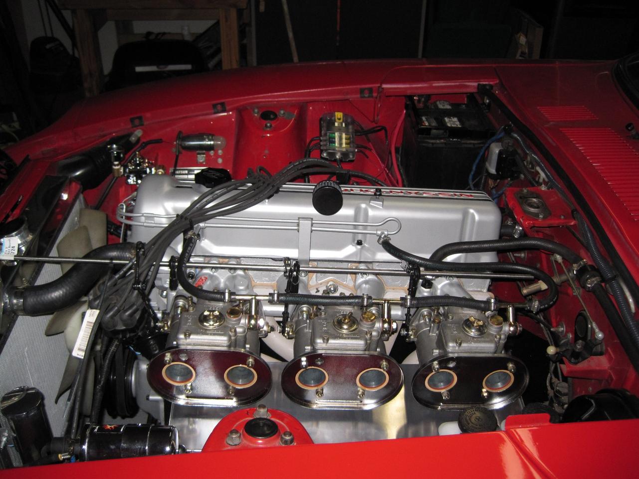

Edited by dawg7
wrong engine pic
