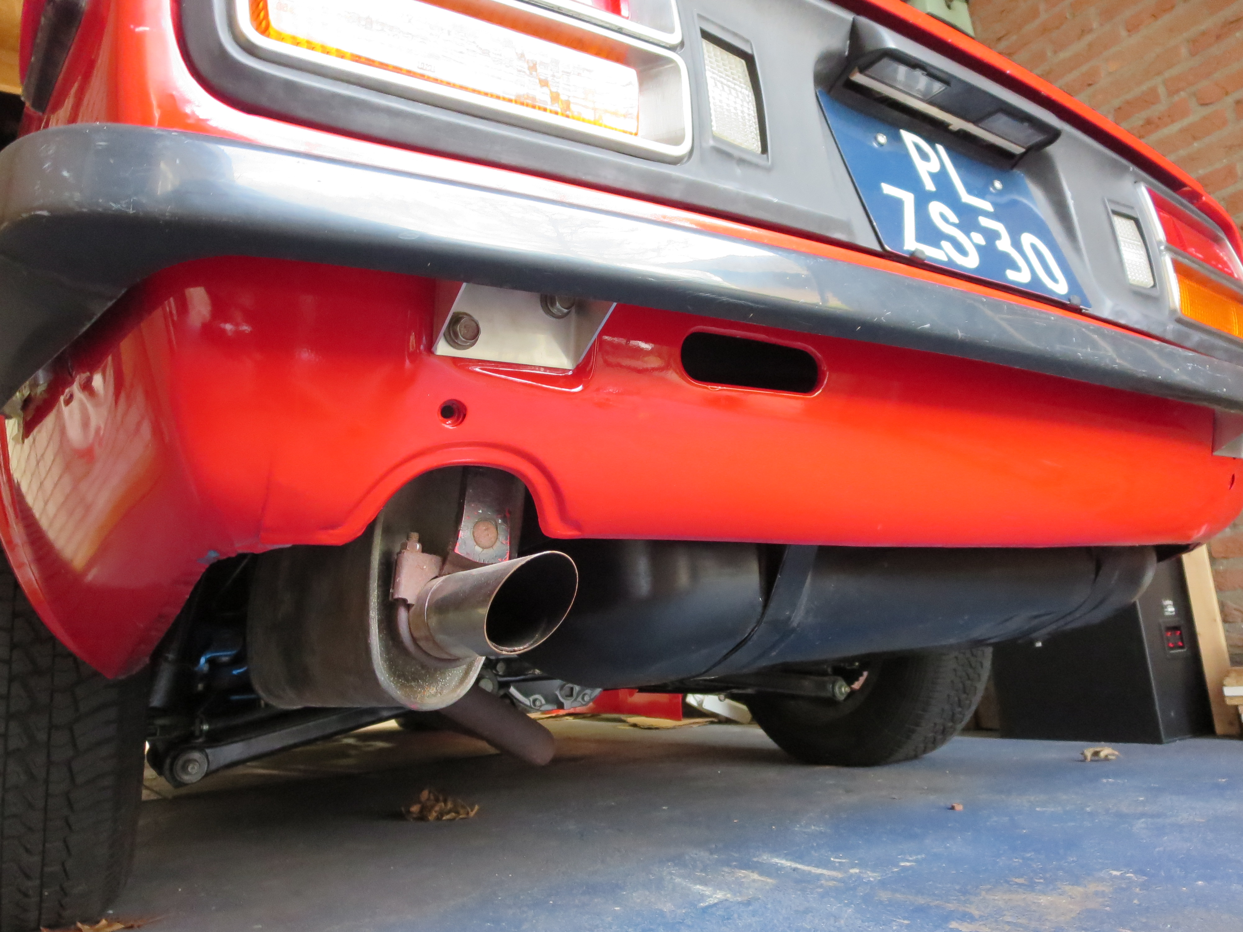

Count me in for a pair of rear brackets.  I'm getting tired of people asking if I'm going to put a rear bumper on.

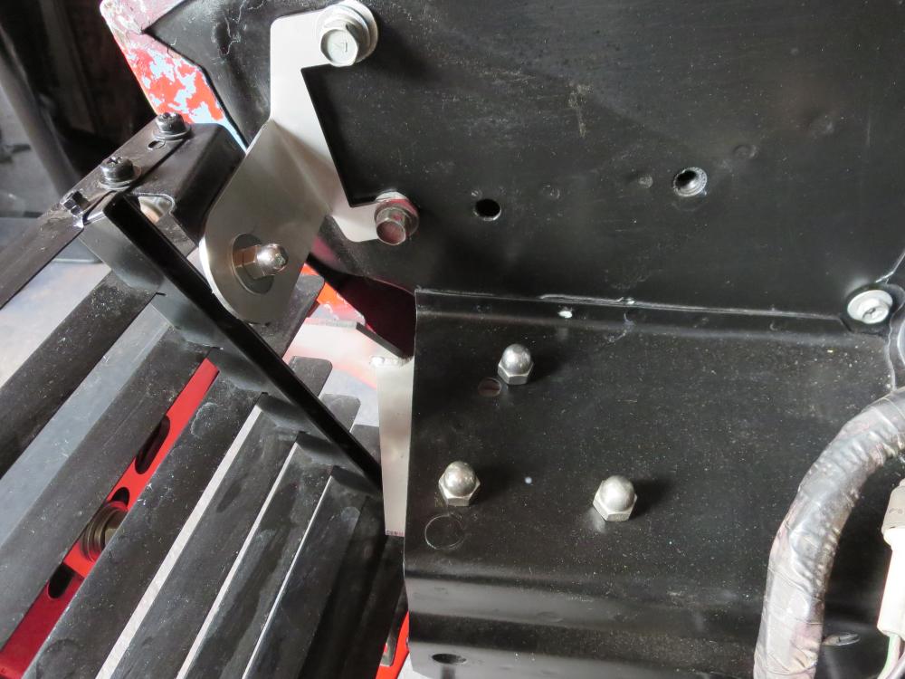

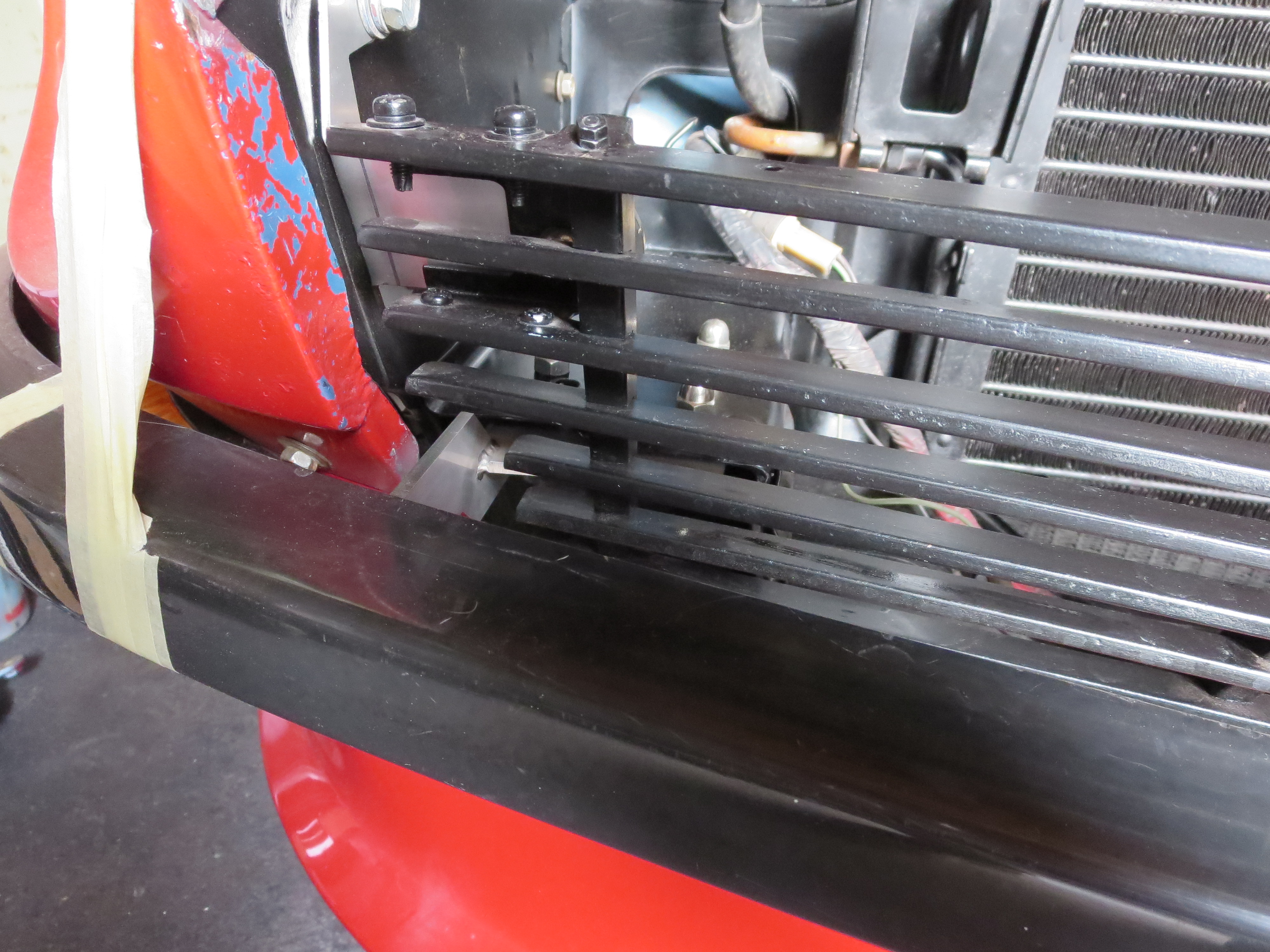

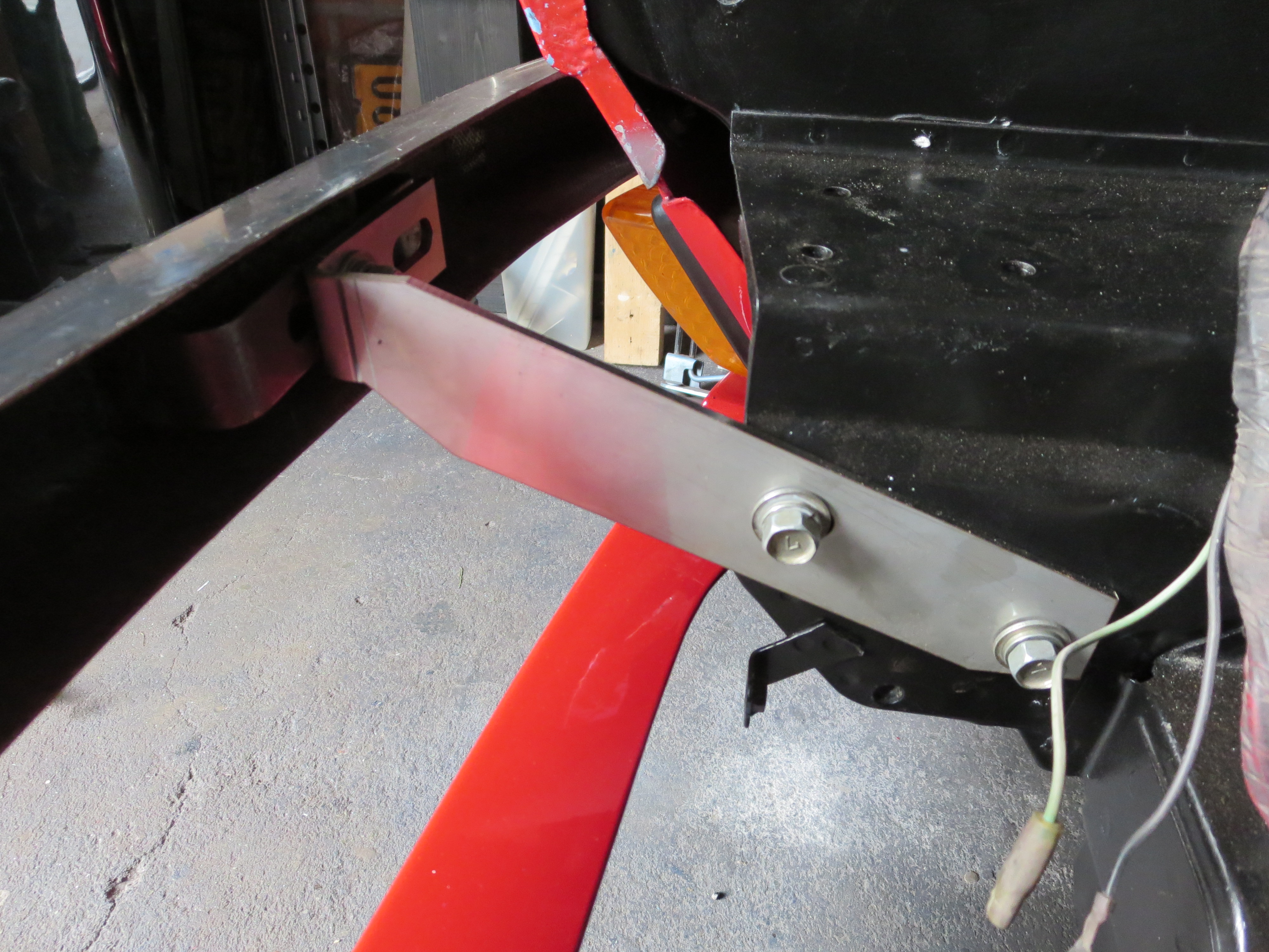

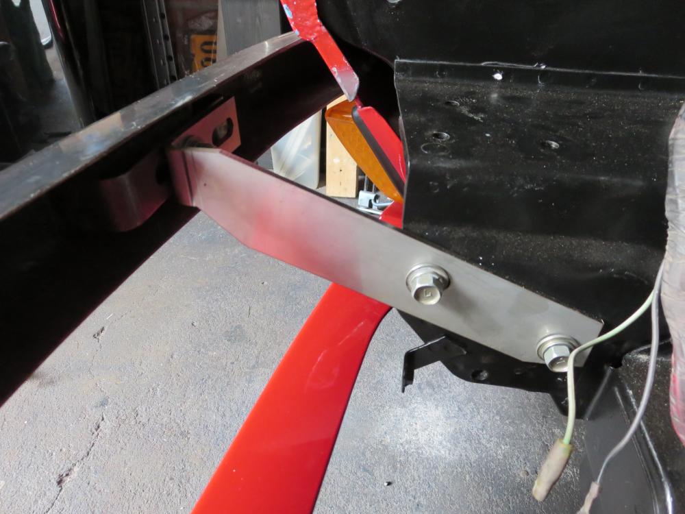

I pickled the welds today and tried the brackets on my car.

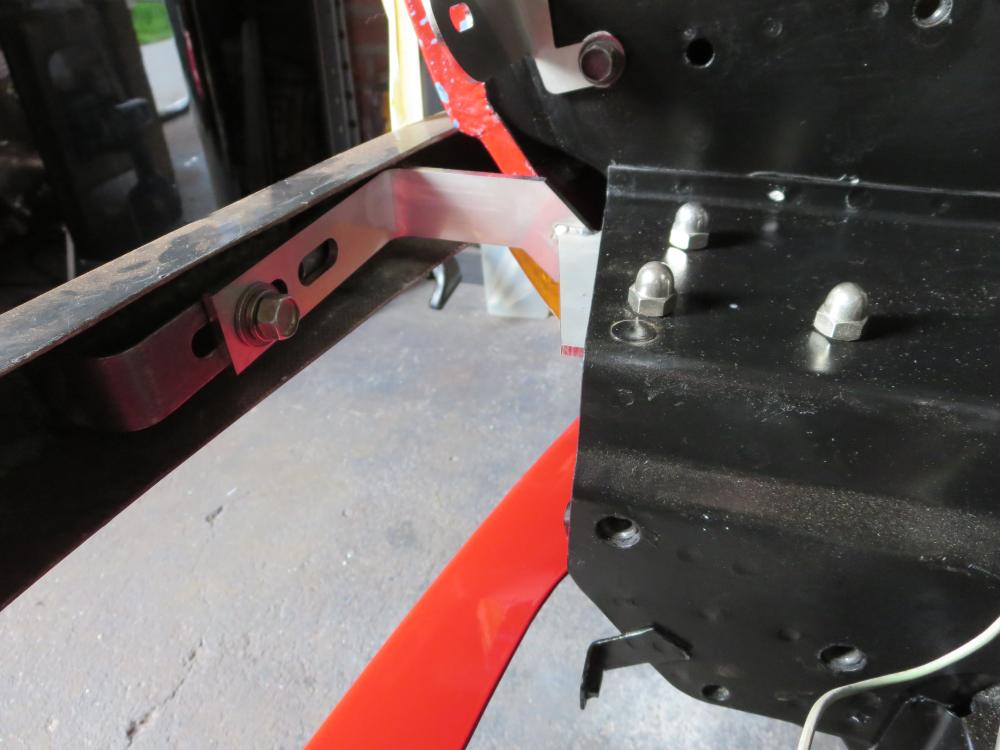

Here are the brackets all cleaned up and on the car.
I have fibreglas bumpers so its not a 100% guarantee, but with all the measurements I have from people I'm confident they will fit the original bumpers. All the critical distances are within 1 or 2mm and with the slotted holes there is a tolerance of about 15mm.

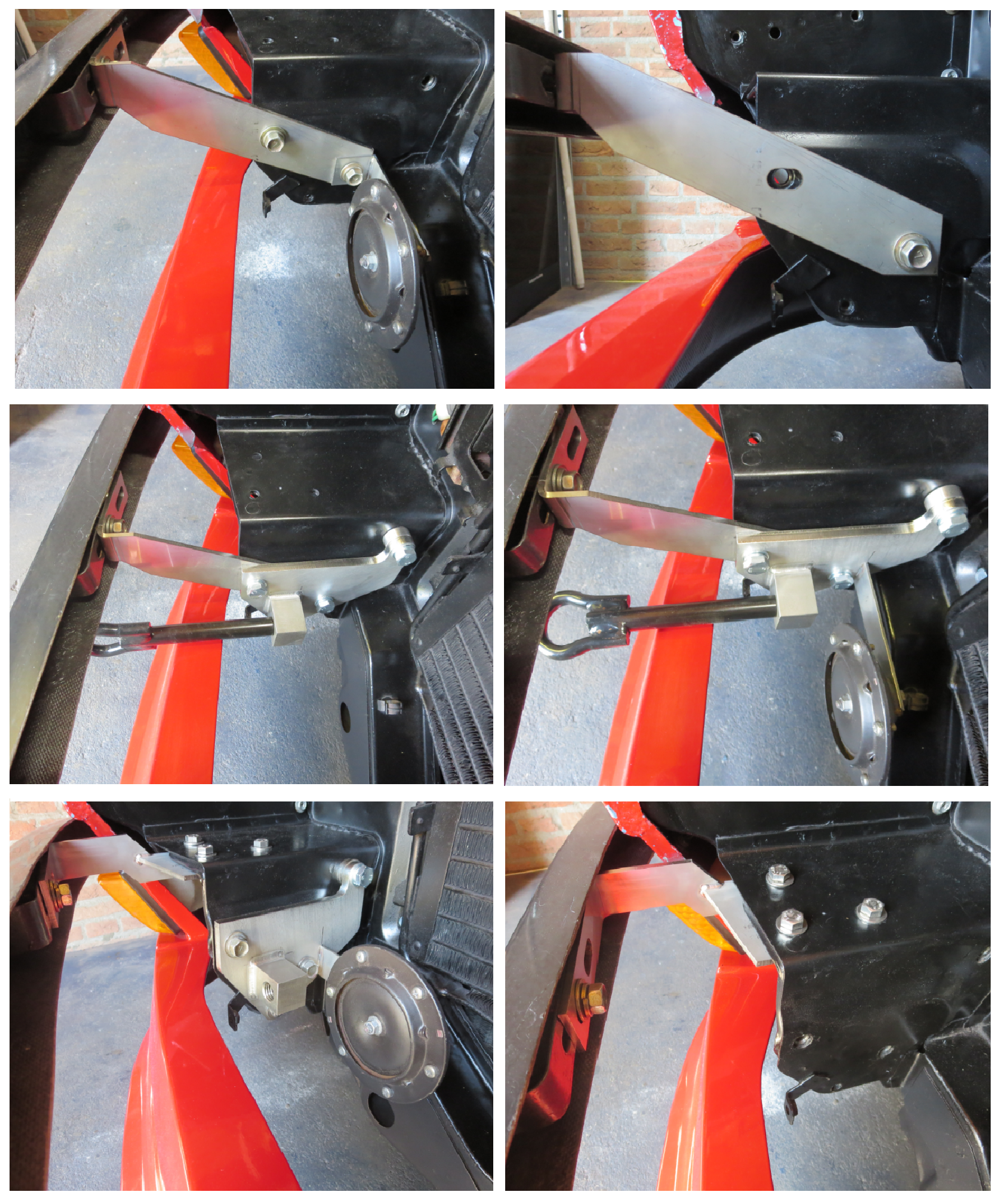

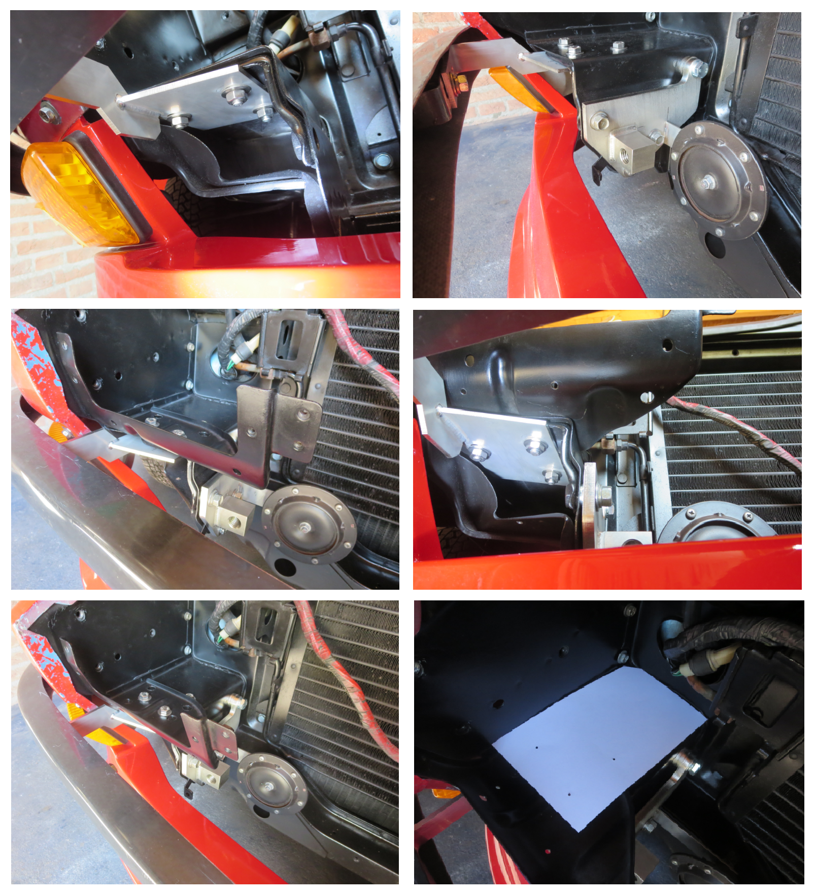

Its been a while since I last posted something here about the brackets. Mostly been busy in PM's with people interested in brackets,

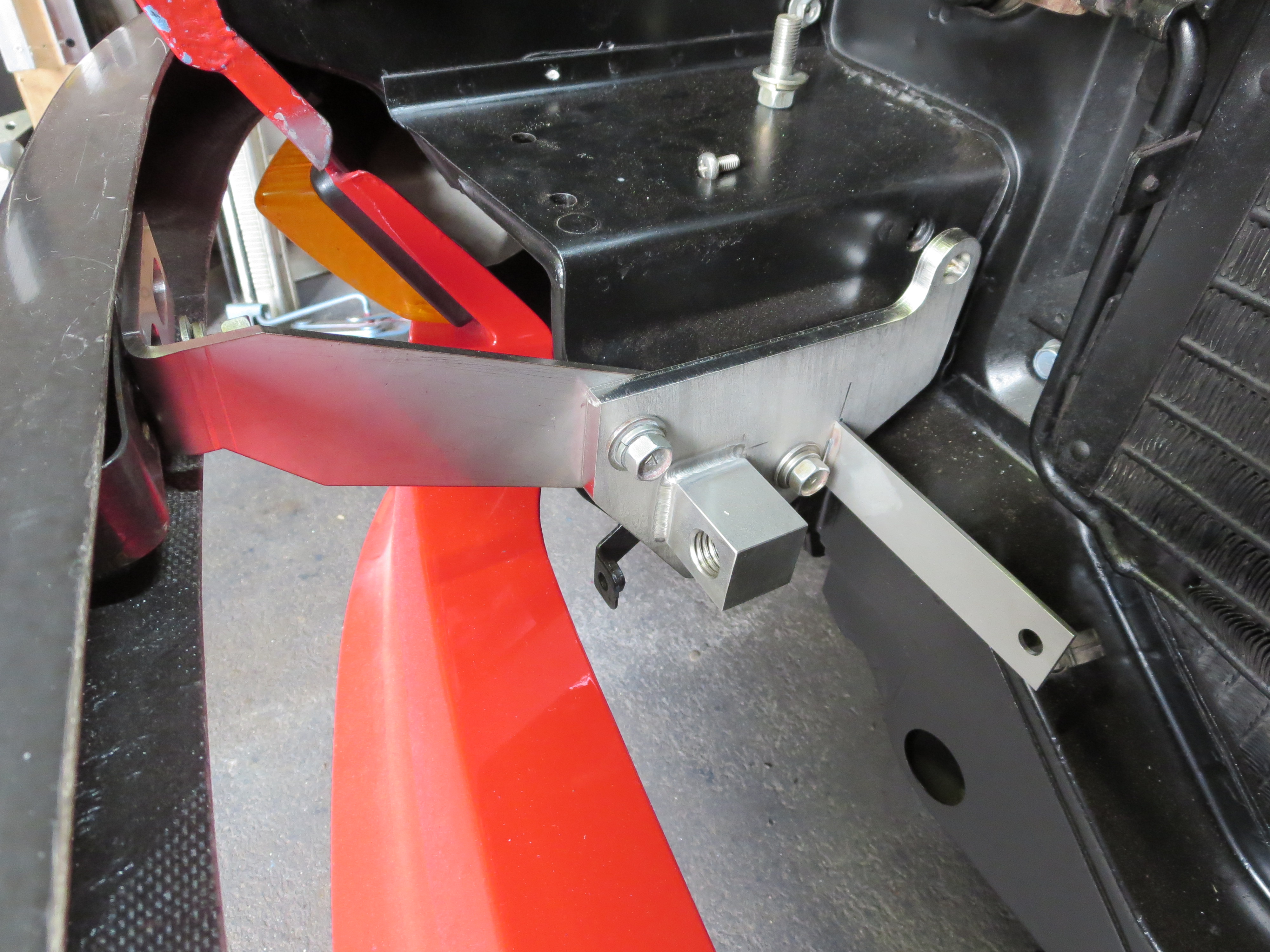

Tried some different combinations today. Now to put mine back together so I can drive it again.
