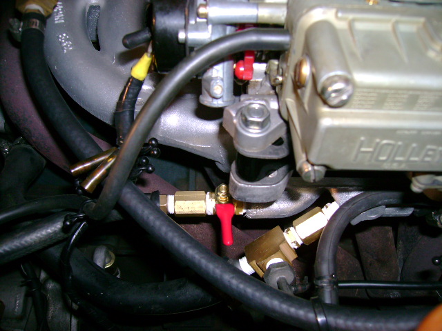

I kept my coolant lines.
I used a cheap water valve from the hardware store to set up a system where coolant could pass through the manifold, if required.
I don't drive regularly in truely cold weather but I have. If I do in the future, I don't need to worry about letting the thing idle to warm up properly before I drive off or things like throttle plates icing up. I like the idea of having an 'option'.
As far as performance goes, volumetric efficiency is improved in summer when the ambient temps are already high, the setup can be turned off. In winter, as I mentioned, there is some benefit to retaining something!
