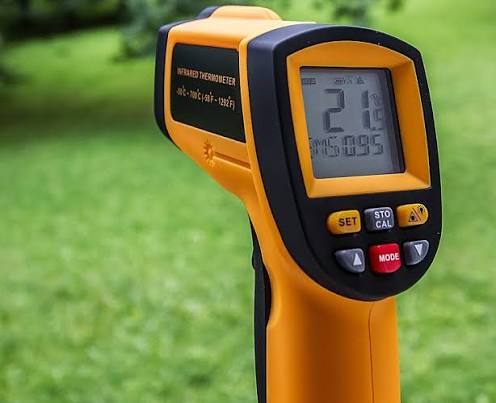

How else can i verify the current temp? Will i need to adapt or customize an external temp gauge?
so why don't you remove the radiator cap when the engine is cold and start the engine let it warm up. now make sure the coolant is low enough to not overflow. let the thermostat open and insert a meat thermometer the opening and be careful not touch the sides, insert 1-2 inches and then take a reading.
Buy an IR gun like this
Infrared thermometer - Wikipedia
All kinds of uses. When your car is good and warm, shoot the thermostat housing and verify against the gauge . When the car acts up in traffic, scan the carbs, float bowls, fuel rail, etc to see if something is unusually hot
Thanks ill get one from amazon! Any brand??
