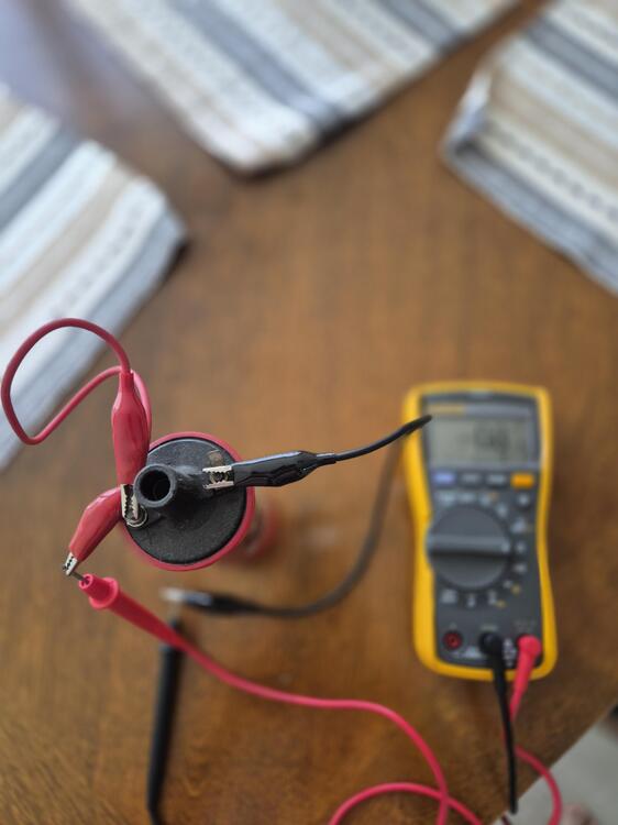

I did noticed mechanic replaced the pertronix 1.5 ohms coil with an msd blaster 2 coil which is connected to a pertronix 1761 module. Dont know if this could be the cause. Ive read you shouldnt use this msd blaster coil with the 1761 module. After the car engine shuts down it take a lot of key turning to crank the engine.
In that case, put those parts back on and see if it fixes the problem

0.8 ohms with pertronix 1761 module.
Talk to the mechanic who broke your car. I have nothing else to add.

Im just asking a question regarding compability of parts!

But having a 0.7 ohms vs 1.5 ohms coil affects or may damage the petronix 1761 module? Msd has that extra juice.
Dude just take it back to the mechanic who installed it and have him undo the new coil/MSD box as a test. There’s no reason to play guesswork if it worked before.
