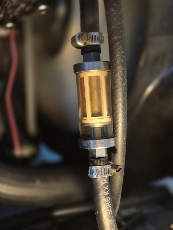

After reading the same problem with other users im beginning to accept this could be vapor lock as it only happens during heavy traffic and disappears once the temp goes down. Would a 4 row radiator kill this problem or should i get a ceramic manifold?

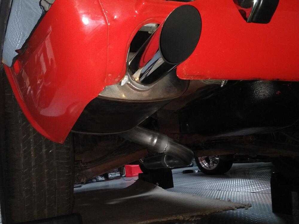

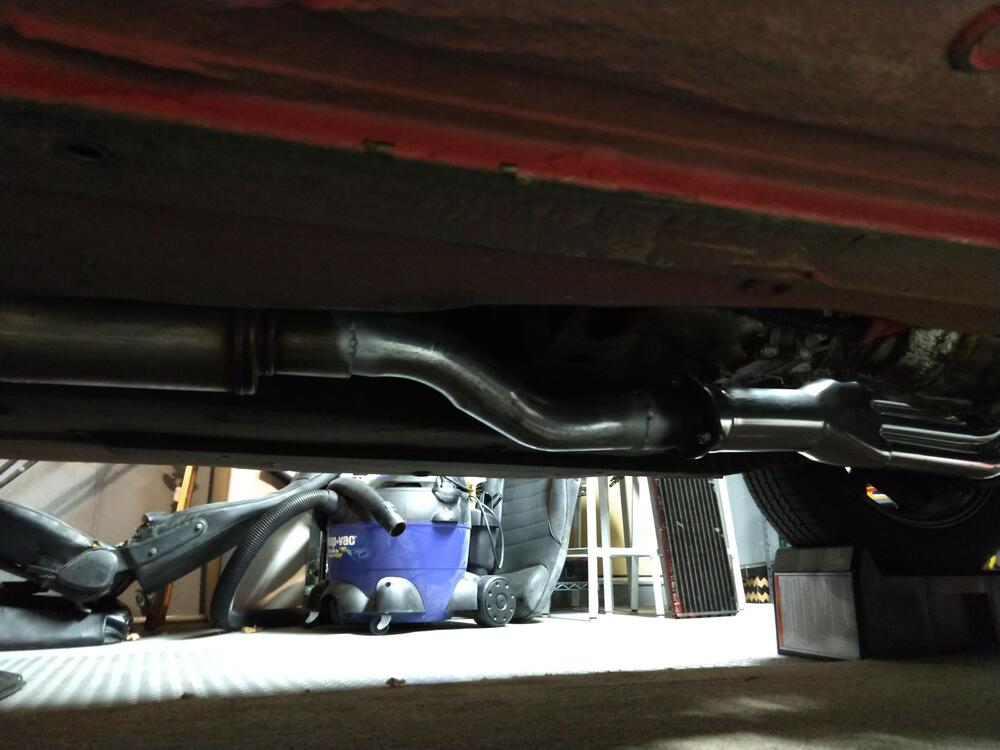

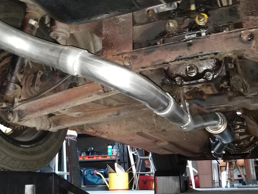

I went with the 6 to 1 ceramic coated headers and ran 2.5 inch exhaust the resto of the way out. I think this helped a bunch to channel heat away from the intake manifold! Used a Magnaflow 10426 in the tunnel for a resonator and a Magnaflow 13216 for the final muffler. Had an exhaust shop build the exhaust from the headers out with a chrome angled tip at the end. See attached pictures for the exhaust from the headers out.

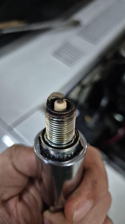

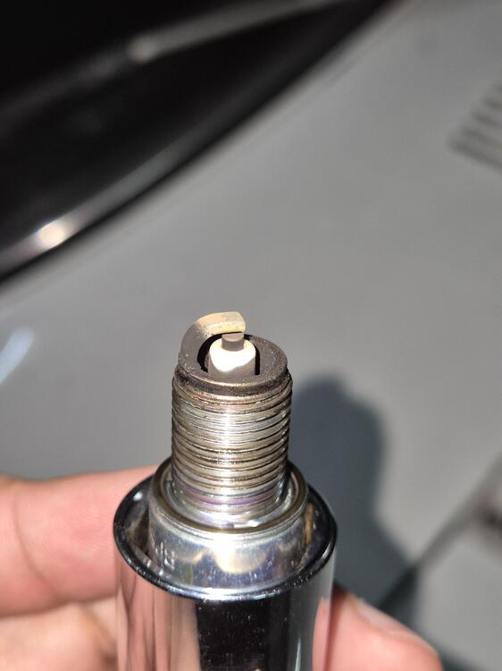

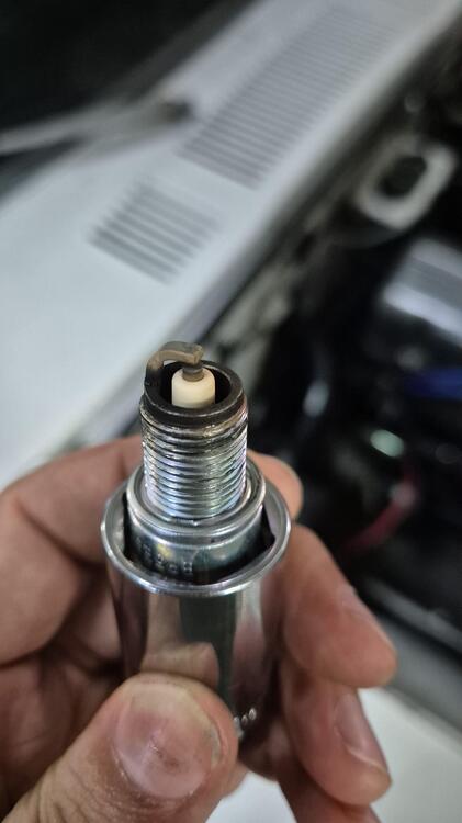

Just came back from some light traffic. Still at 3/4 on the temp gauge but no bubbles in the clear fuel filter. Took the plugs out and see everything normal. Maybe a 4 row radiator could help. Do you concur?20260718_181457.jpg
