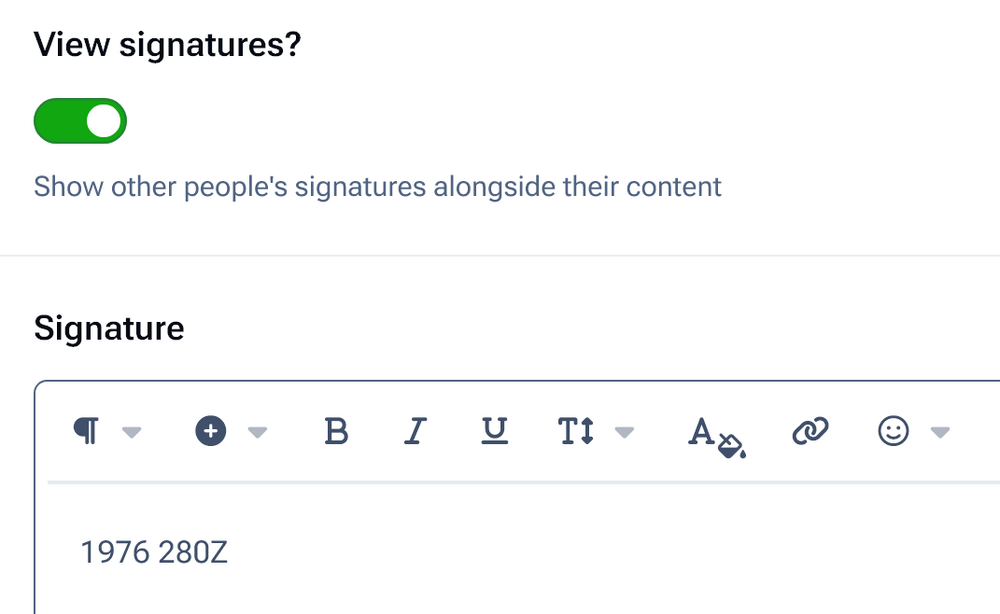

Edit - except that I see that Signatures don't seem to work anymore. Mine is gone and so are others.
Something that might be helpful on these long build threads - update your signature with details as you discover them. 10 pages is too many to easily go back through to figure out the basics.
It's not under Profile it's under Account Settings.
https://www.classiczcars.com/settings/signature/

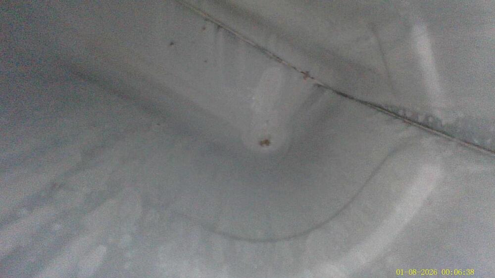

Finally back from vacation, got some goodies before I left.

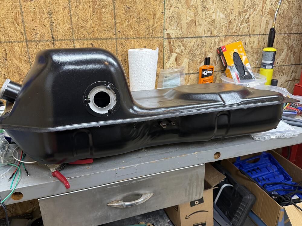

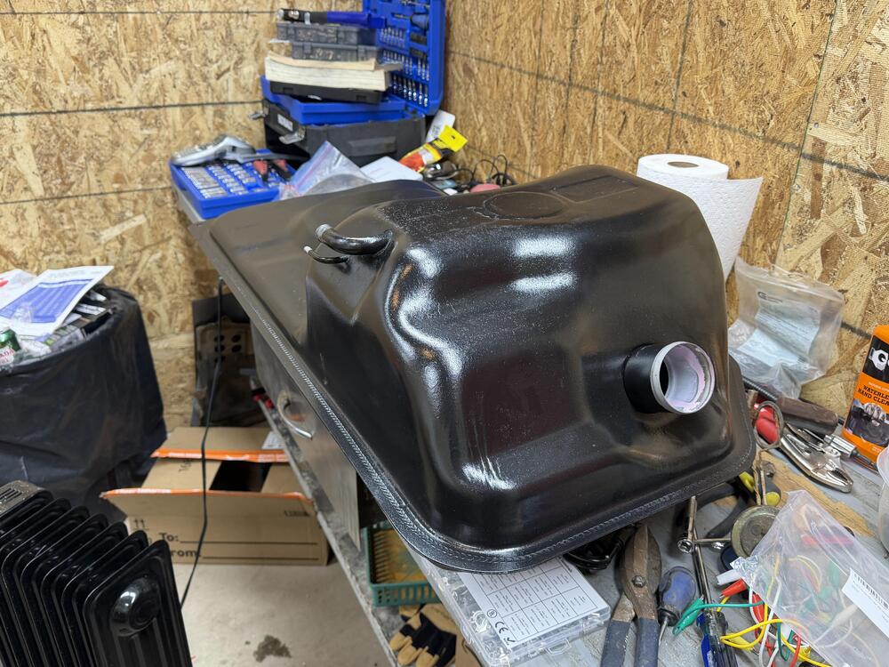

I picked up my now shiny fuel tank from the cleaners.
Shout out to Spikes radiator and repair in Denver, the owner was one of the few old timers still doing this kind of work.
Cost $475 since it was pretty nasty inside. He cut out three holes and sandblasted the interior/exterior of the tank, coated the interior and painted.
The insides looks good. Not perfect, but def better than it was. Beats 700$+ for a new one.

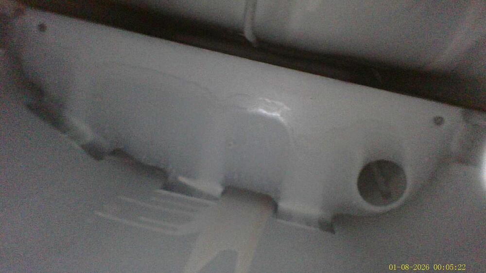

Before
After

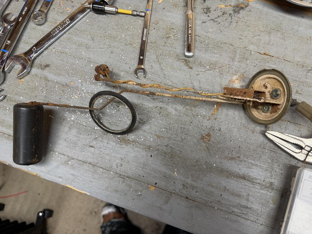

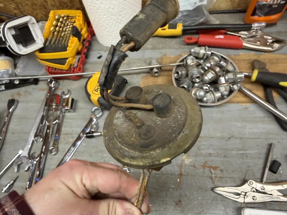

So now I need to fine a fuel sender for it. This is what I have. But according to zcar depot this may be the wrong sender for this tank? Their replacement show that this sending unit is for the top of the tank. The other sending unit they have doesnt have the second rod. Booo Maybe I can take this apart and clean it.
Submerge that sending unit in CLR for 24 - 48 hours. It will come out clean.
