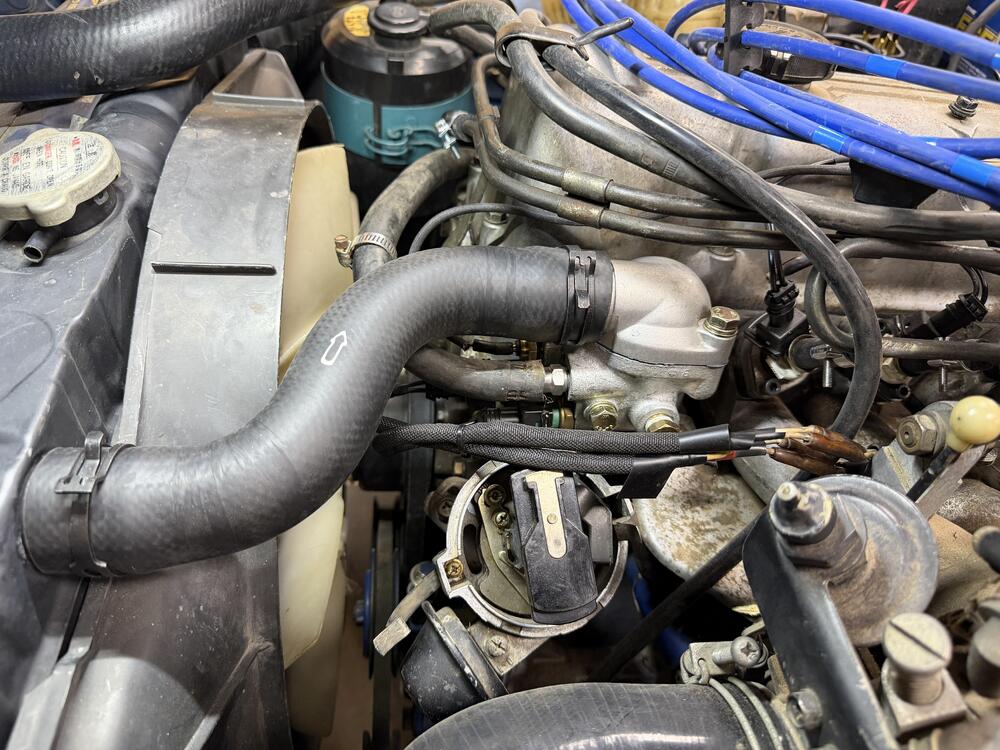

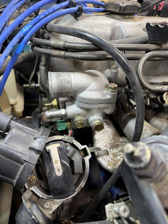

Thanks to @Yarb I was able to get the cooling system buttoned up and let the car run for about 30m and all seems well. Even managed to get the fan clutch and fan shroud back on. So far no leaks.

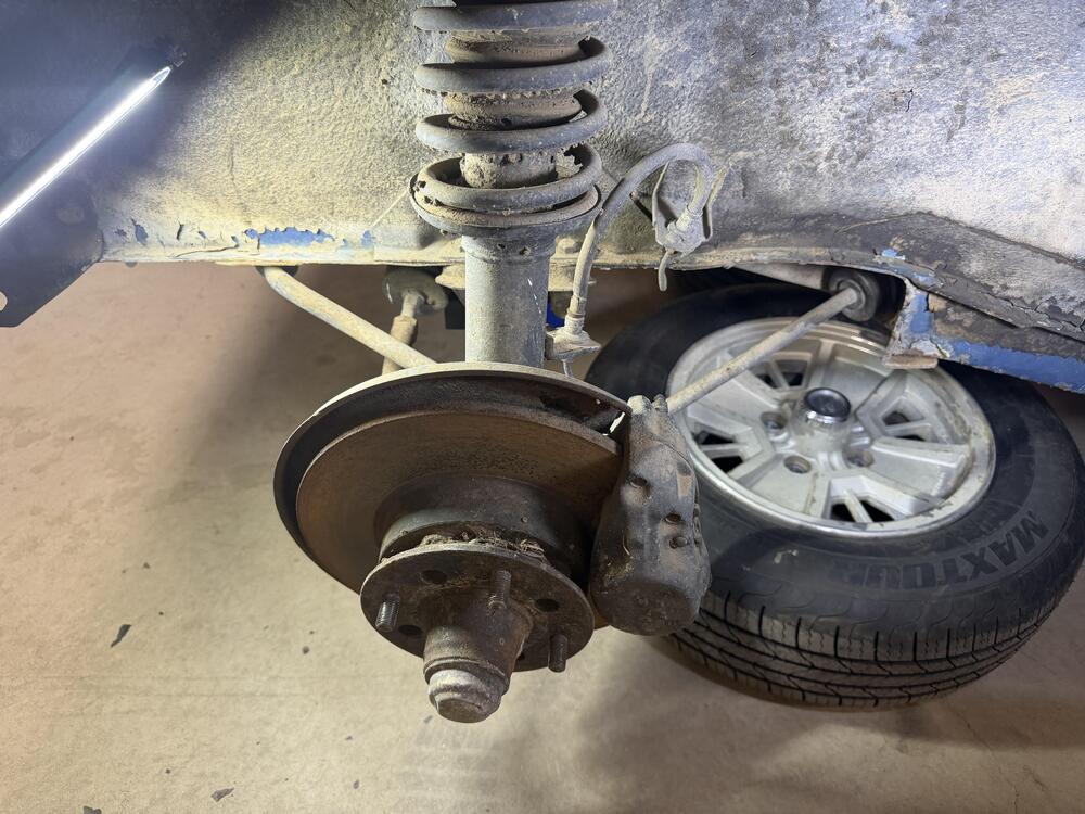

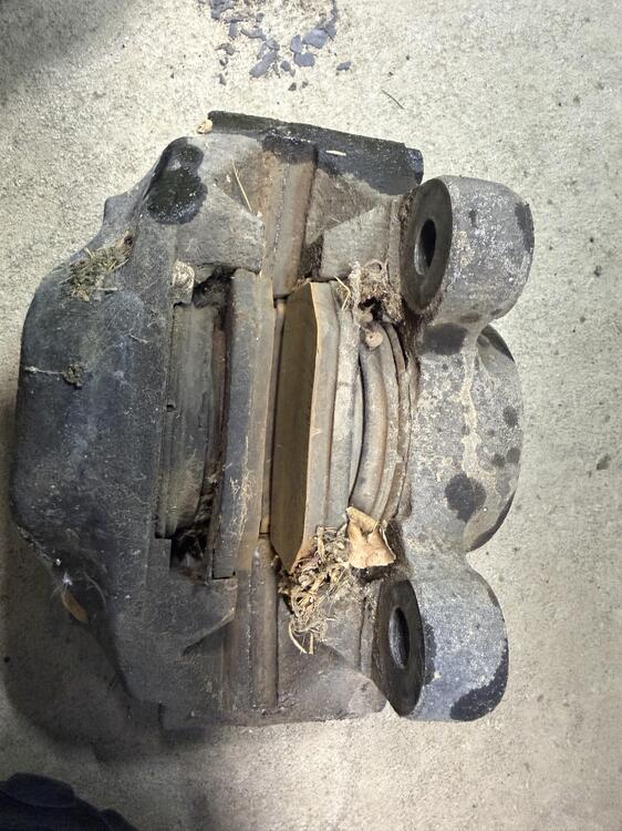

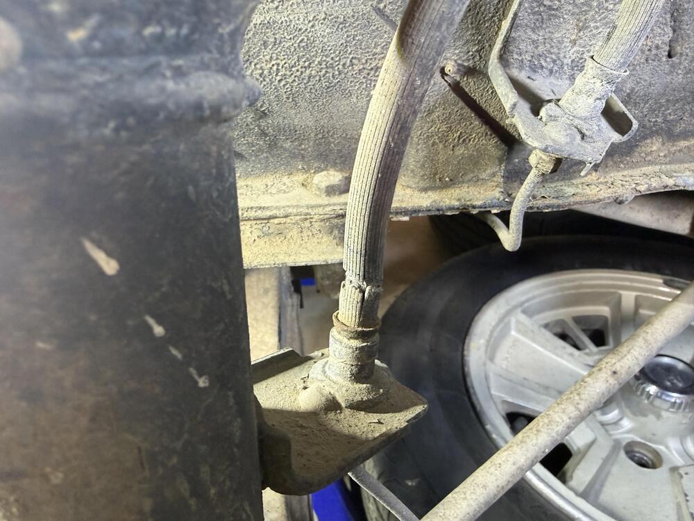

Took the brakes apart tonight, for the most part is went fairly smoothly. I stripped the nut on one of the rear brake lines so I ordered a new set. Also order complete rear brake refresh, tie rods, sway bar bushings, wheel bearing, seals. since im reworking the entire brake system, I decided to order a clutch master and slave cylinder. They were pretty cheap. Also caved and bought the NRG steering wheel and adapter.
The old front brakes still has a lot of meat to them. All the old rubbers are getting replaced as well. but Im having a heck of a time breaking the rubber clutch line loose. Im worried about stripping that one. Its soaking in pen lube atm. I might buy a fire blanket and add some heat to it. A bit skeptical about that since its right next to the fuel lines lol. At worst, it looks like a new line is about $100

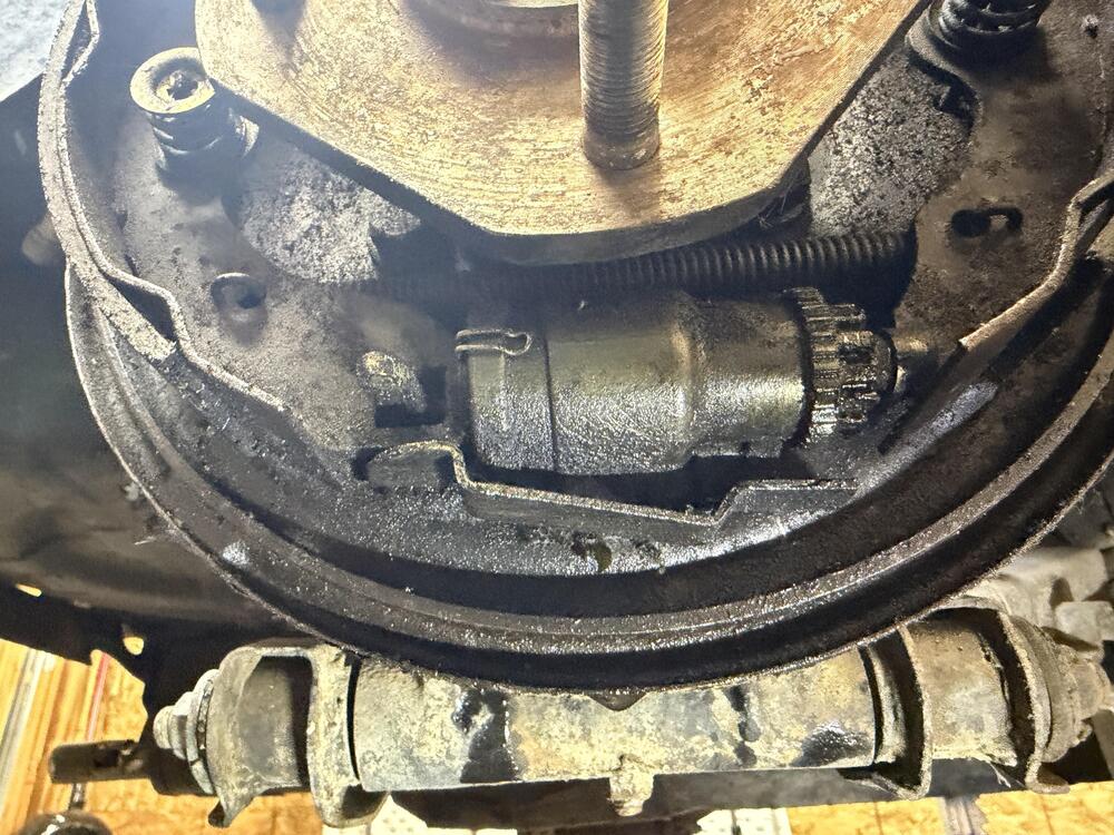

I decided to replace the wheel cylinders as well. This one has fluid in it, but im not positive that the cylinder is bad. Both the bleeder and the brake line were loose. I must have forgotten to tighten them when I bled them the first time. No matter, it will be all nice and shiny soon. Maybe I can buy a rebuild kit and resell them to recoup some money. Im still reusing the old drums, they seem to be in good shape, New ones a bit pricey. I just need to give them a good scrub. The brake shoes still had a fair bit of meat on them as well.
You can remove the slave cylinder from the transmission and let it spin instead of spinning the nut. Hold the nut stationary, spin the fitting on the end of the hose. Once it breaks free and you know it will come off, cut the hose. Spin the new one on, reinstall the slave cylinder.
Saw a video about a similar problem with a brake line.
I've found that heat helps too.
Edited by Zed Head
I had thought about that, good to hear it actually works, hopefully I can get a pair of vice grips in there to hold the nut in place
Needle nose vice grips
Managed to brake the clutch line loose using two vice grips, but the nut on the line is seized. I ended up removing the line and I just ordered a new one.

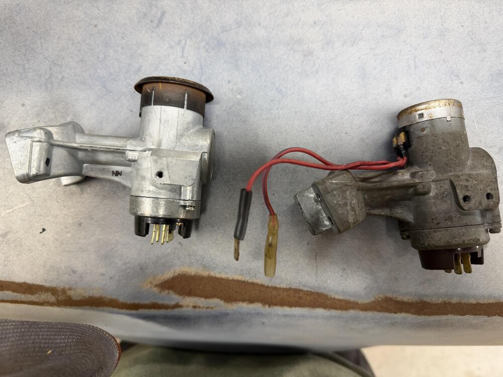

I bought a new ignition lock cylinder a while back and I also needed to clean up the turn signal switch. Come to find out that there is a small white piece that attaches to the horn arm that is broken and dry rotted. So I'll be looking for another one of those. I also noticed that the old lock cylinder has two red-blue stripe wires that the new cylinder doesnt have. anyone know what those are for? They connect in the column wiring harness.
