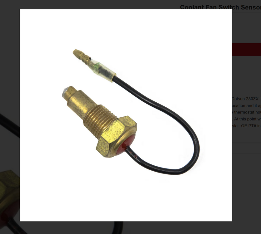

The outlet he has in his hand has 5 outlets and the bypass is installed. I still don’t think this is a S30 housing. Did we get clarification if this is a ZX motor? It has the intake blower as well. Good chance it goes to the blower motor.
@Yarb I think you might be right. The serial numbers dont match, and it has an l28 and an n47 head. As I am reading, that combo is only available from 77-80.
That sensor does connect into the harness and it does appear to be oem, I had to cut the covering off to disconnect it. I'll have to see if I can find the other end of that wire.
If I remember correctly. The hairdryer had cut wires and didnt have a connection that I could locate. I remember asking about it one time and it was suggested to just remove it, Link to that post
Bingo, I found the sensor by looking up 280zx injector cooling fan sensor and the first result was a part from zcardepot which looks just like it. So it sound like I can just ignore it
