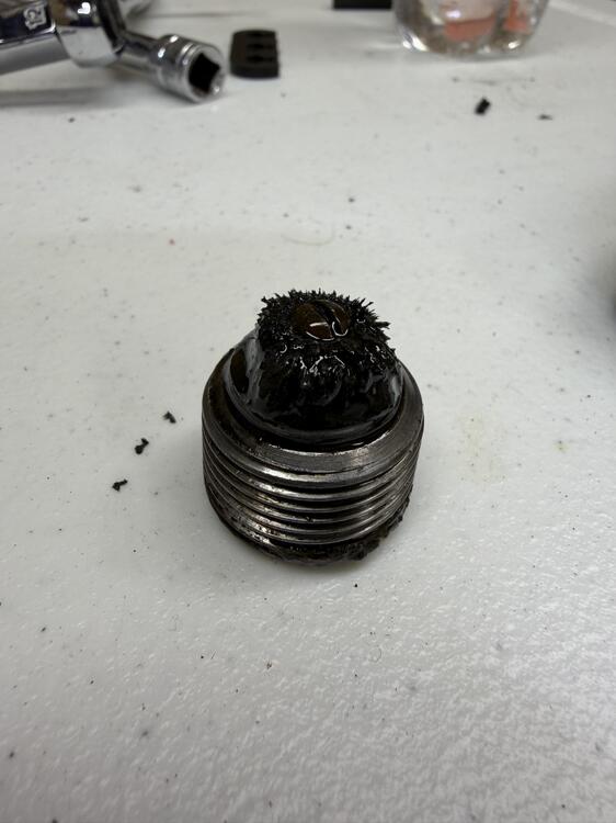

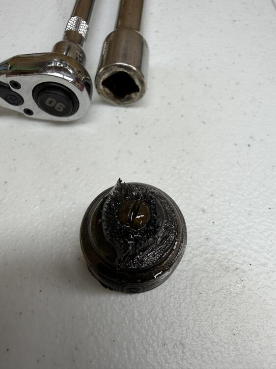

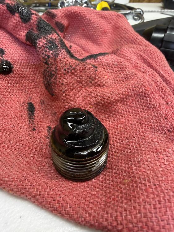

Got a fair bit done today. Managed to change my Transimission fluid with some Redline MT-90 and the differential with some redline 75w-90. Both had metal on the magnets, Im not sure of the severity of it though.
This was from the transmission, its hard to tell on the second pic. I cleaned half of the plug to compare.
This is from the differential. Pretty much the same amount, maybe a bit less. The oil is much thicker so its also hard to tell.

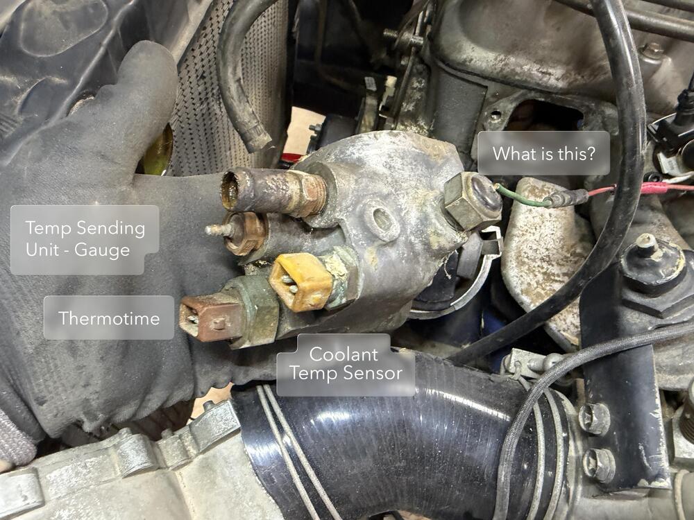

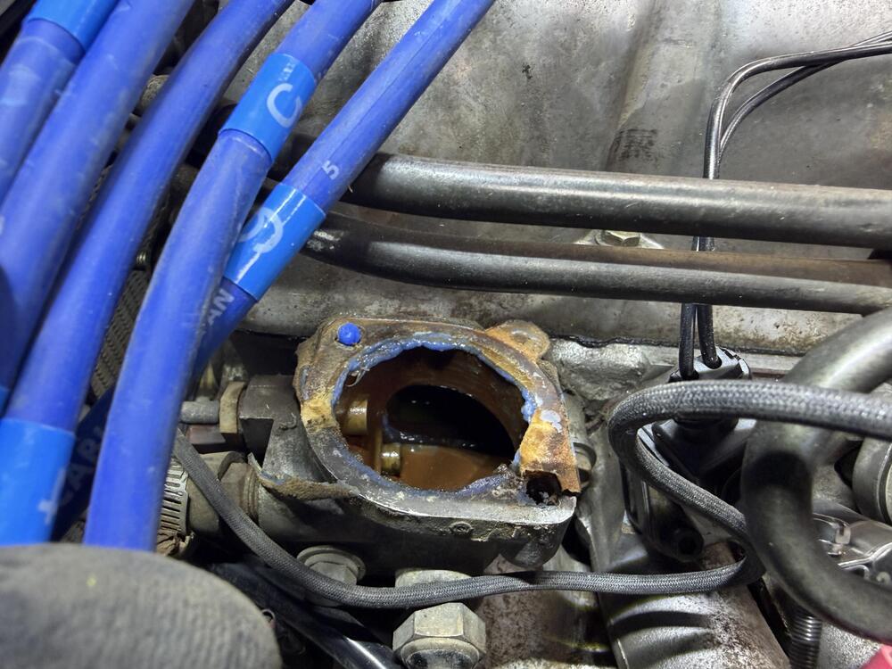

Also decided to drain the radiator and replace some coolant sensors and the thermostat. Whoever did the work on this last made a mess. There wasnt even a thermostat installed. I also broke the petcock =( So while I was ordering a new one, I decided to order some radiator hoses and a cap even though the old ones still felt really good. At least I can now take the radiator completely out so I can reinstall the fan clutch.
I've got a post up in the engine section asking about one of these sensors. Looks like the wire is about to break off. Hopefully someone can identify it so I can get a replacement. I looked through zcardepot and I couldnt find anything close to it. Its also a different size thread compared to the others
Never seen that before. Looks like it maybe a sensor for an electric fan. Do you have a ZX engine in your 280Z?
Edited by Yarb
I didn't crack open the 75 FSM to compare, but this is in the 76 FSM.
It looks like the water temperature switch was removed and the coolant bypass was installed in it's place. Where does the wire go to that is attached to the sensor on the side (where it should be the coolant bypass)?
