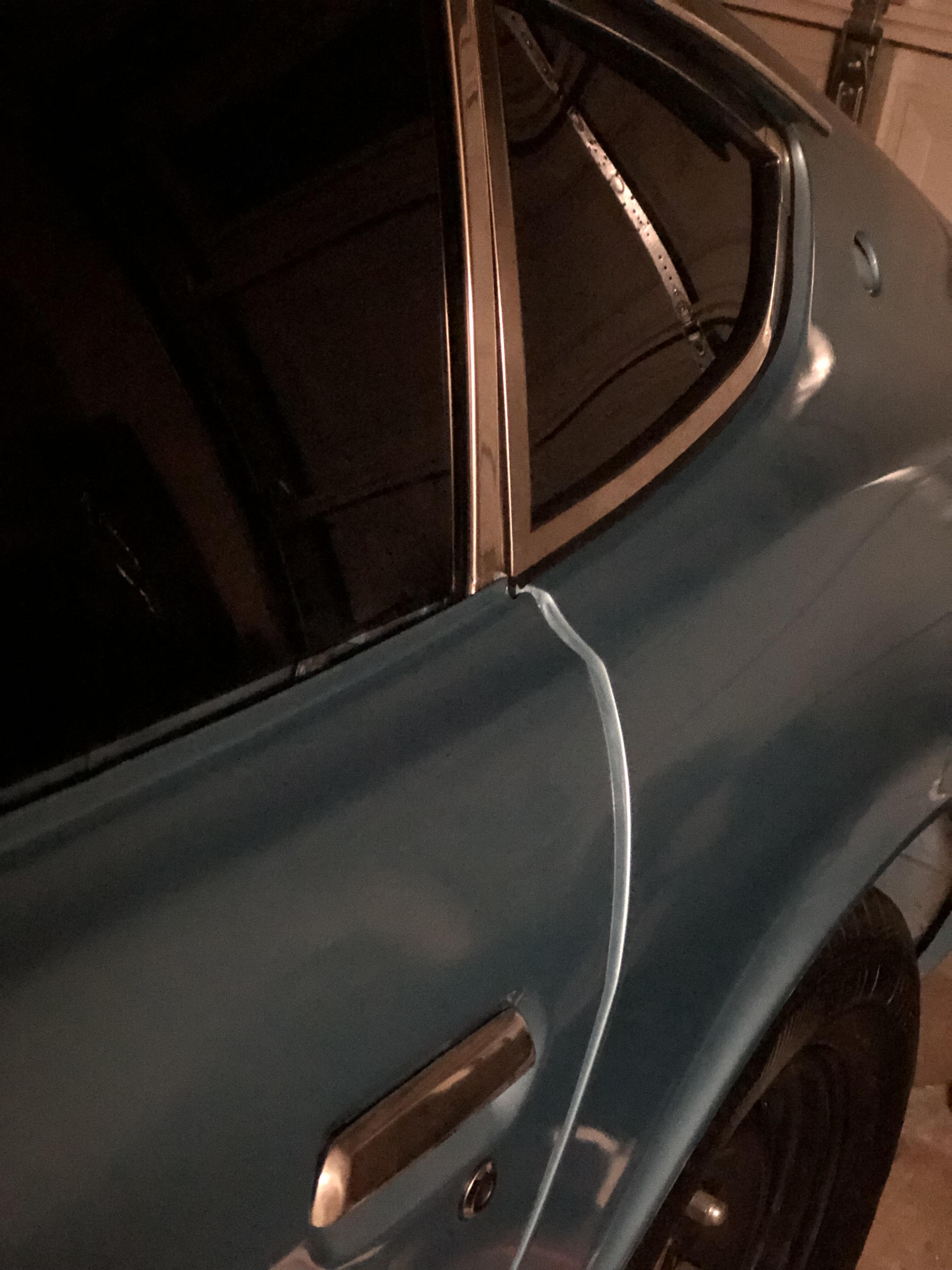

Guys this is after I had installed the main door seal. I can probably live with it. But seems like the lower edge is aligned and not the top. How does your fitment looks? Can this be fixed?
Well I would guess that if the painted part of the door aligns well then you could loosen the stainless frame and tip it in to preload it, so that it crushes the seal more.
Or as a final step you could bend the frame in some more but you'd have to be careful doing that
First question i would have is.. does it fit like this when the rubber is out? I think it does.. If that's the case i would leave it out, loosen all the screws from the stainless part and close the door carefull then see if you can align it with the glass down.. be careful not to break the glass. Then open the door careful and fasten the lower screws and test if the door still fits. you can fasten the screws lightly and still change the fitment in the dooropening.. fidle with it take your time.
I wouldn't bend the stainless, when i take a look at your foto it's repairable by only make a adjustment in the setting of the screws.. they are made for these adjustment, they can make the top shift for half an inch or even a bit more i think?  above all, take your time and if you are scared to do something like this take out the glass.. but that's a lot of work.

About living with this.. your door is not watertight this way.. so don't leave it like this..
I think I have found the problem. Have not verified yet...

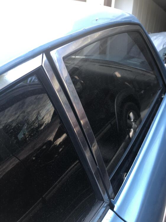

This is the driver side door with the seal in. As you can see the top part of the chrome window channel is aligning well with the Qtr panel but the botom end is further pushed inside ... this is also consistent with the main door blue painted part also being pushed inside.
We took off the doors for painting the car. I think I have to loosen the bracket bolts to the door and pull this one out a bit. For the passenger side I might have to push it back in. Will give it a try later this week.
