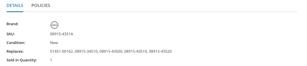

Terrapin Z Posted December 9, 2023 Share #16 Posted December 9, 2023 (edited) I was thinking number 71 in the diagram. That also calls for 8 each Superseded now see second pic. Still available from Nissan. Edited December 9, 2023 by Terrapin Z added info Link to comment Share on other sites More sharing options...

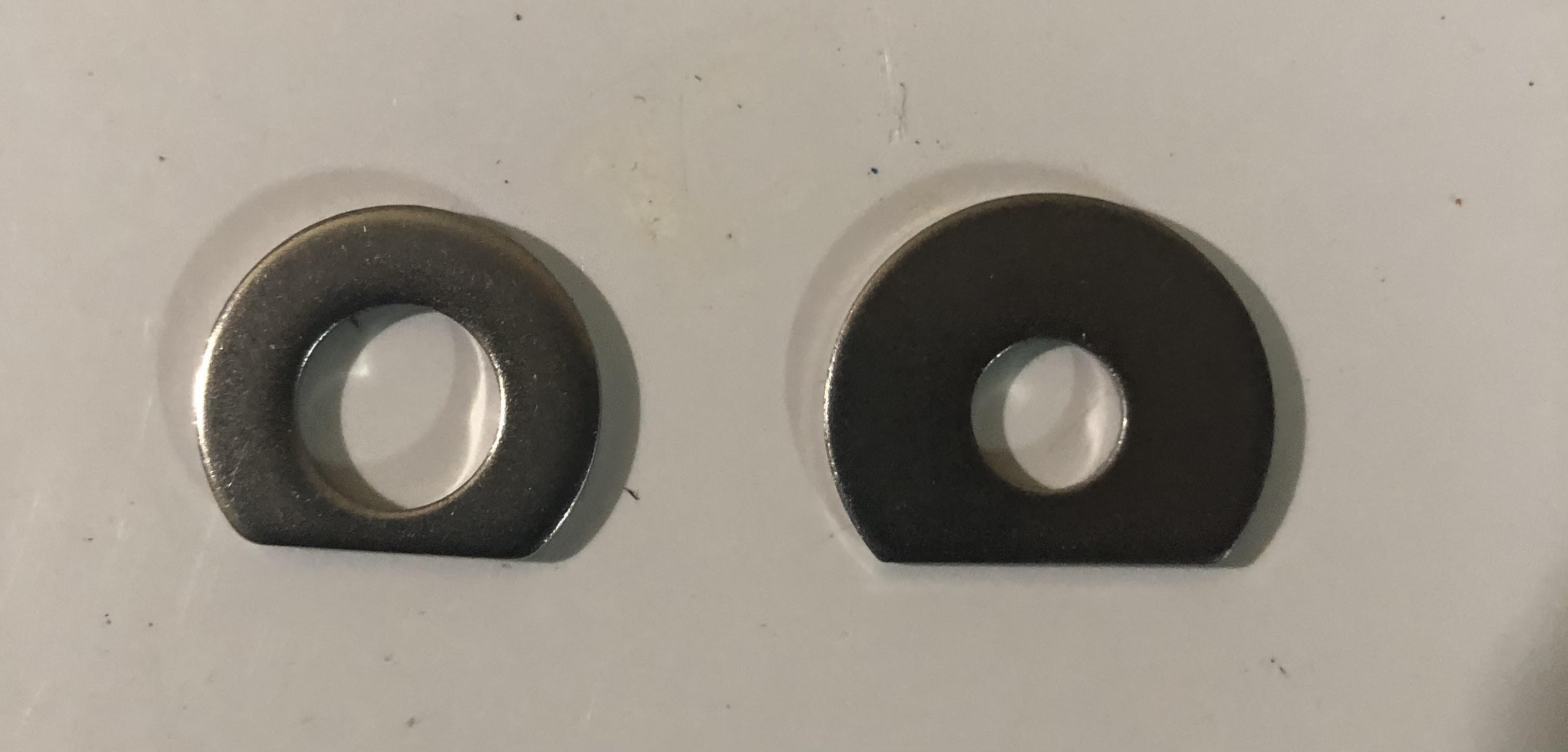

MH77280Z Posted December 12, 2023 Author Share #17 Posted December 12, 2023 Guys, just a quick update. So the left washer in the pic is McMaster and right one from MSC (link below). I installed the MSC as the inside diameter is a better match with the M6 bolts which you need there. McMaster has more options too but they are out of stock for many. https://www.mscdirect.com/product/details/06772388 2 Link to comment Share on other sites More sharing options...

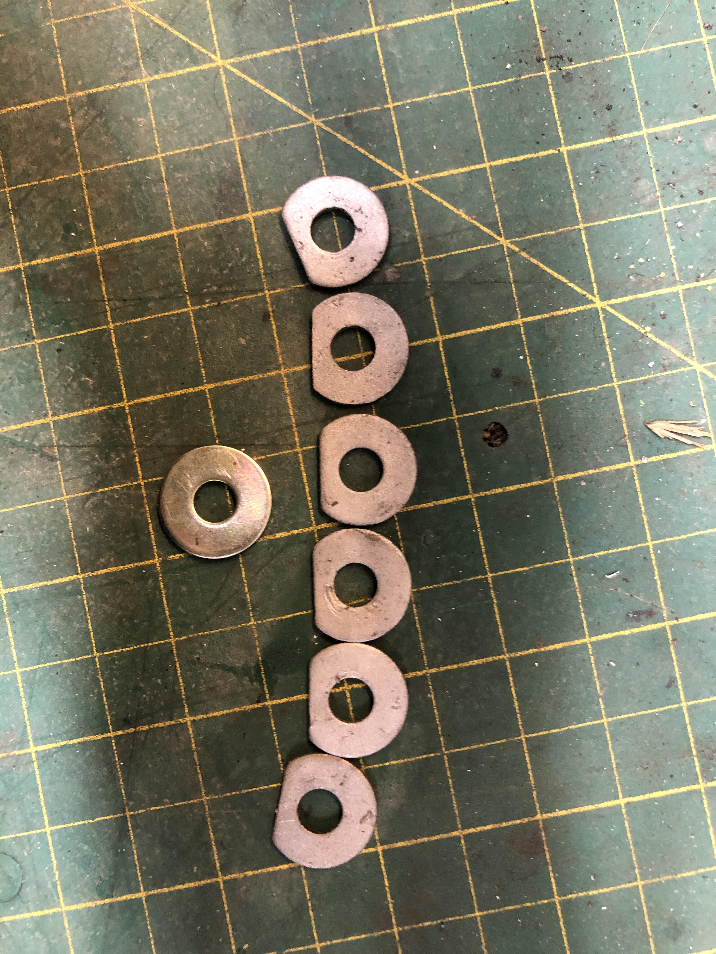

zKars Posted December 13, 2023 Share #18 Posted December 13, 2023 This is my non-impressive collect ATM. But the good news is that I have a very very close replacement washer source. These are 17.6 mm OD with a 6.4mm ID. (The web site says 18mm OD, but they are lying, I mean nominal…..) They are nice and thin as well. Of course you have to create the flat spot yourself, then get them replated, but when you have to get it right, you have to get it right, right? https://belmetric.com/hv-140-steel-general-purpose-din-9021-fender-washer/?sku=WFE6X18YLW 1 Link to comment Share on other sites More sharing options...

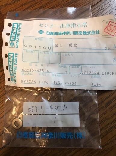

MH77280Z Posted December 13, 2023 Author Share #22 Posted December 13, 2023 On 12/9/2023 at 9:08 AM, Terrapin Z said: I was thinking number 71 in the diagram. That also calls for 8 each Superseded now see second pic. Still available from Nissan. Hopefully it is not this one. Was trying to find a pic of the part number and saw this 😄 Link to comment Share on other sites More sharing options...
Terrapin Z Posted December 13, 2023 Share #23 Posted December 13, 2023 (edited) 3 hours ago, MH77280Z said: Hopefully it is not this one. Was trying to find a pic of the part number and saw this 😄 It did label it as Washer Plain, so i am not 100% sure. That bag shows a -4351A which might again be different than a -43510. I also don't see the -4351A as part of the superseded list. Which part number did you order from Nissan? -43610 (Zed's) or the -43510 (mine) or both? Edited December 13, 2023 by Terrapin Z spelling Link to comment Share on other sites More sharing options...
Yarb Posted December 13, 2023 Share #24 Posted December 13, 2023 (edited) 4351A is what I ordered. Guess I’ll have extra washers. Edited December 13, 2023 by Yarb Link to comment Share on other sites More sharing options...
