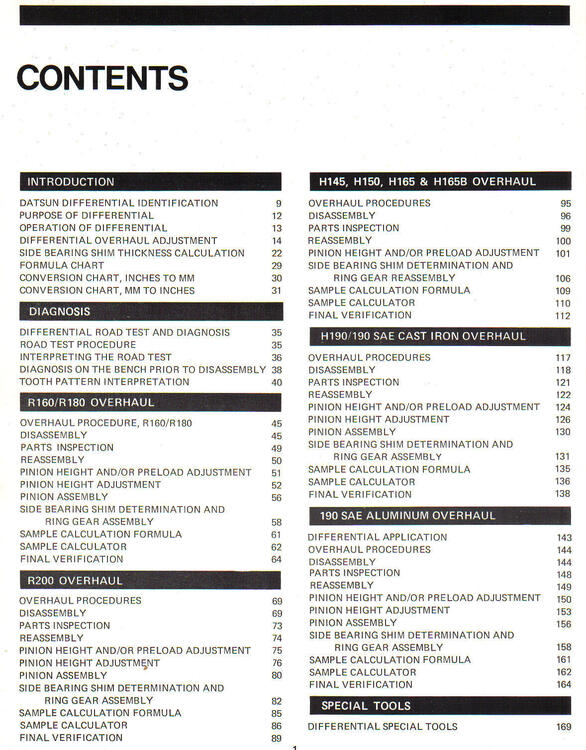

I have this manual, it doesn’t help you with your shim problem but has lots of good info on how to set up a diff. I just have to figure out how to post it as each page is a single large jpg file.DIFFERNTIAL SERVICE GUIDE- contents.jpgDIFFERNTIAL SERVICE GUIDE- cover.jpg

@240dkw Nice manual!  Maybe you could put a copy of that book here on the service manual listing? (Under Resources/knowledge Base in top of this site.) Guess you have to contact Mike about that..

That manual looks very interesting.  Seems likely to have far more information about assembling a differential than the factory 240z workshop manual.
