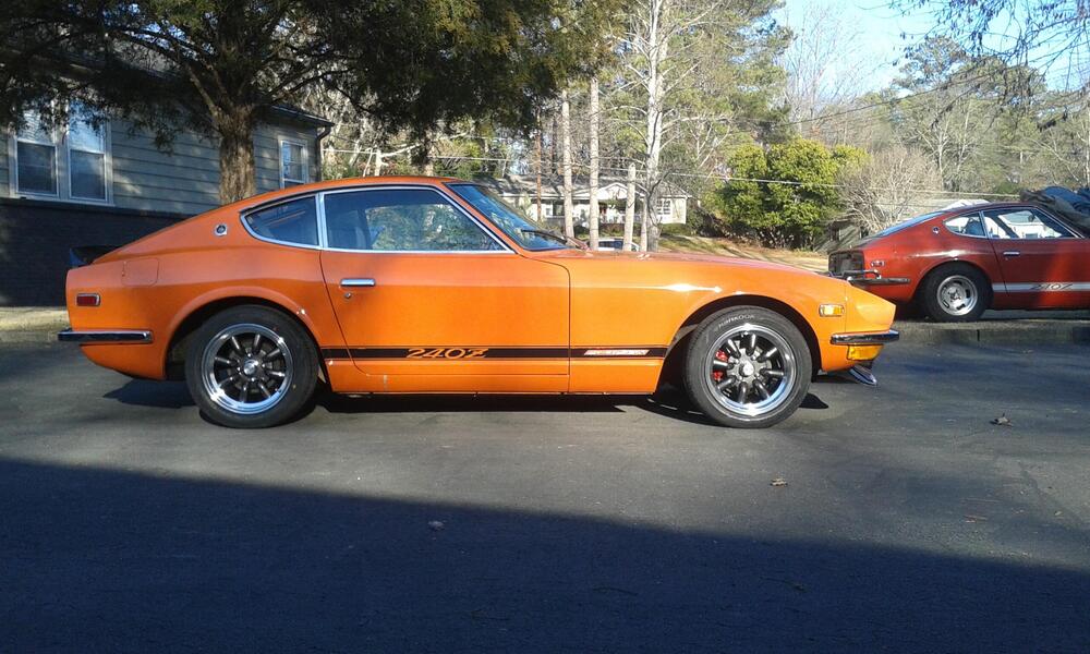

To keep from whizzing off all my buddies that run 16s on 240s I could have gotten a smaller side wall tire. I'll include the sizes when I get back.
I really like the 15s with Hankook 205/55-15 (I think LOL) on my 240 though. Shameless show off...
Those are 14s on the slots back there on that red one BTW.
