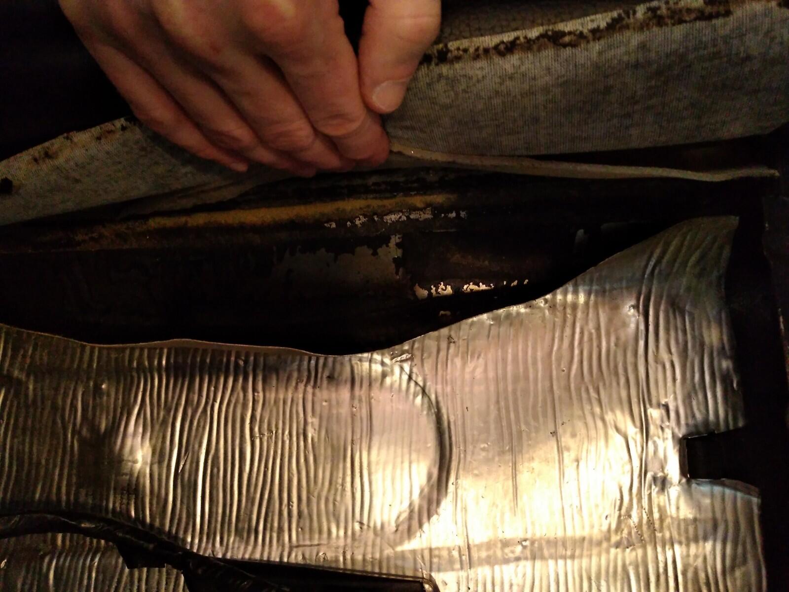

So the interior guy already laid down the undercoating, vinyl and carpeting.  I'm having to peel it back to reinstall things like seatbelts as part of the restoration.

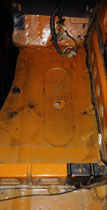

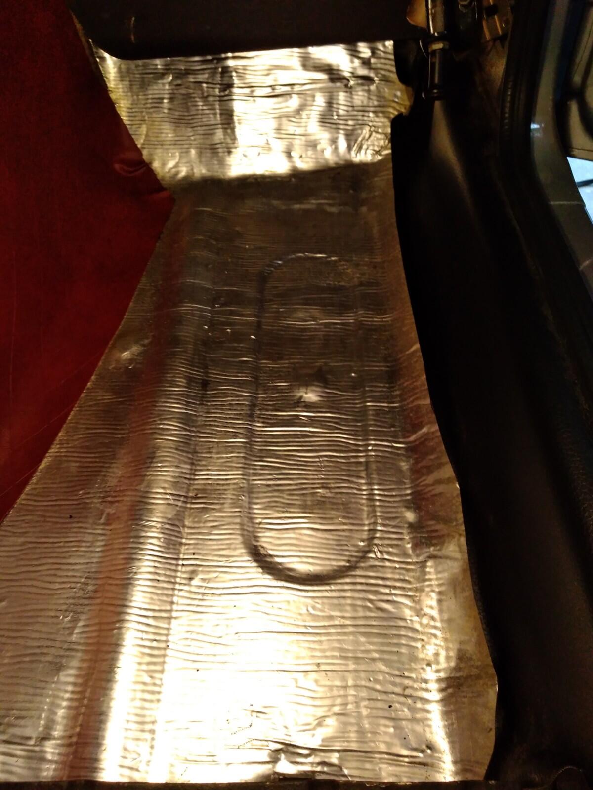

Next up:  Routing the body harness from the connections on the right side of the dash to the notch in the dogleg panel.  The harness has already been run, but it's not tucked away.  I assume it goes under the carpeting and vinyl along the passenger sill, but I'd like to get an exact visual so I only have to peel and reapply things once.
Does anyone have a mid-restoration picture of the passenger sill area showing the harness tucked where it's supposed to live?  Thanks.

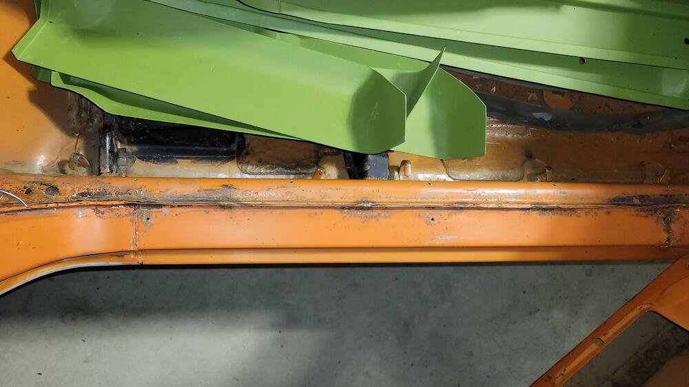

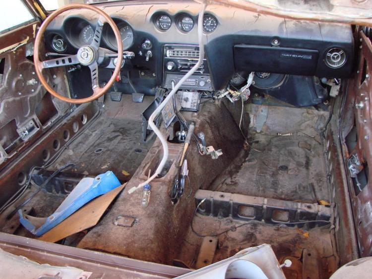

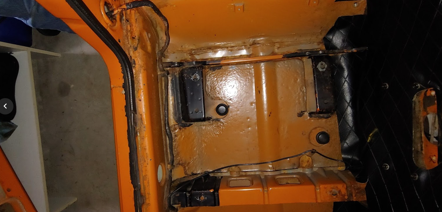

Here are some pictures before I removed the wiring harnesses from my 7/70.
^Thanks!  Those are REALLY helpful.

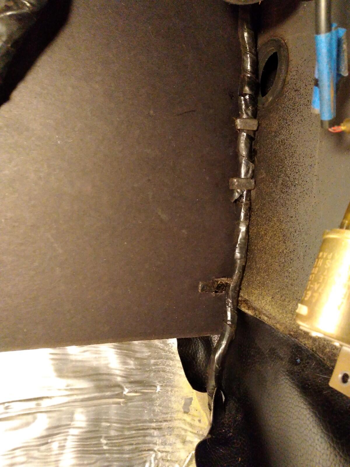

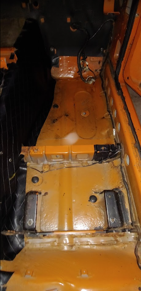

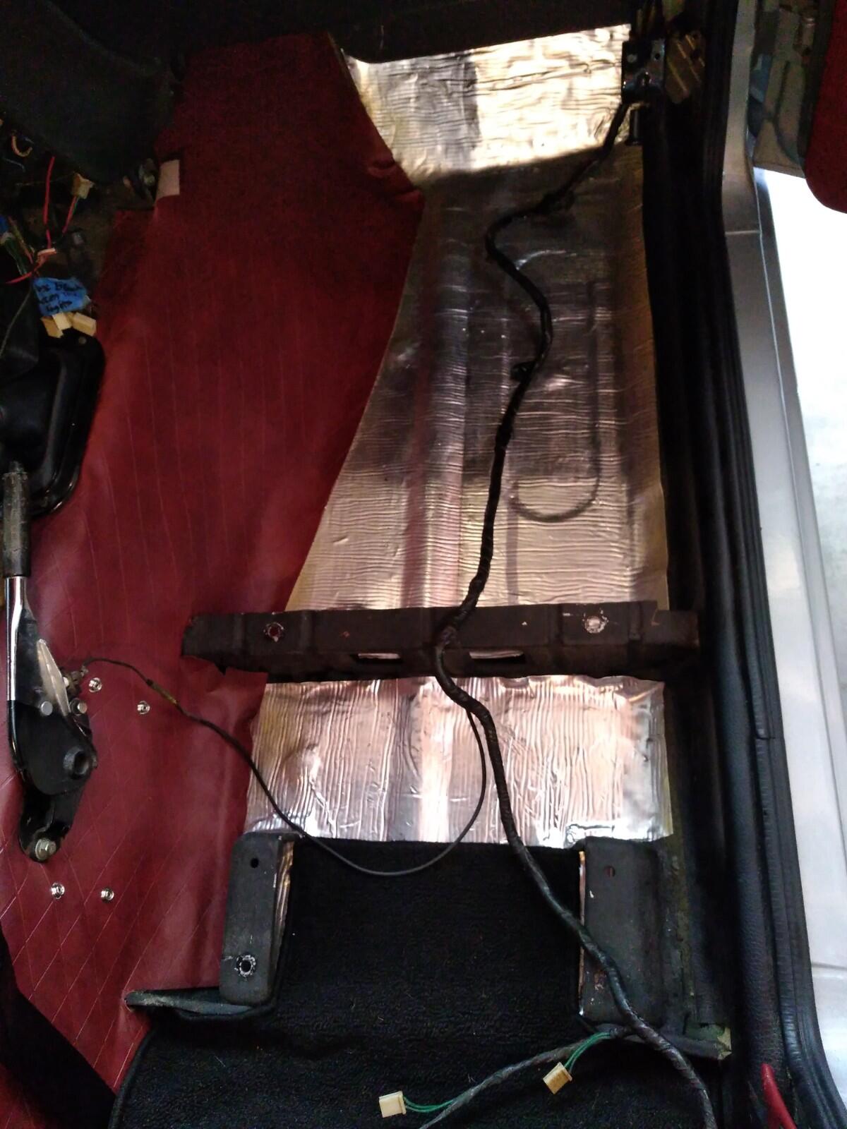

So here's what I was dealing with:
So either 1) the '72s didn't have tabs for the harness (unlikely), or 2) the body or interior guys removed them at some point:
Nothing underneath the vinyl.
I'm thinking someone removed them, since there ARE tabs on the driver side for the antenna and speaker wires.
I tucked the body harness into the corner underneath the sound deadening as best I could, and hitched it up along the corner of the firewall.
Came out OK.  The vinyl looks a little lumpy, but hopefully it will settle down with time.

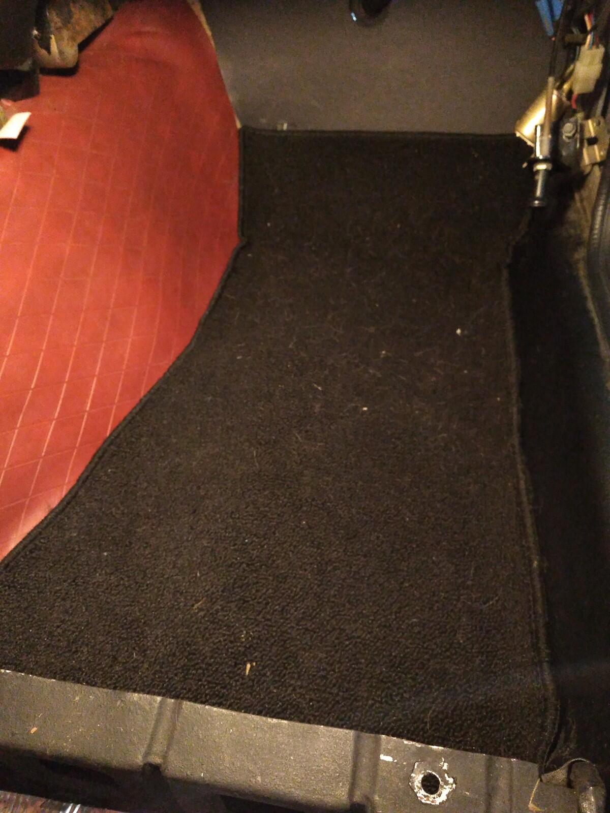

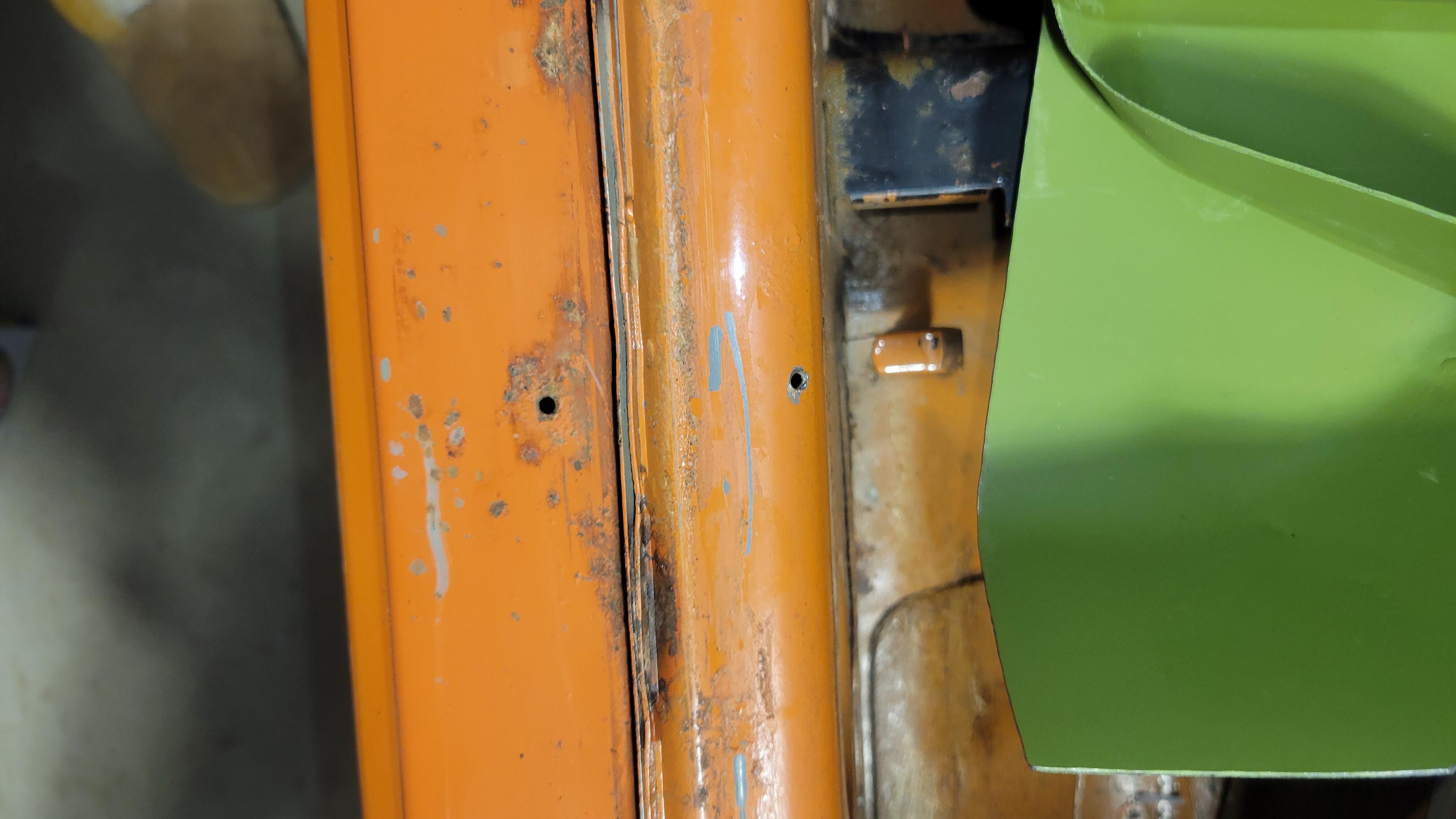

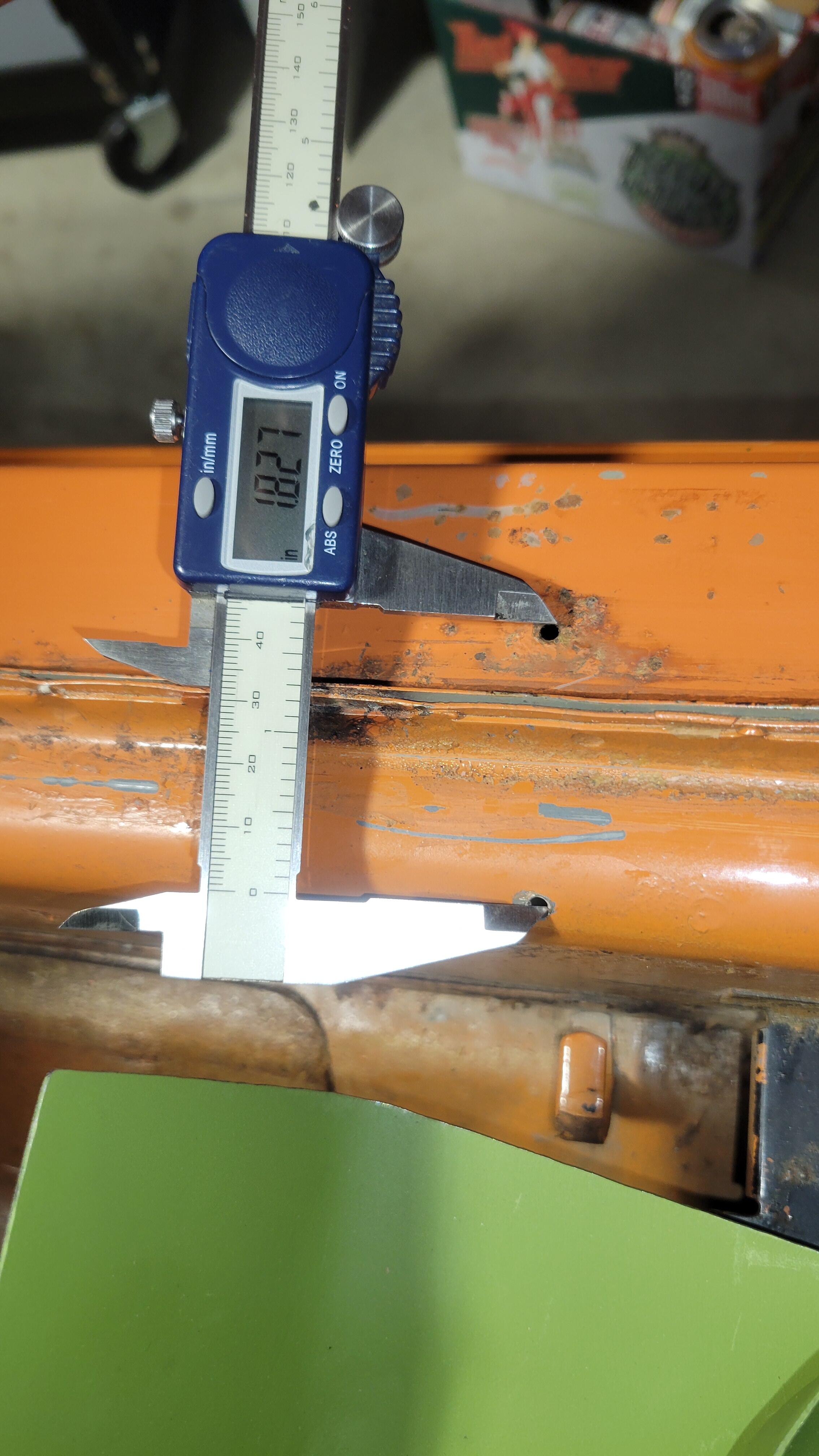

OK next question:  Can anyone tell me where the center screw hole for the inner sill plate is in relation to the center screw hole for the outer sill plate?
Obviously the upholstery guy covered those holes without marking the vinyl, and I'd prefer not to either 1) pull up the glued-down vinyl and check or 2) make random cuts in the vinyl and root around in there with the screw head.
If I can get the center screws aligned, the ones at either end should be fairly easy to locate.
^Those were a HUGE help!  Thank you!

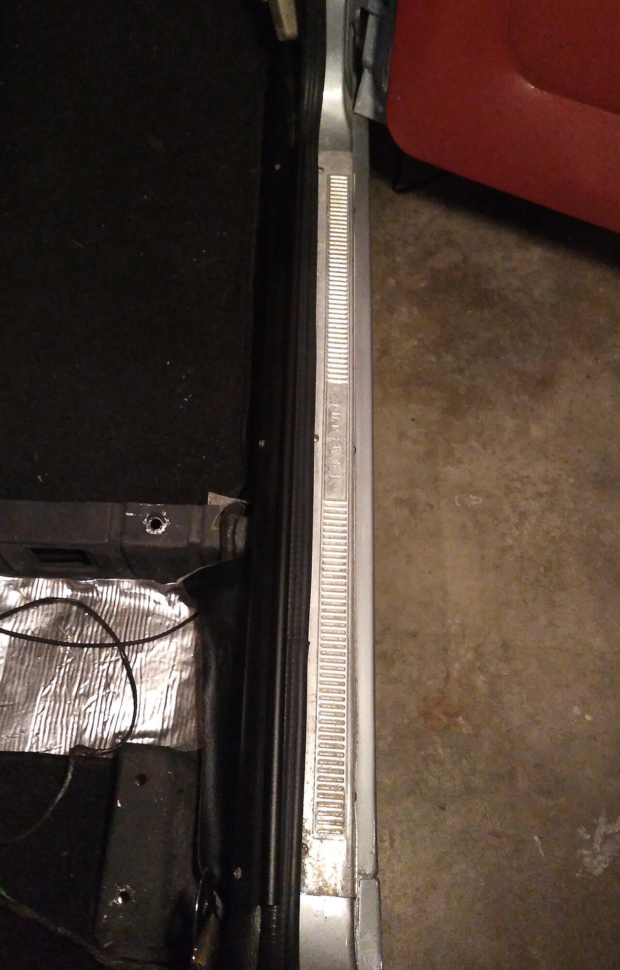

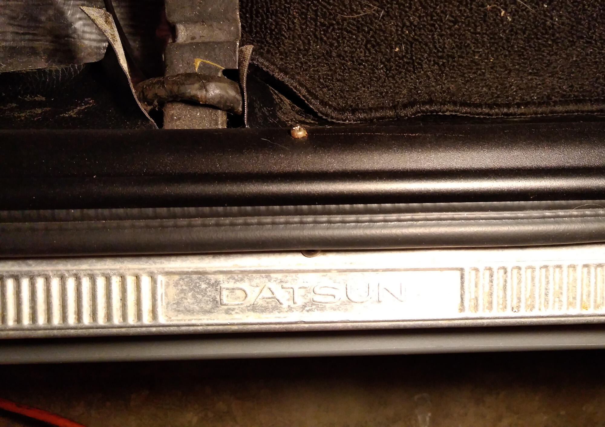

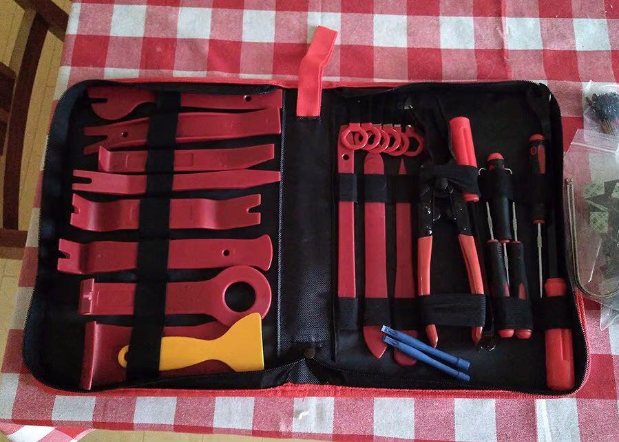

I actually got smart for once and broke out the trim kit:

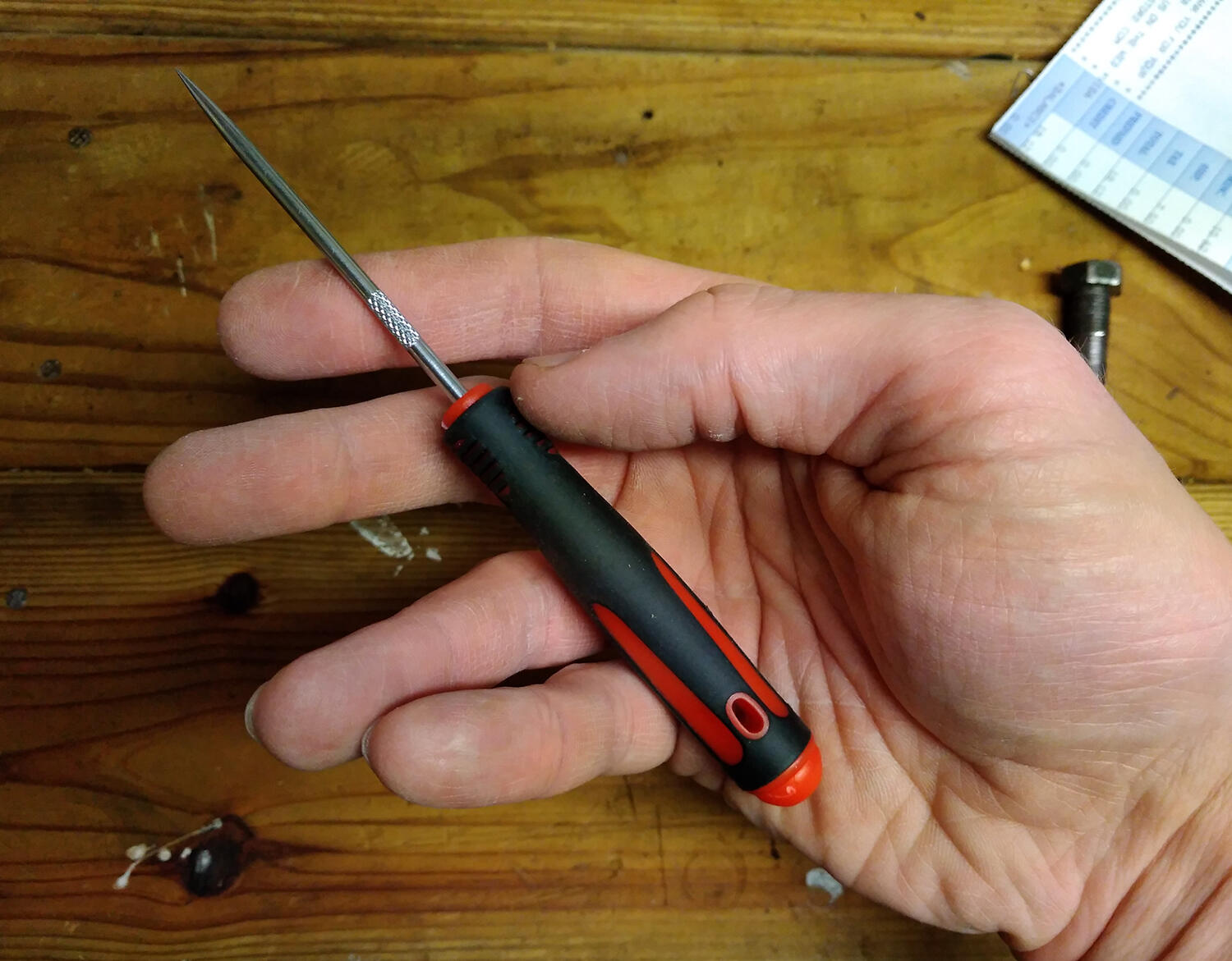

and used the pick to find the holes:
The center ones ended up being offset just a bit:
But everything went fine once the center screws were on, as expected:
Still probably need to replace those screws with a black version; they stick out like a sore thumb...
