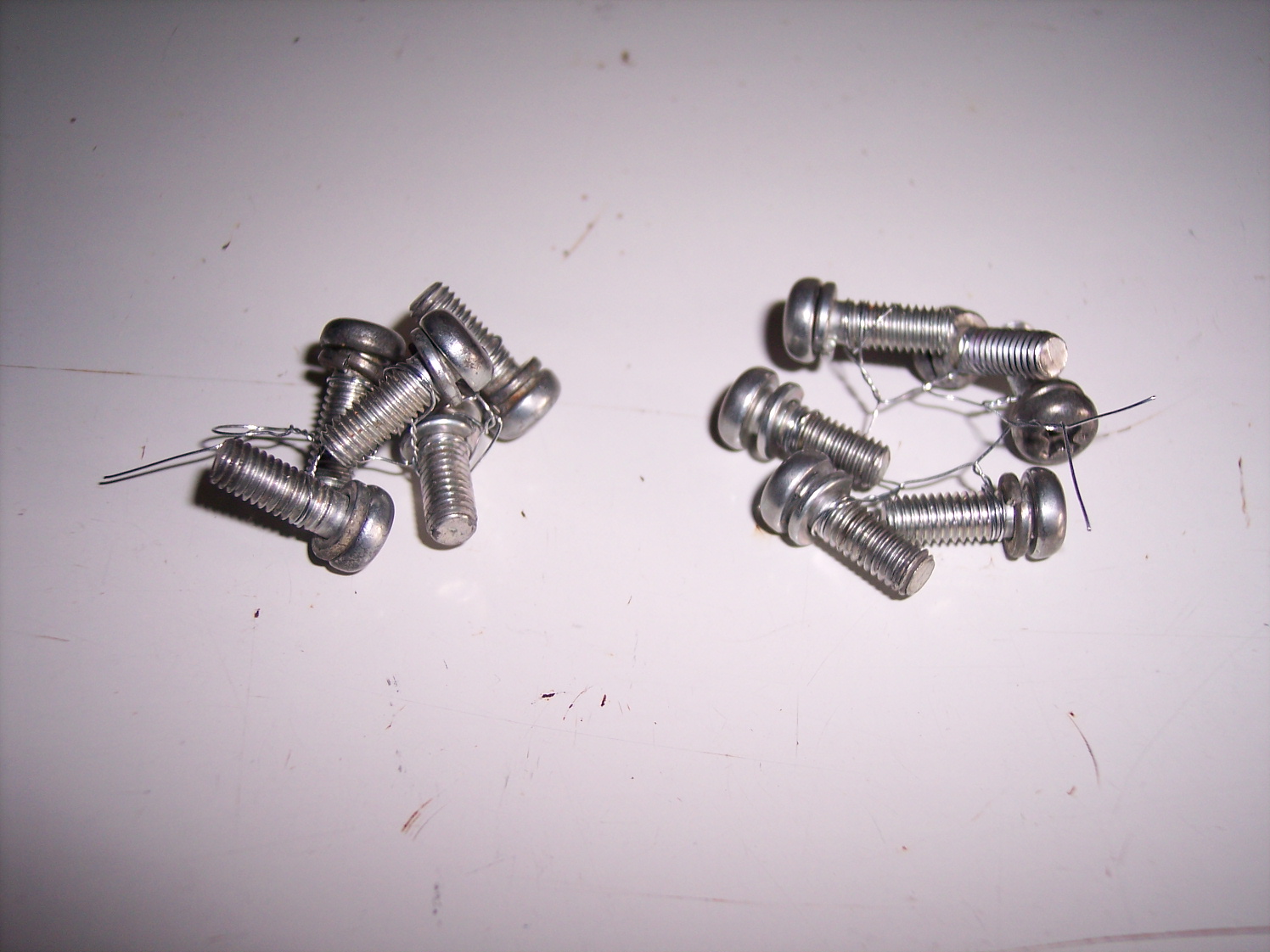

I've been using these folks for years with excellent results and I've referred a bunch of fellow Z owners to them with no complaints or problems.  I'm fortunate that they are on;y a 15 minute drive from my home. As to the problem of lost bits, that will occasionally happen but I have pretty well remedied that by stringing small stuff - nuts, washers, springs, ...etc. onto wire loops that I tightly close. I do something similar with small screws by wrapping a thin wire several times arounf the threads and twsting it to lock it closed then daisy-chain more screws and finish by closing the wire into a loop. They do only cash or check for individual accounts.

I love Texans so that might be a good option. I also did some wiring of small parts prior to plating. We'll see what I lose and what I don't

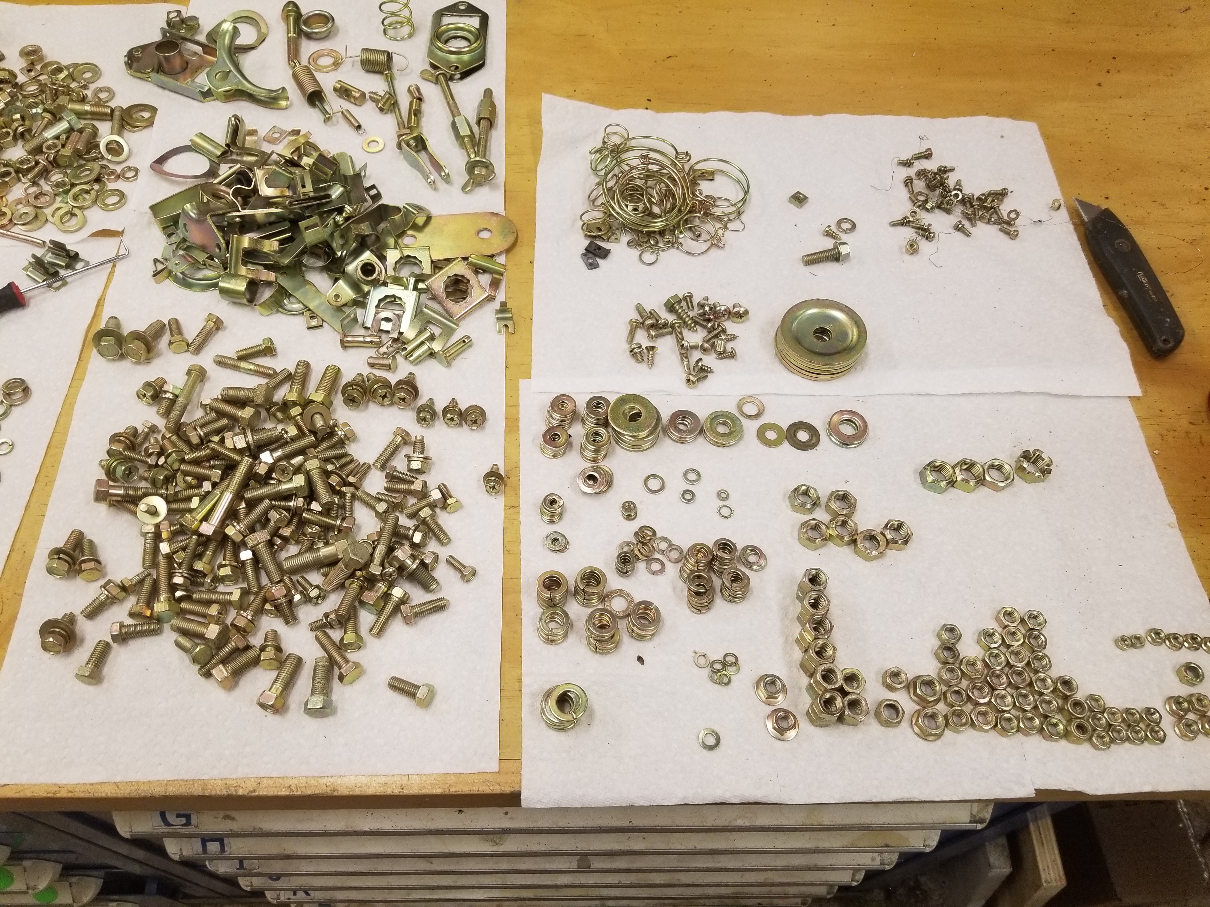

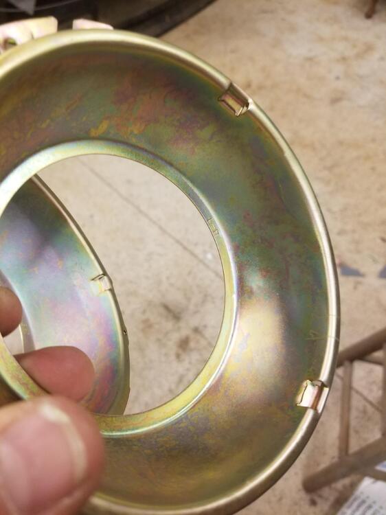

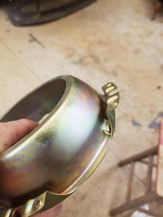

So I got the missing hardware. It looks ok...

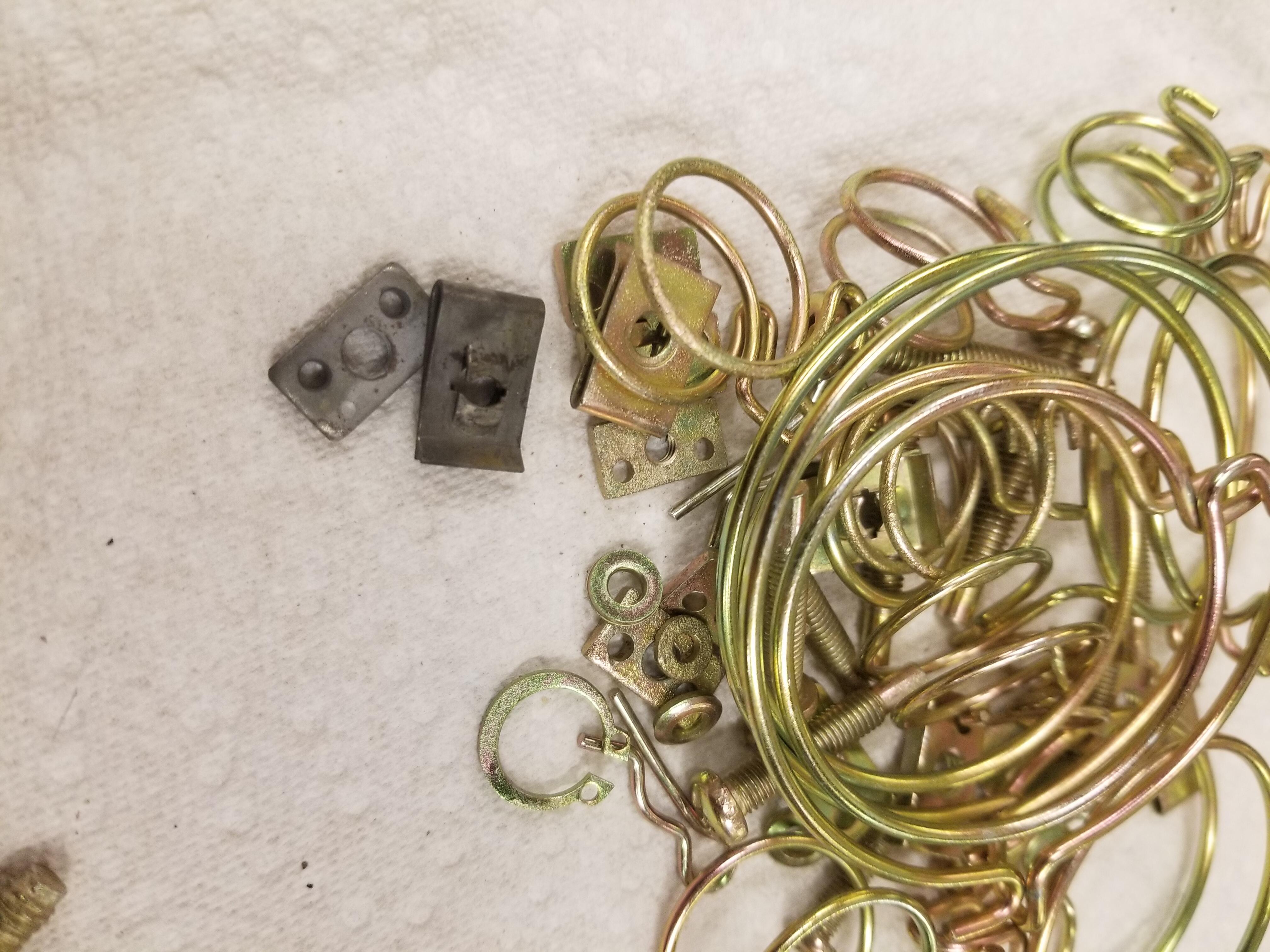

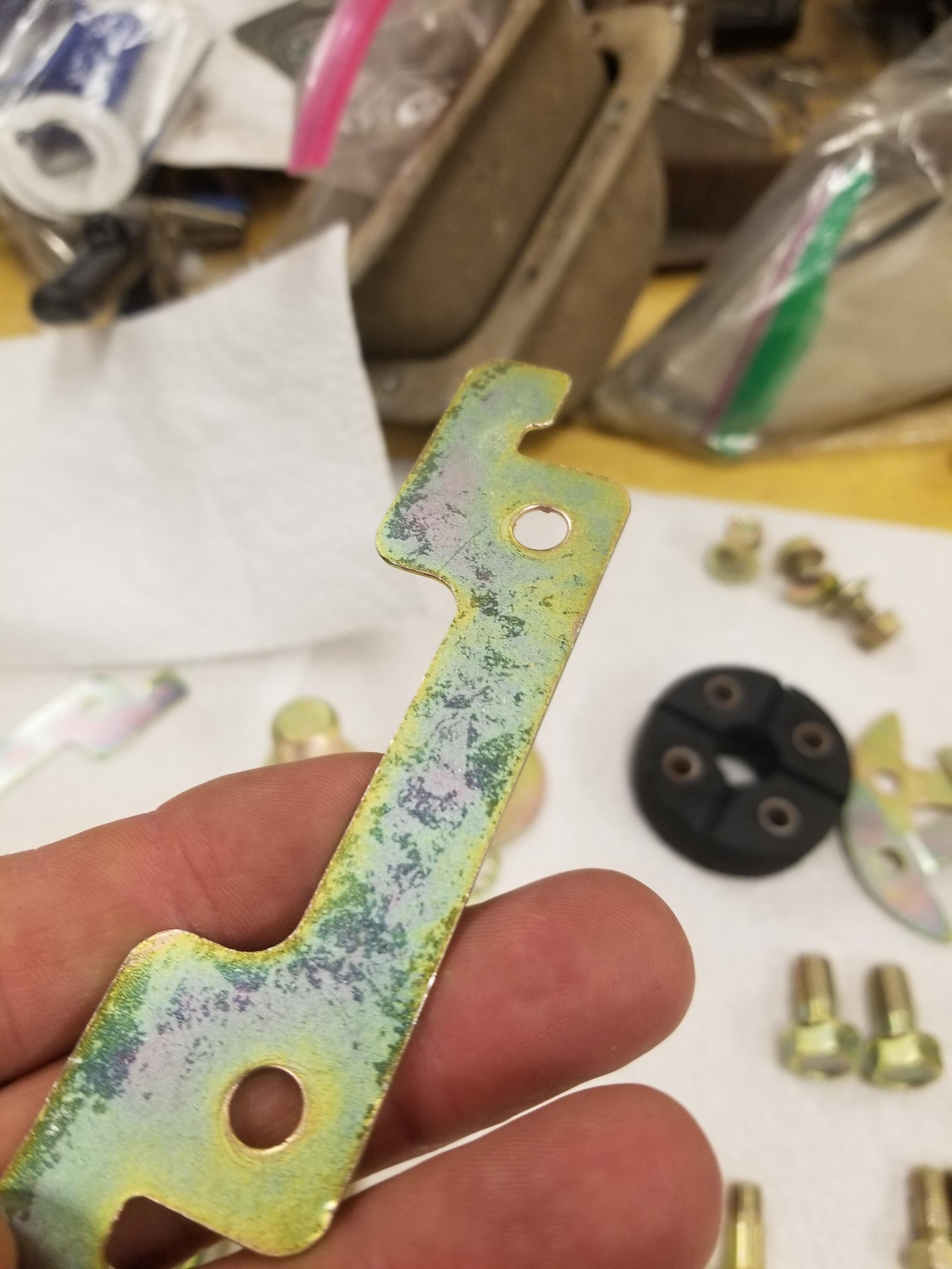

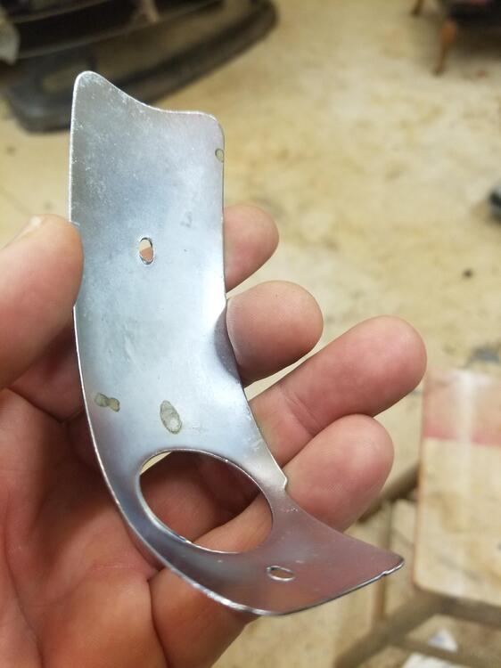

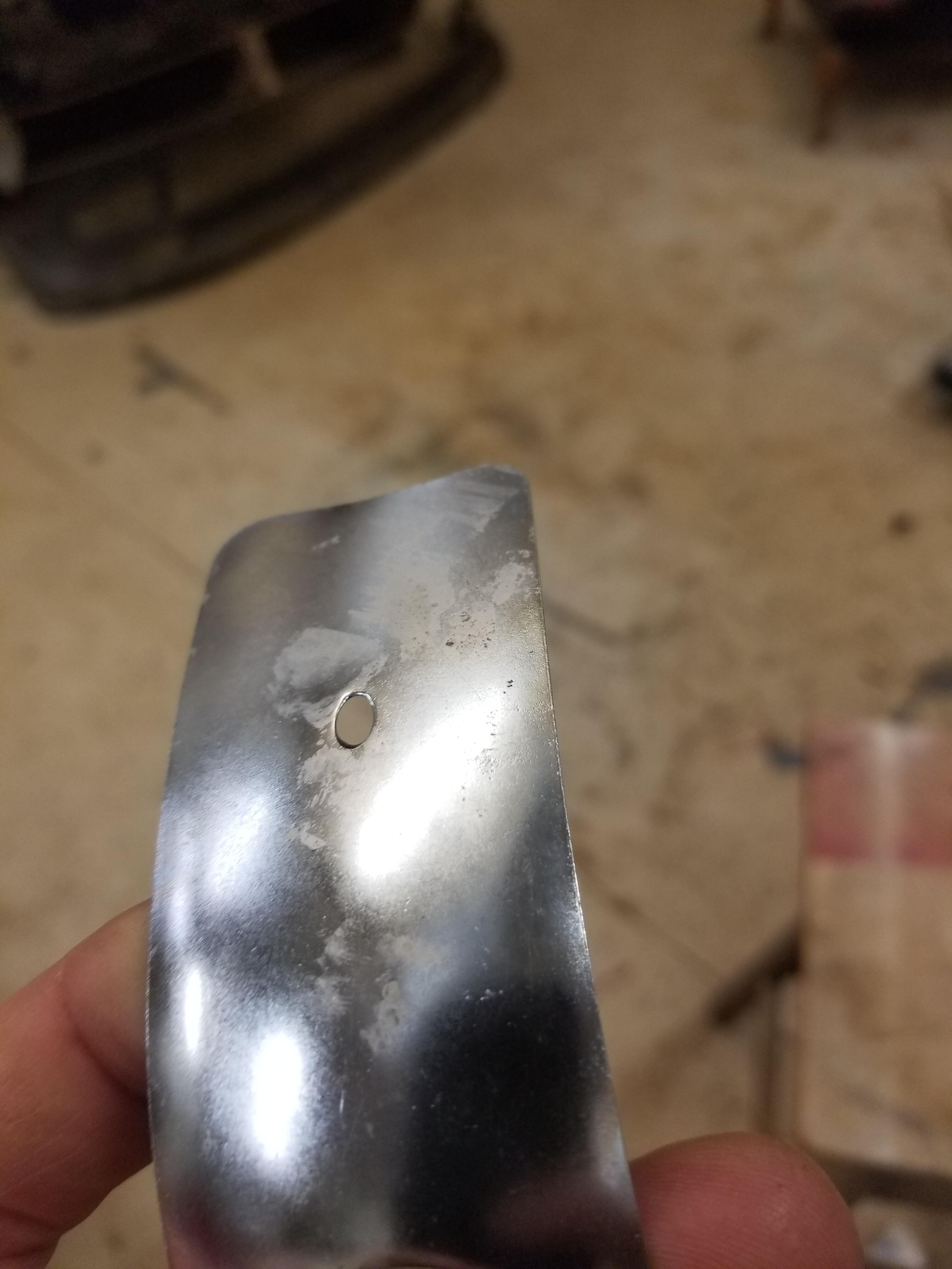

These bits didn't plate

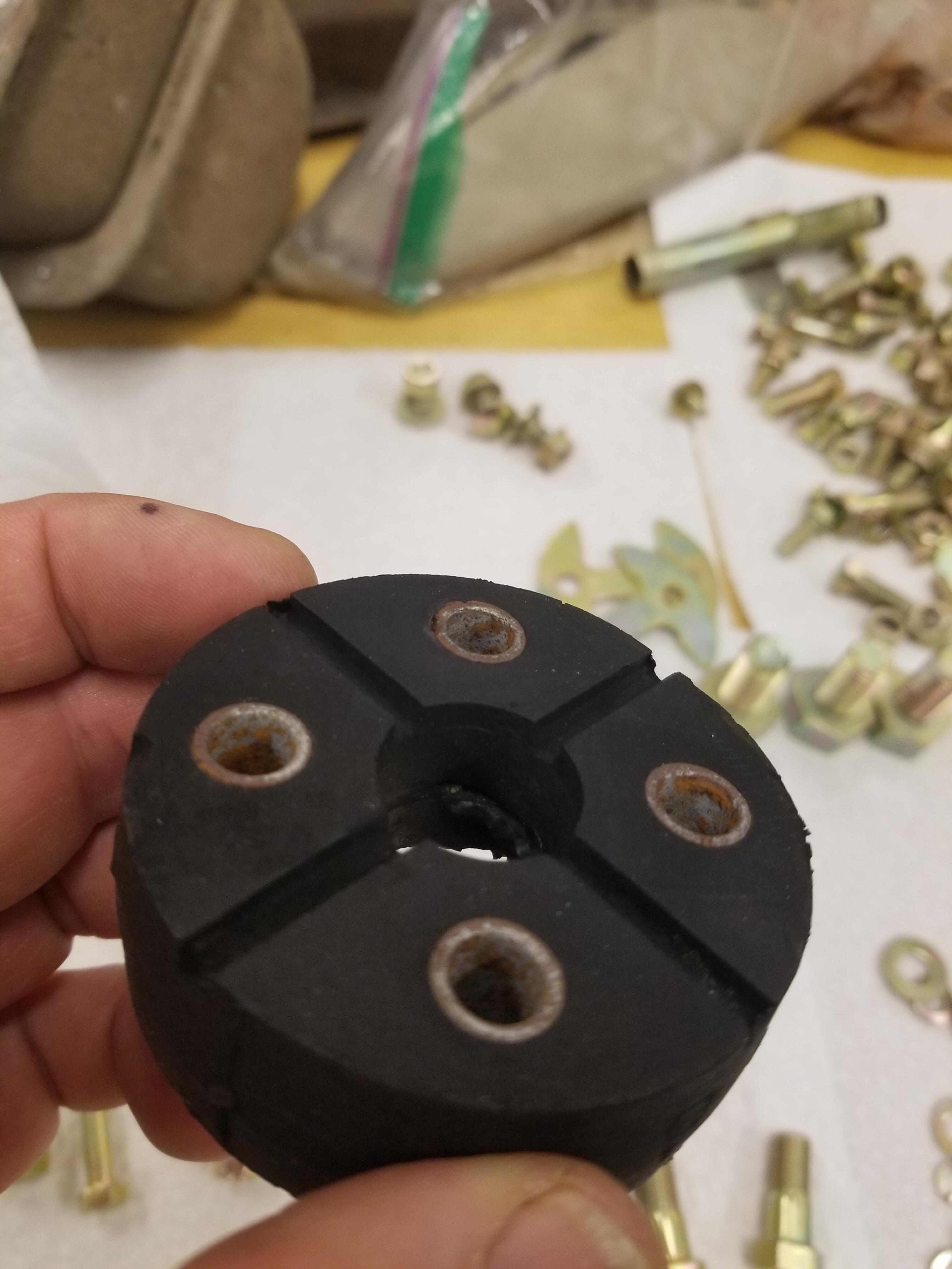

The steering coupler also didn't plate but might have if I had strung a wire through it. The finish on this was very motly

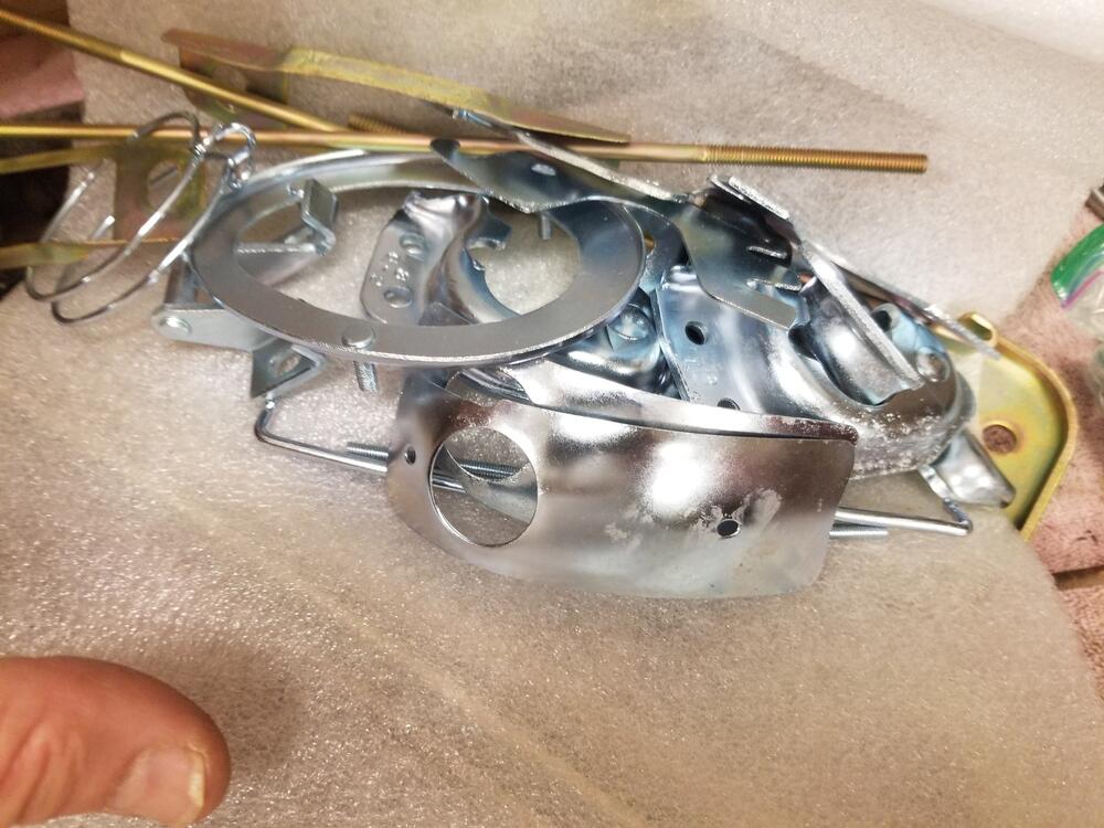

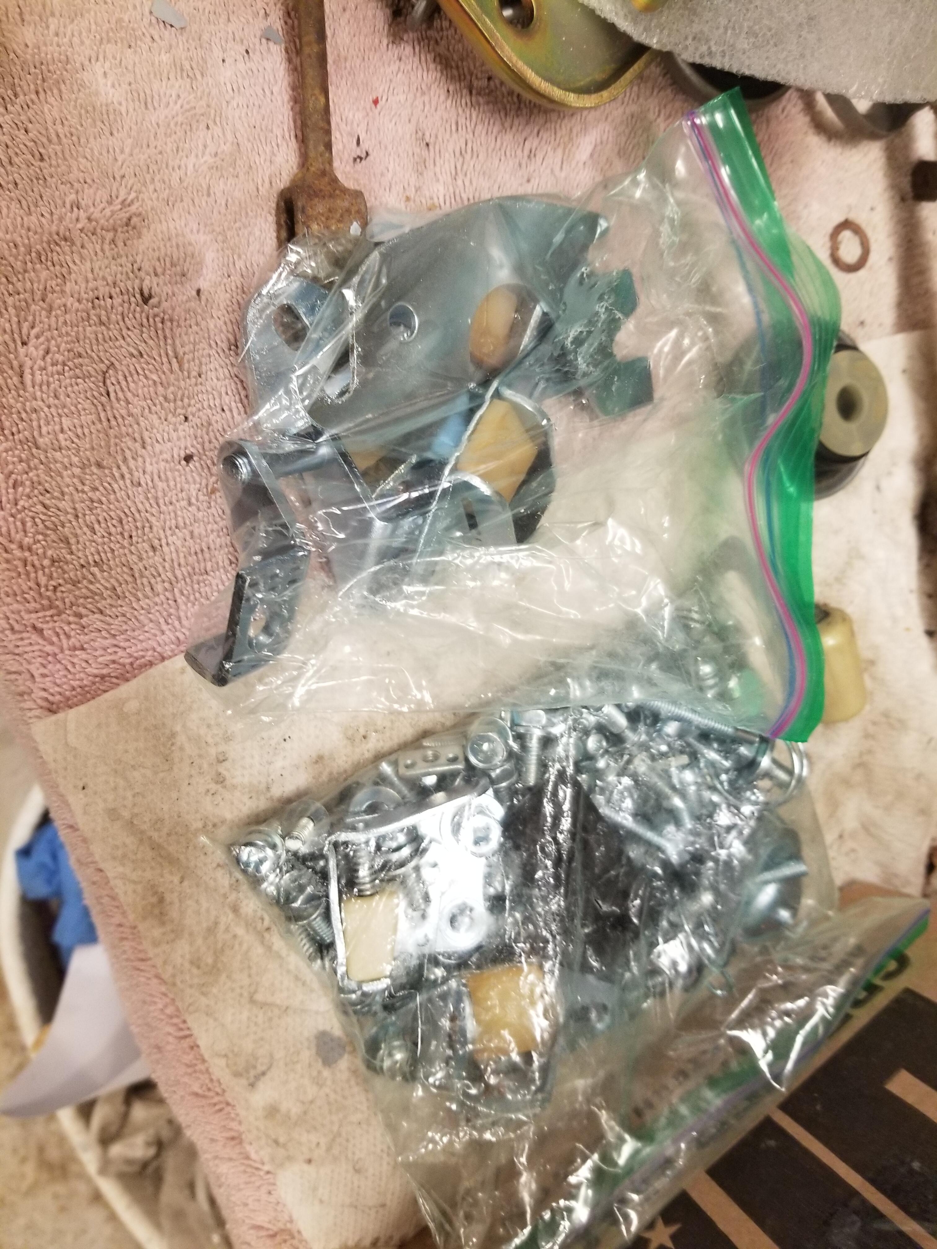

Some Clear zinc
The finish on this wasn't stellar

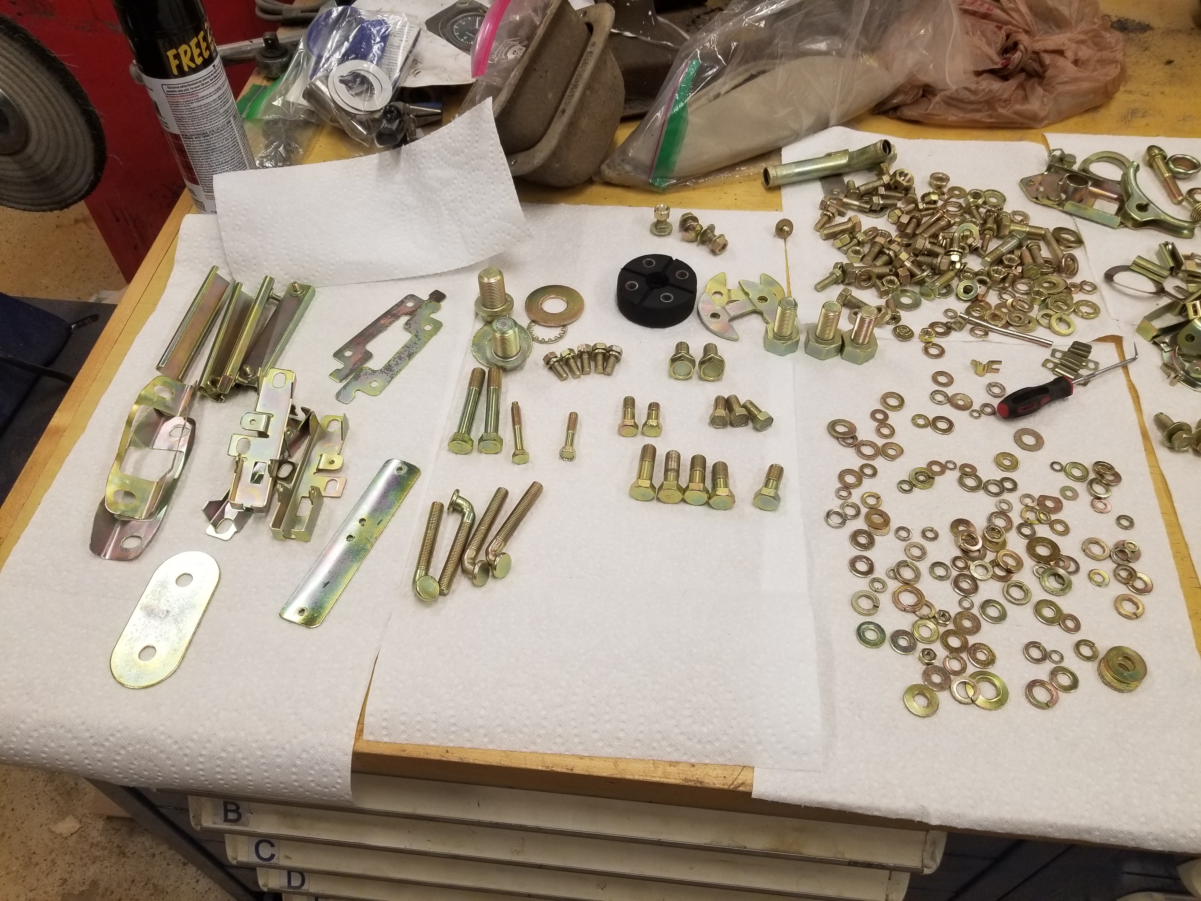

These also weren't as shiny or even as I would have hoped
Overall it's ok and much of the hardware looks pretty good. At this point I'm just glad they found the hardware. That would have been really painful to have lost all of that yellow hardware
The parts that don't look like they were plated...  I think they missed the vats completely. Looking at the rest of the stuff, I don't think it's possible they went through the same process and came out looking like that.
But glad they found the missing bits! That would have been no fun to replace all that!
I totally agree! I will probably try to replate some of that on my own and see what I get
