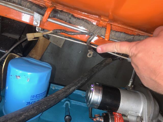

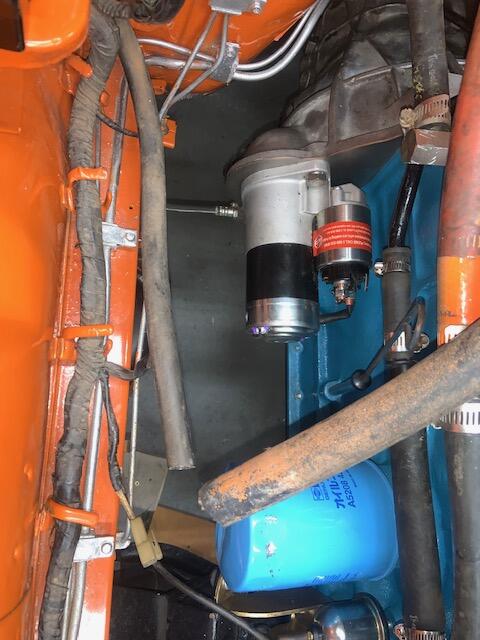

I am in the process of hooking many things back up. Any help & explanation where things go is appreciated. I will ask a couple problem areas at a time until i have worked my way area the engine connections remaining to be hooked up.

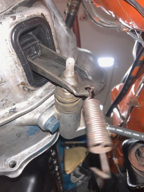

1. got the slave cylinder in, although rod is a little loose. Can seem to tell where the other end of the spring goes?
2. these hoses I am 95% sure go to the AC unit. Should i leave them alone or block them off (at least until i get a AC system installed)
3. The round connection wire i am pointing at. Any idea what it is or where it goes?

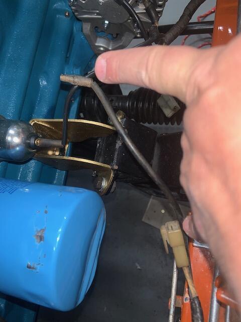

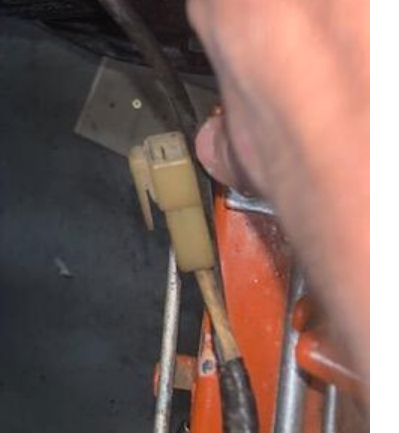

4. there are 2 plugs here. one my pinky is pointing at in bottom of image and other my finger is pointing at. I cant see any connections where they may go.... do they go to AC system as well?
many thanks

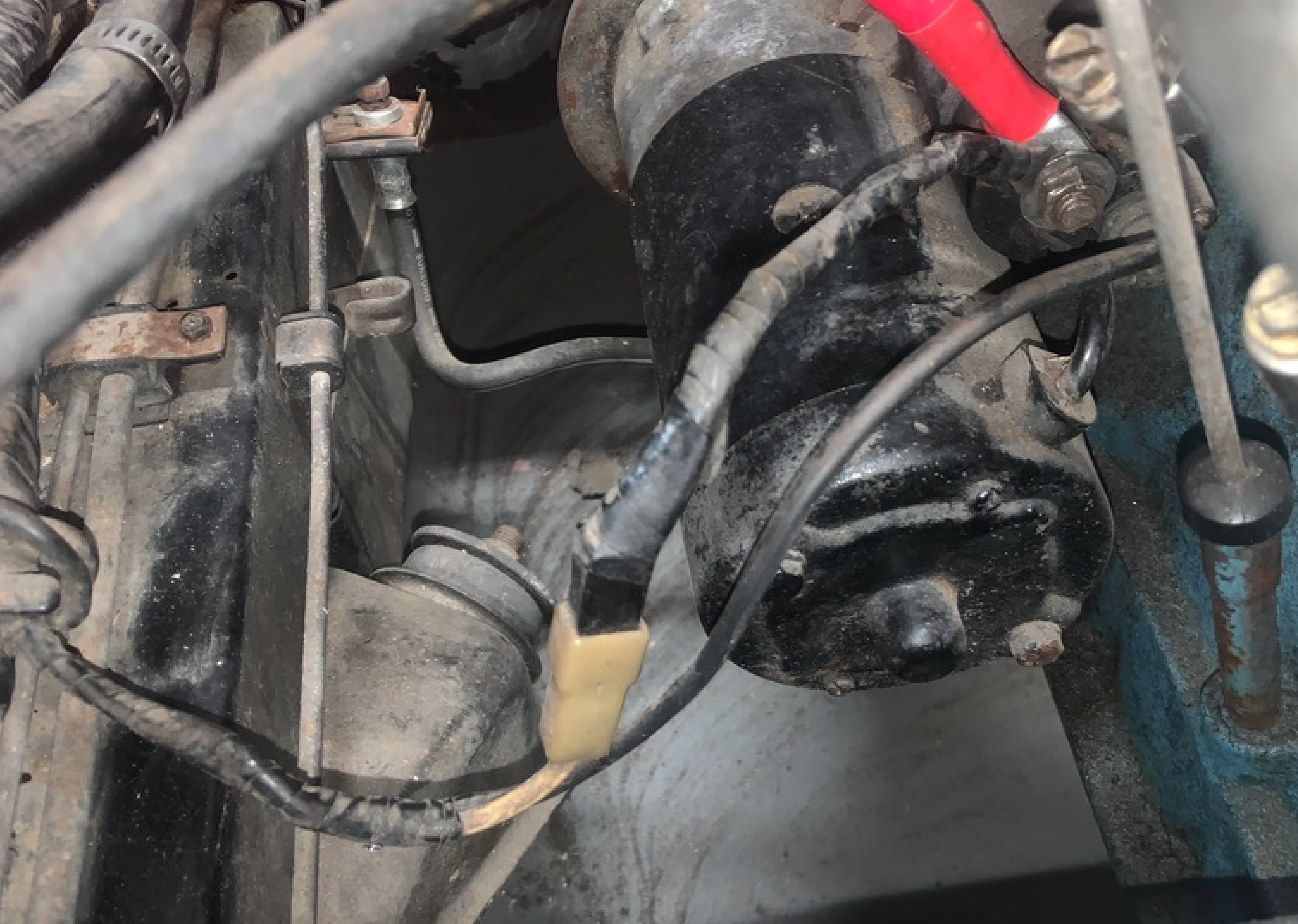

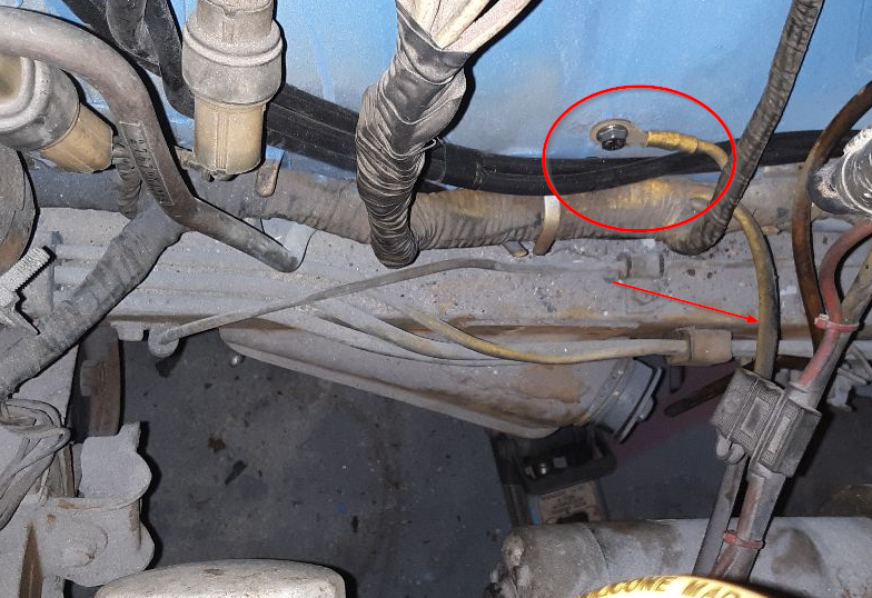

Yours is too blindingly clean for me to compare to mine:
I think your pinky wire (in your pic) corresponds to my wire with the red arrow, which goes to my starter.  But mine doesn't have that type connector on it.
The thickness and color of the wire makes me think it's alternator/fusible link related.
@Wally, @Zed Head is correct. I'm pretty sure the ring lug is a body ground. There should be a threaded hole in the fender nearby.
If you are considering re-using the AC lines, block them off. A better idea is to remove the AC stuff completely if you're not hooking it up and get a better setup when you do want AC.
For the bottom photo, you need to give a wire color. In other words, pull down the protective sheath, clean the wire, and report the colors.
many thanks
The loose end of the spring can be hooked around the steel fitting on the clutch hydraulic hose.
Did you cut the A/C hoses? If so, why? They cannot be spliced back together, and you will need to replace them with new.
The ring terminal should be a chassis ground.
The other wire, I’m not sure.

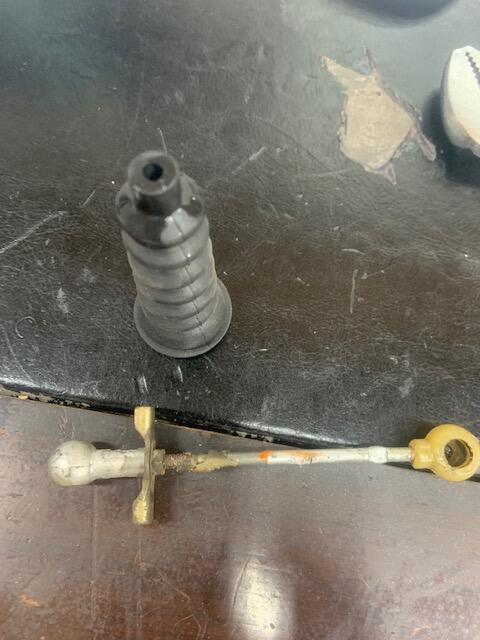

thanks for all comments above. working my way through them. in meantime another quick question (i know its not an electric one..)
Does one end pull of or unscrew to put a new boot on? I am REALLY nervous about putting force on it and cracking or breaking it.
I did that not too long ago, and I think I unscrewed one end to put on the boot, but wouldn't swear to it.
The brass "T" thing is essentially a lock nut. Break it loose and the plastic head then unscrews. unscrew the lock nut piece as well, install the boot and reassemble. Clean up as desired.
thanks all!! for the last image i found another image showing where it is to go (starter). Just gotta find the female plug or jerry rig using a connector and electrical tape. BUt at least i know where its going.

In your "want to buy" ad, I provided you with links where you could buy a proper fusible link. I advise you not to jury rig a fix. If you do not use a fusible link, you risk an electrical fire that could burn up your car.
