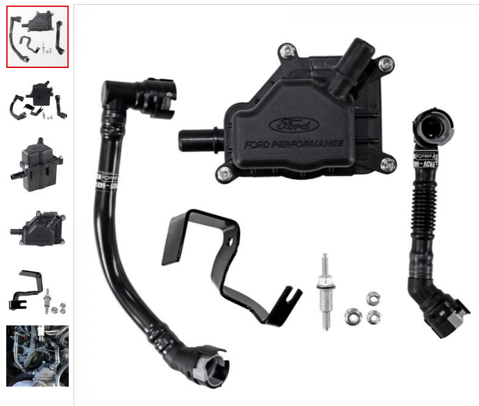

July 30, 20214 yr comment_626009 On 7/26/2021 at 10:26 PM, Ownallday said: fume up the cabin slightly If you want to avoid the fumes you'll have to run a closed system, like a PCV. So any vents under the hood won't work. Or you could run the vents to an area that is clear of the cabin, maybe all the way back the rear of the car. If you run a closed system it needs to be properly balanced so that you don't have high air flow through the crankcase pulling suspended oil out before it can settle. I've been hanging out on a Ford truck site and people get on there all the time talking about how they're pulling like a pint of oil a week in to their catch cans. Maintaining their catch cans turns in to a full time job. I think that the catch can system designers might be designing their system to pull a lot of oil. The people that have them want to see stuff in the can. If it's empty they'll think the can is not working. Even Ford has jumped in to the "upgrade" game but their system has to meet the PCV needs. It's more complex than the typical shiny metal can aftermarket systems. Interesting to study. Read the hype in the a copy. https://www.cjponyparts.com/ford-performance-oil-air-separator-kit-passenger-side-mustang-5-0l-2018-2021/p/M6766A50A/ https://www.cjponyparts.com/ford-performance-oil-air-separator-kit-gt350-gt350r-2015-2020/p/M6766A50K/ https://www.cjponyparts.com/catalogsearch/result/?q=+Ford+Performance+Oil-Air+Separator Link to comment https://www.classiczcars.com/forums/topic/65647-how-do-you-properly-run-an-oil-catch-can/?&page=4#findComment-626009 Share on other sites More sharing options...
