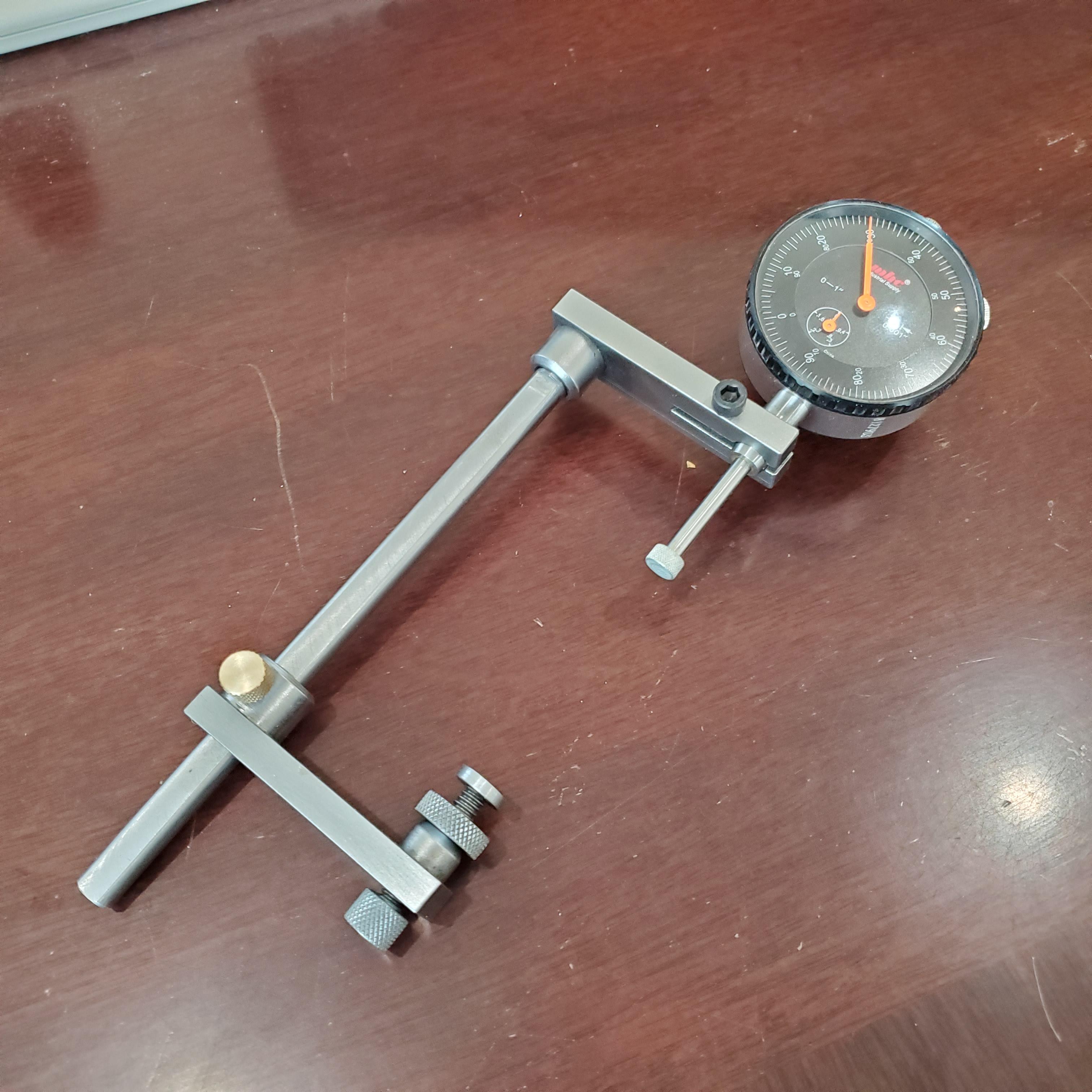

The first time I really took the time (about two days IIRC) to make something elegant was for a bolt stretch gauge - everything except the dial indicator and SHCS.  I wanted to see if I could do it.

OK, I have to ask... What is the purpose of a bolt stretch gauge? Please don't say to measure the stretch of a bolt. A little background please on this cool-looking tool.

Torque to yield bolts require that how much the fastener stretches is known. Once the bolt reaches the maximum allowable stretch, it must be discarded and replaced.
So yes, you are measuring how much the bolt stretches.
Part of the reason for owning a Z and subscribing to this site is to learn something now and then. Fel-Pro does a good job of explaining the concept and included an example for a Subaru where the head bolts had to be tightened in two steps, loosened in two steps, and then tightened in two to three steps in order to get to the "yield zone".
https://www.felpro.com/technical/tecblogs/proper-installation-use-t-t-y-bolts.html

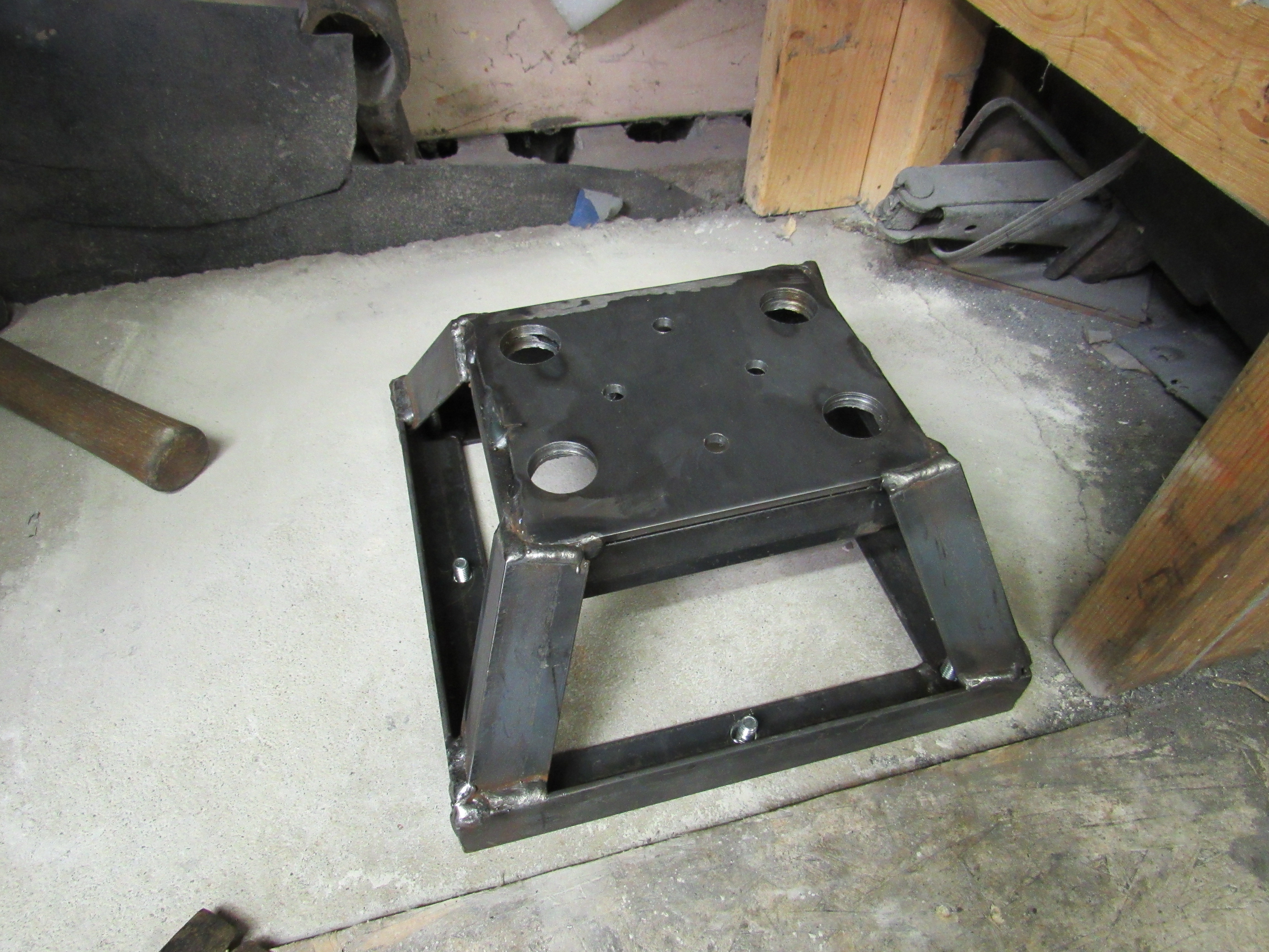

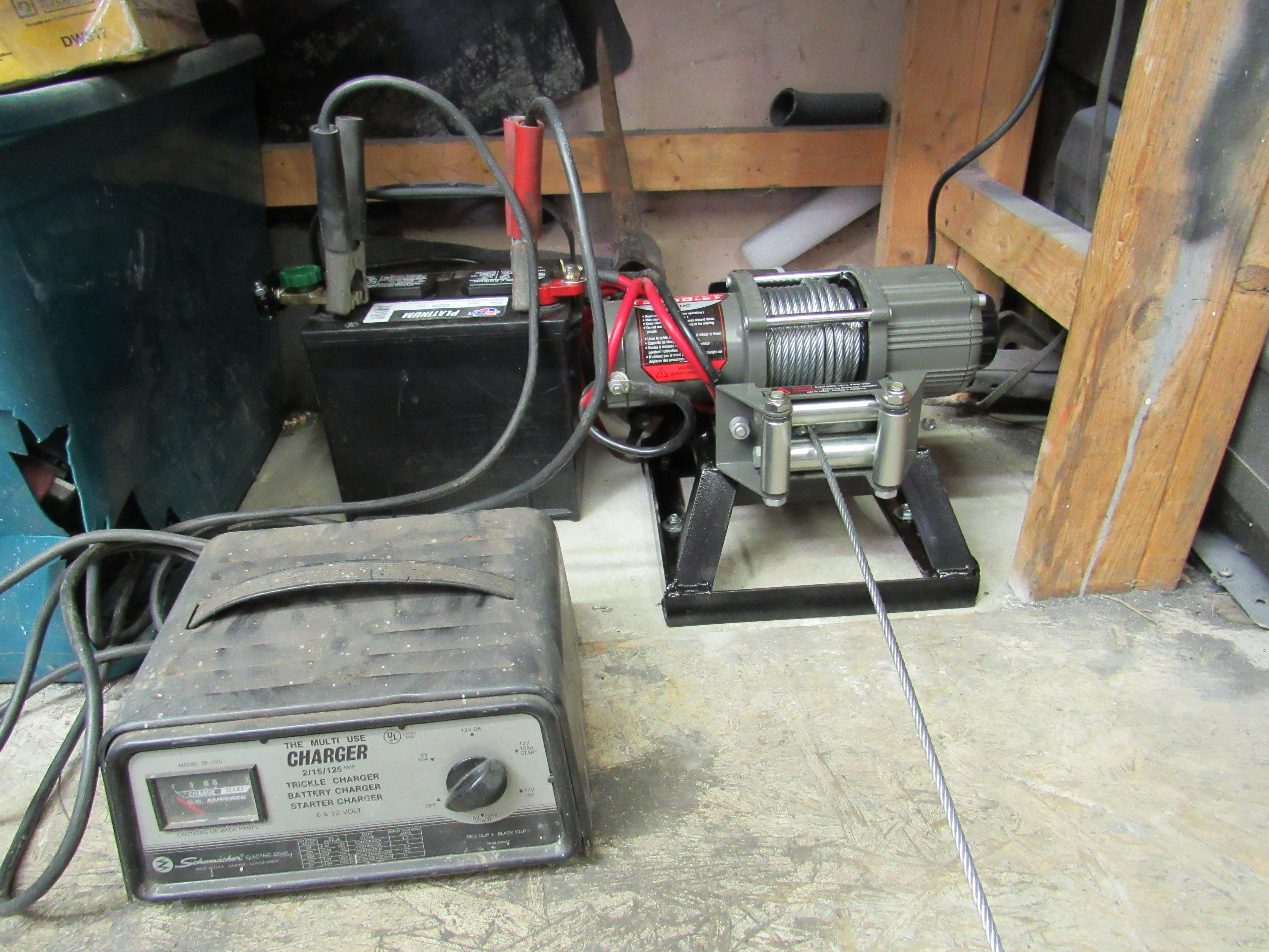

I don't know if this qualifies as a tool but it's going to be very useful to me, My shop has a bit of a slope leading up to it.  A car that is running can just drive in but most of the cars that come in can't do it under their own power so I tow them up with the lawn tractor but have to stop 10-15 ft. away, then hook up tow straps and pull the car in with a come-along. A long and tiresome job, so I picked up a 12v 3,500 lb winch, built a base for it, hook it up to a battery, hook the battery charger up to it and turn it to Start. Lots of juice flowing and pull the car into the garage in seconds. I love it! Less work for my old back.
I have exactly the same issue with an approach slope to my garage... although the frequency of my new-project arrivals pales in comparison with GK's.  I bought a hand-crank winch and bolted it to my workbench (which is bolted to the back wall of my garage).  Motorized would have been better, but it was certainly an improvement over a come-along
I also mounted a winch. In my case, I sometimes need to pull my car in and onto my 4-post lift. Pushing it up the lift ramps was too difficult so I attached a box hitch receiver at the other end of the lift. I have a small 12v winch that is welded to a hitch adapter. The winch can then be attached to the lift to pull my Z onto the lift. The winch can also attach to my Chevy Volt or my garden tractor with their box hitch receiver and run off their battery.
I thought I was so original with my idea. I guess not.
