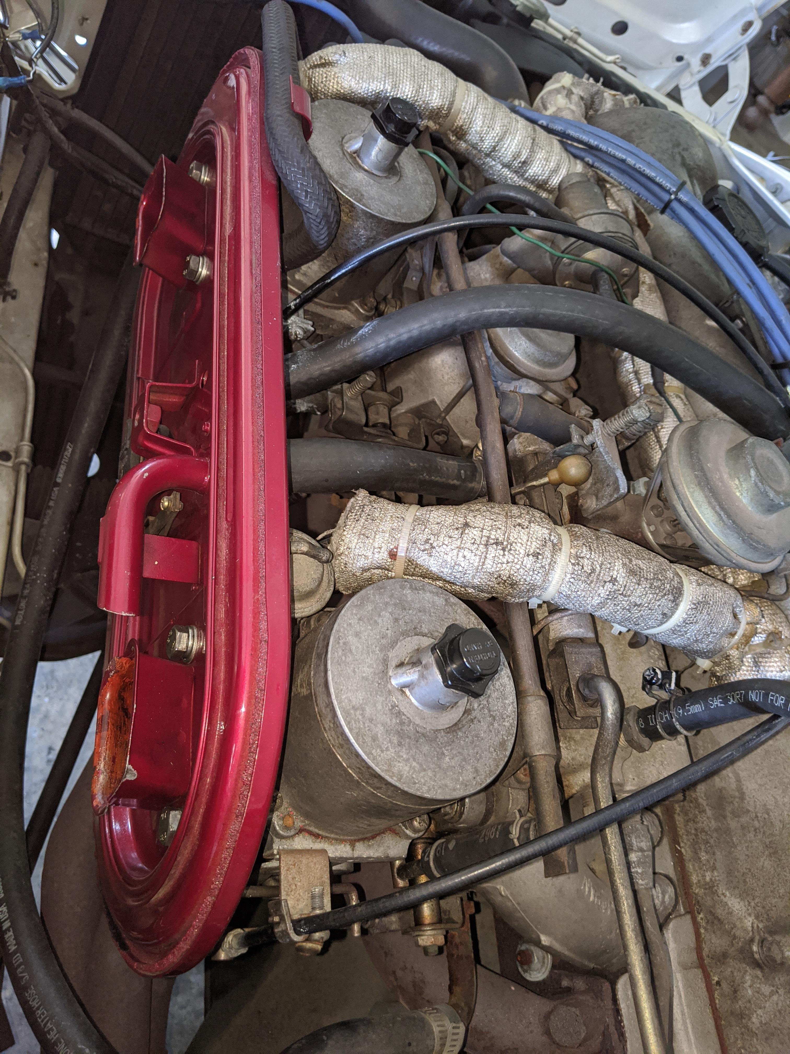

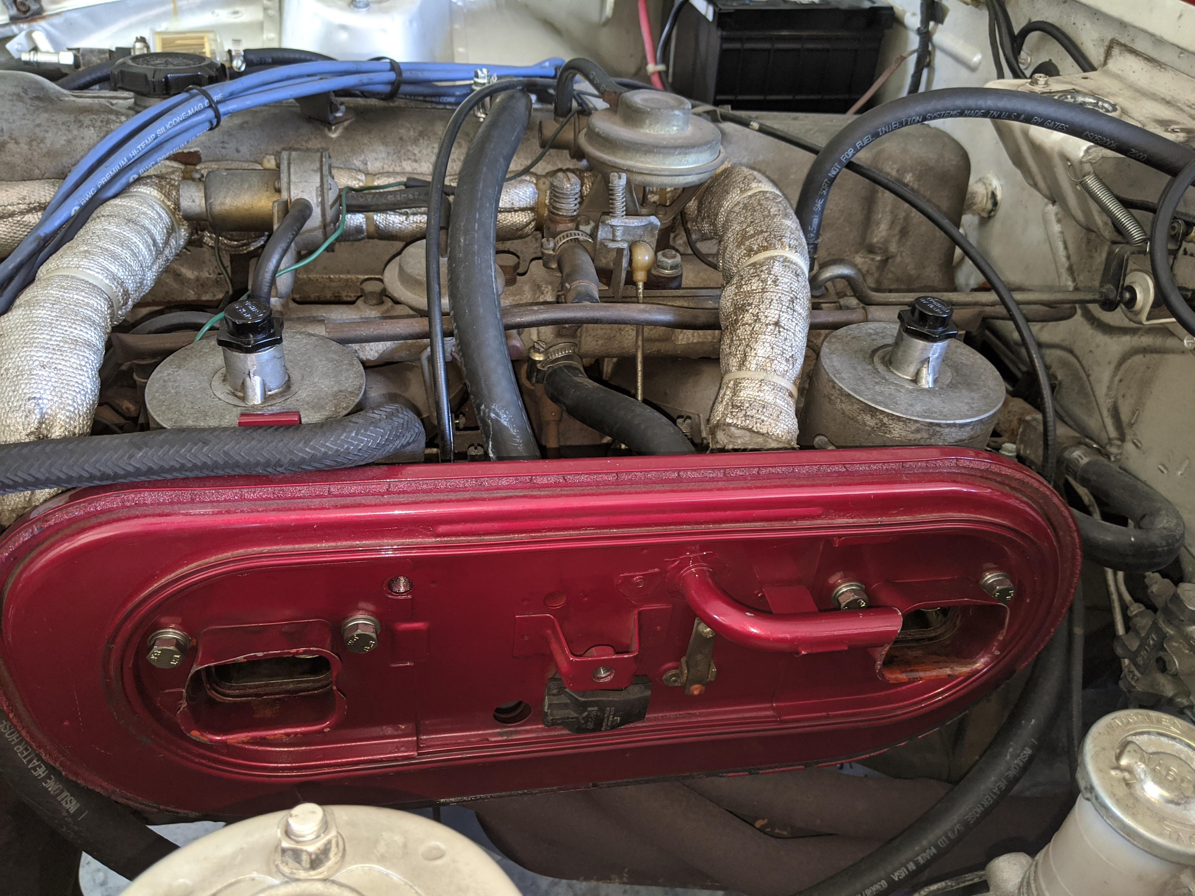

May 4, 20204 yr Author comment_598797 A couple of pics showing what I'm inheriting. Build date is 10/72. Link to comment https://www.classiczcars.com/forums/topic/63963-73-240z-flat-top-carbs-dilemma/#findComment-598797 Share on other sites More sharing options...
May 4, 20204 yr comment_598813 I drove a '73 with flat tops for about 20 years until it rusted to death. I found the flat tops to be very reliable and required little to no attention. Once tuned they will just keep going. Link to comment https://www.classiczcars.com/forums/topic/63963-73-240z-flat-top-carbs-dilemma/#findComment-598813 Share on other sites More sharing options...
