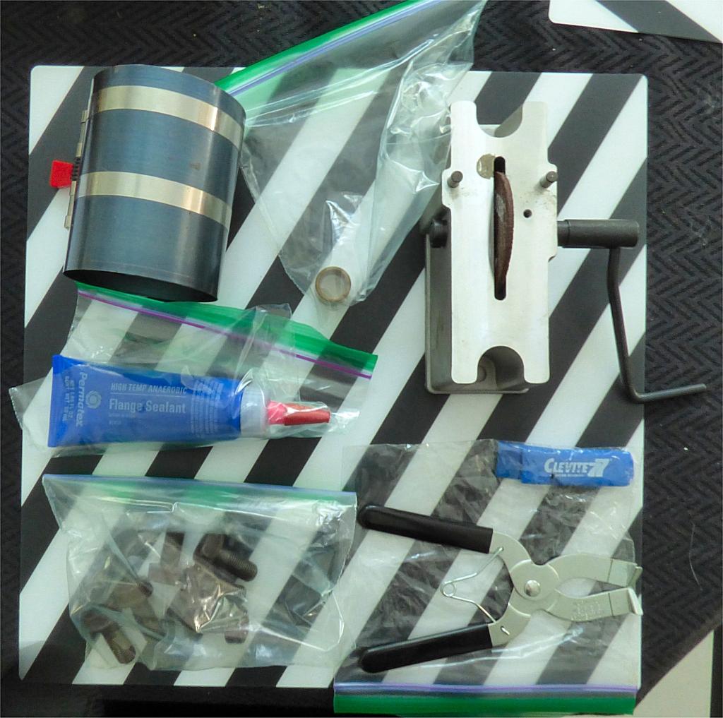

You have a pair of piston ring pliers or a ring gap grinder? I don't have that stuff and I'll probably only ever use them this once.
And I'd love to fight over another lunch bill.  My house is your house!
Yup. PR pliers, ring grinder and piston installing ring clamp thing. I'll also send the anaerobic sealant for the main side bearings.
Awesome!! There are three of us working on these motors at the same time and I know none of us have that stuff.   @GGRIII  @Av8ferg
I should post my parts list and tool needs...
You are also getting 2 Clevite Rod Bolt Condoms.  Let me know if you need a formal ring land cleaning tool?  It is a bit clunky. I prefer using the old rings (and my ultrasonic cleaner)
Engine Builders Unite!
@240260280 What do you use the flange Sealant for?
Rear main bearing cap seals...left/right?
Thanks!
