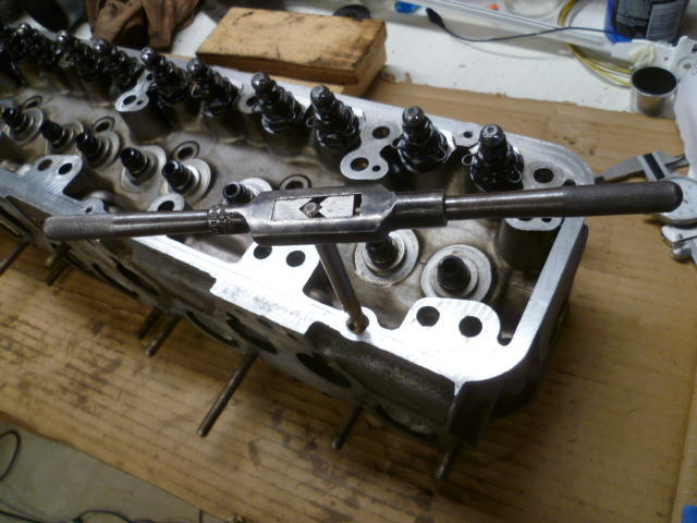

I got a couple hours in the shop today. Here's what I started with. You can't really tell from this pic but that hole goes in on somewhat of an angle. It's not square to the top surface. It cuts in towards the center of the head:
First I bored out the hole (hopefully close to the correct location) to about as large as I was comfortable with. Here you can clearly see the off-center hole that punctured down into the water jacket below:
Then once that was done, I threaded that hole:
And made a threaded insert on the lathe:
Here's a test fit:
I didn't glue the insert in yet. I'll do that tomorrow with a clear head. And then after I glue it in, I'll cut off the excess and machine flat.
Here's a test fit:
