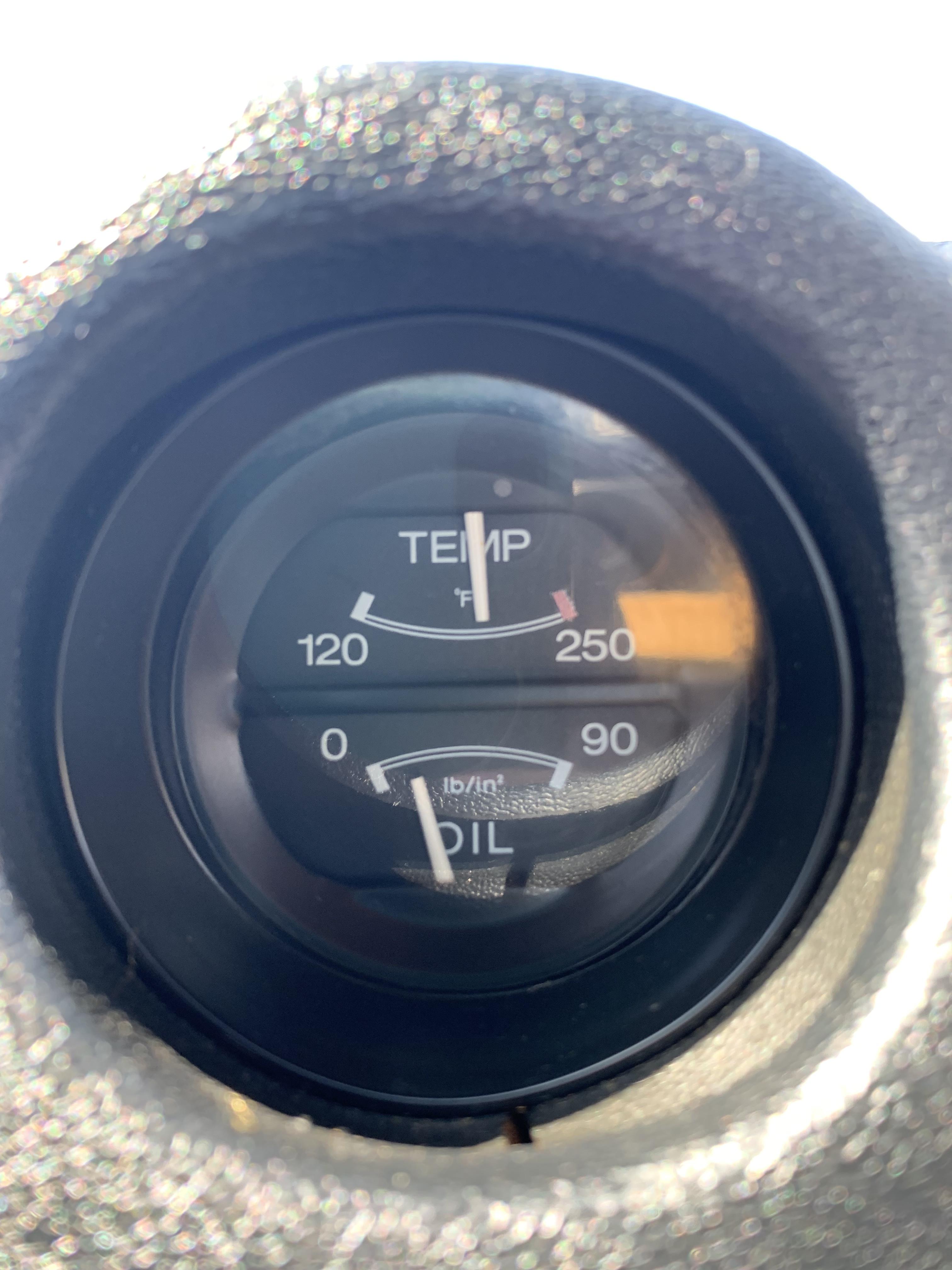

Hi Everyone,
I recently just did the valve adjustment and tinning adjustment and the car is running so much better!
I did notice that the Z is consistently running past the halfway point these days. It stays exactly around where the needle is on the photo. The radiator has no leaks. Is it time to replace the radiator?
put a cooking thermos in the rad start the car, let it warm up see what it reads, prob 185 looks fine. If the old rad looks good I would leave it, or get it rebuilt (new core) if it looks bad. a rad shop will charge you about 300$ maybe more. Lots of folks put those cheap China made alum one in there, I would not trust it. Would rather have a quality shop re do the old one.
