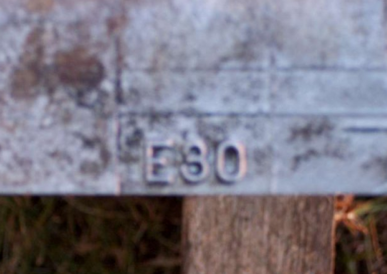

Should be letters and numbers cast in to the head up by the 1 and 2 plug holes.

The head ID is just between the #1 and #2 spark plug holes. Here is an E88:

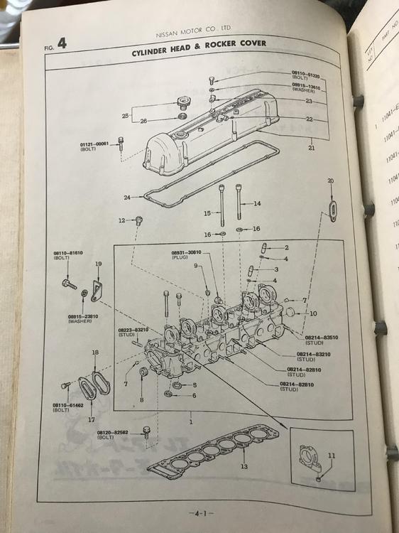

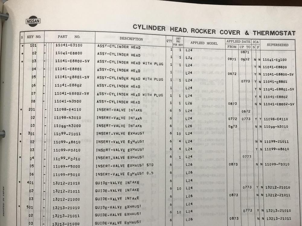

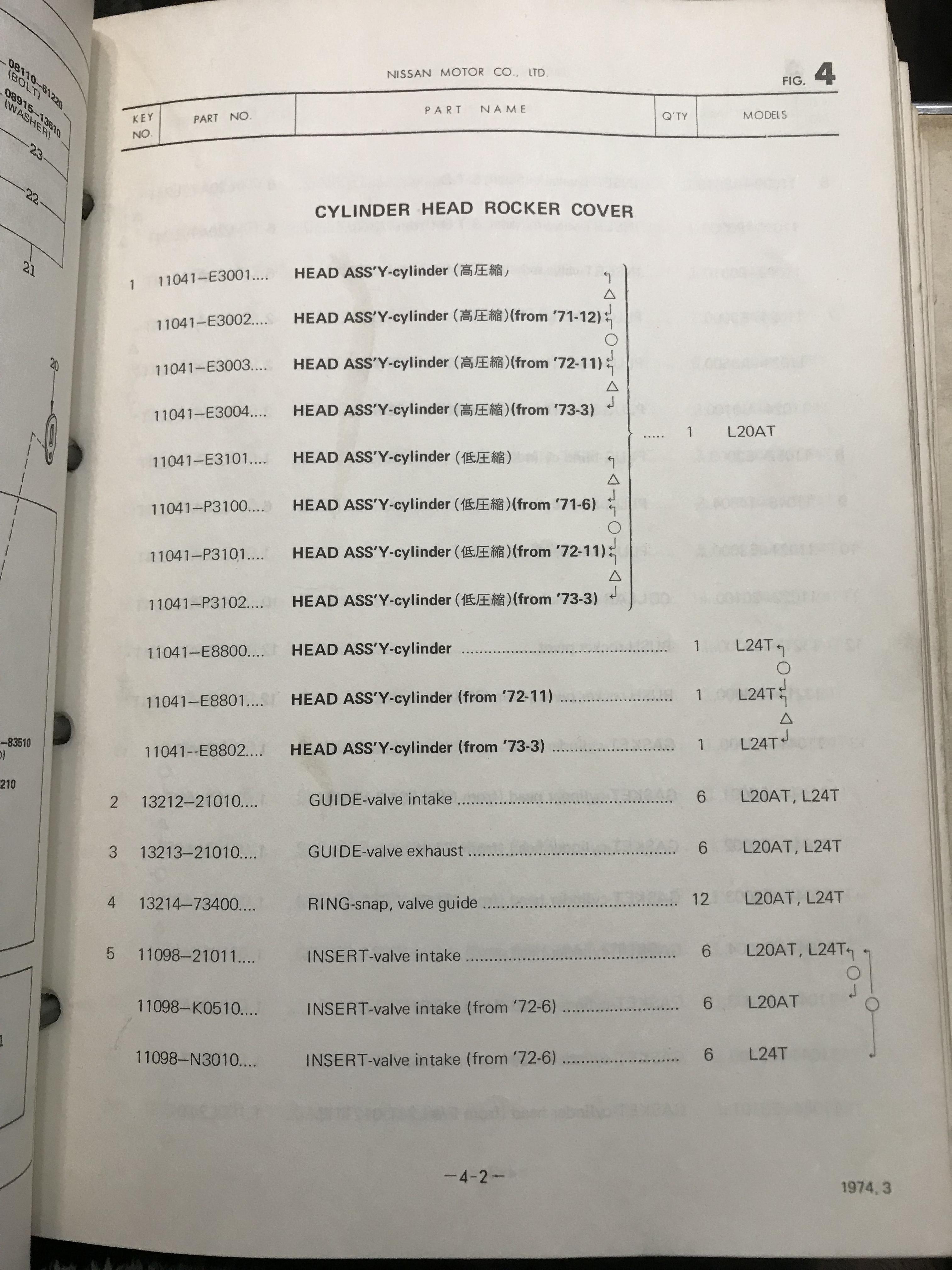

Hi Locke , I checked some parts catalog, what I found is E88 started from September 1971. This was when S30 series had got a new center console, new hub caps , etc . I haven’t seen cars around mid 1971 in person, so I can’t say the catalog is correct until I see some examples. As a side note , E31 and E88 were meant to be “ low octan / regular gasoline “ . E30 was meant to be “ high octane/ premium gasoline “ , and this was never used for Datsun 240Z and Fairlady 240Z series .
