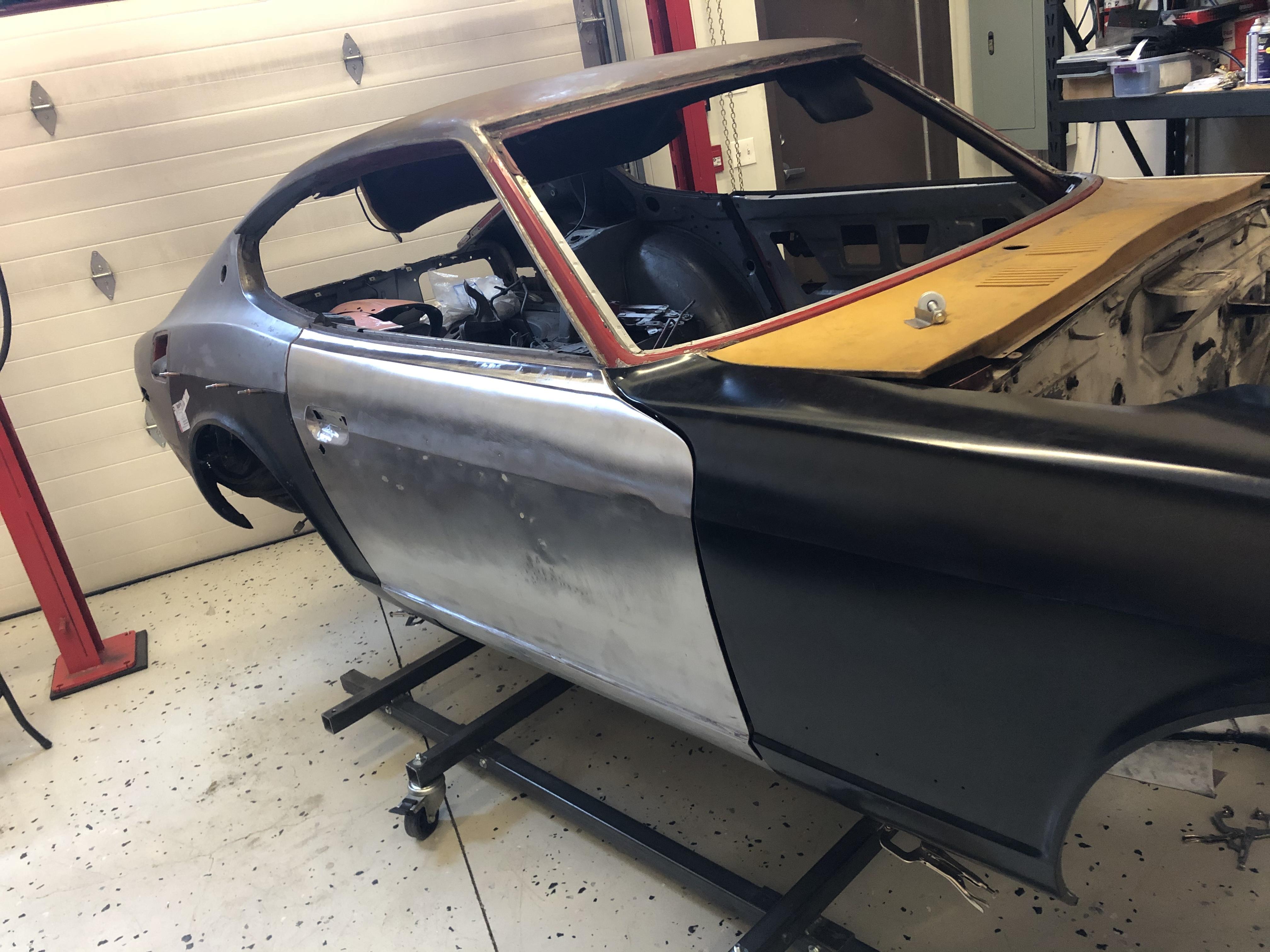

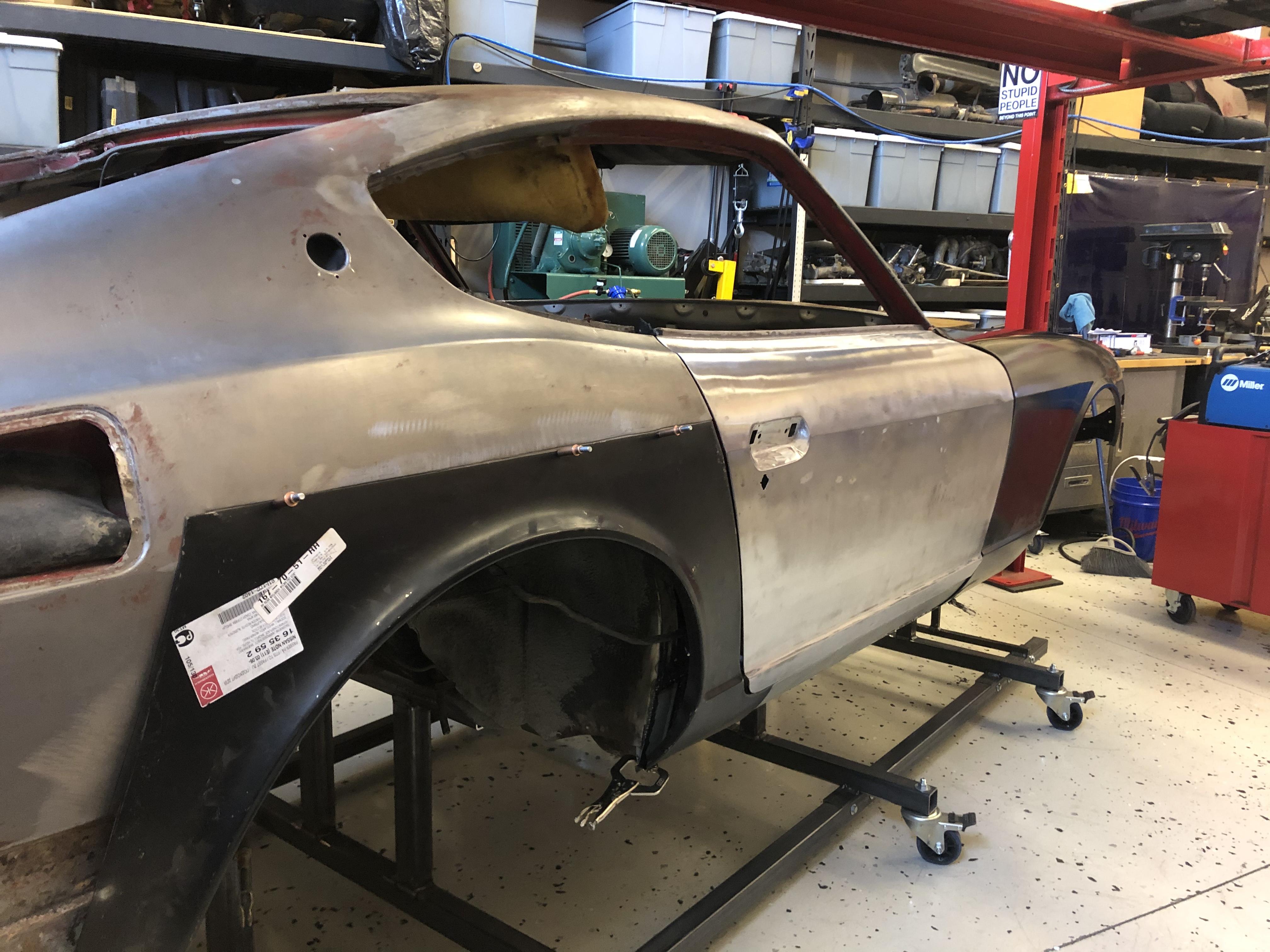

The outer rockers don't line up very well with the fender or the lower front edge of the door.  I am told this is a common problem with "later" TABCO pressings.

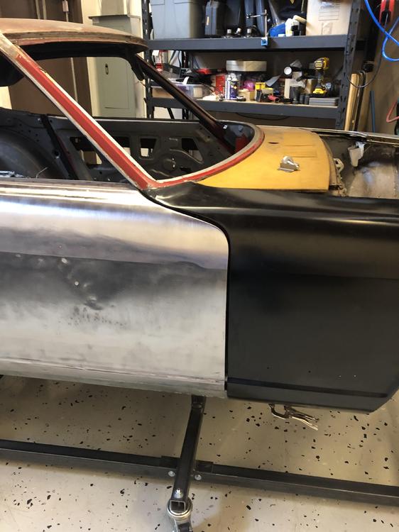

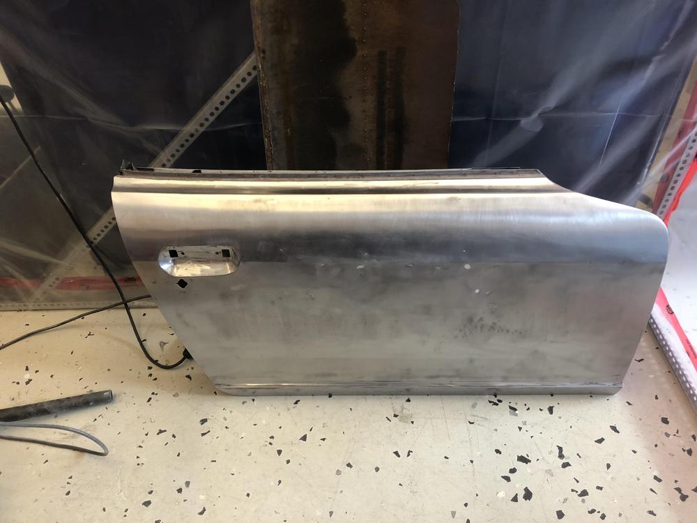

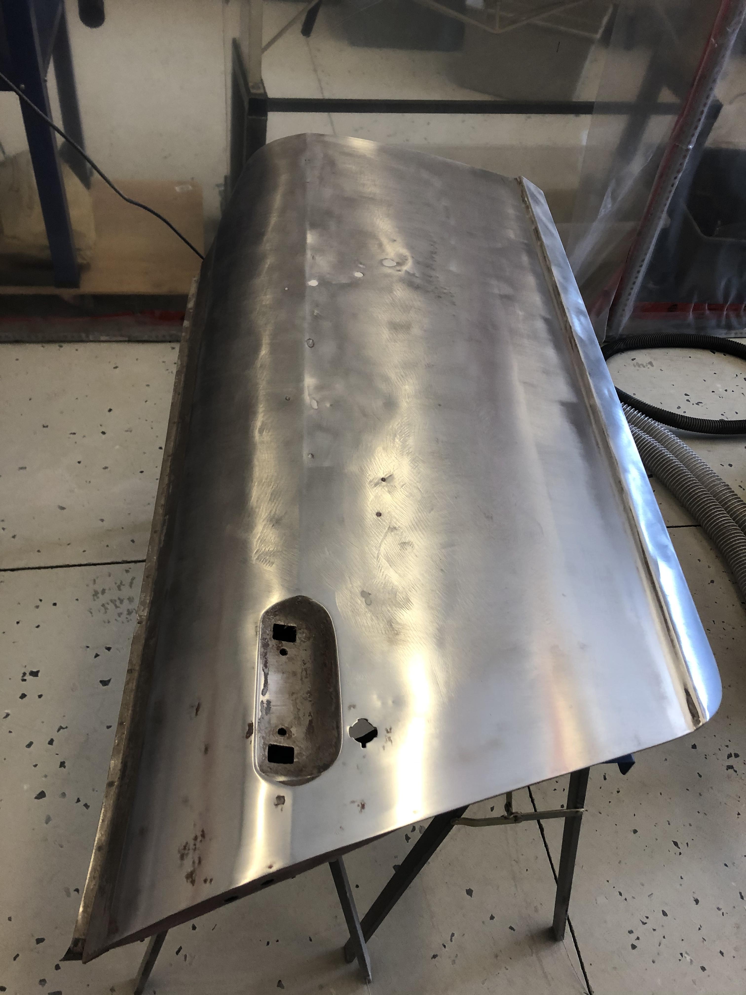

More Contour SCT testing - passenger door ....

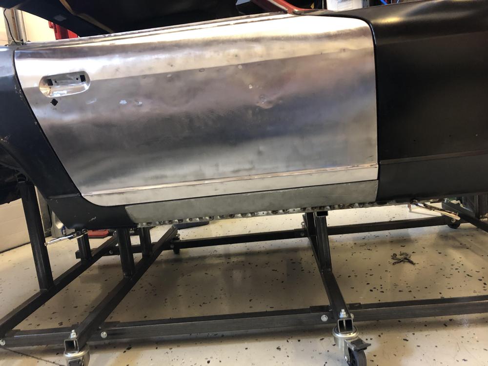

Again this door was repaired and heavily mudded by the PO.  I have better doors but let's see if this one is salvageable ....
5 minutes in ...
10 minutes.. tops ...another passing grade for the Contour SCT ...
It turns out to be a very solid door.  I would guess most of the damage is from the PO's prior Bondo repair ...
Not sure if I will end up using this door, but it would be a shame  to throw it out.  I might have a paintless dent repair guy look at it ...

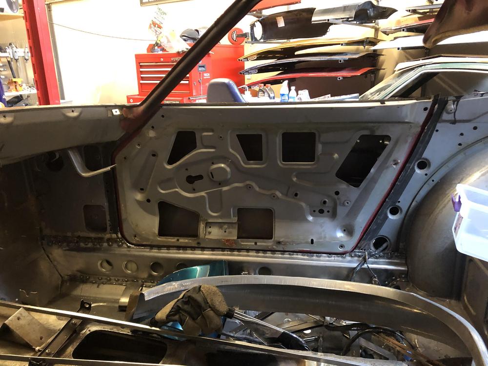

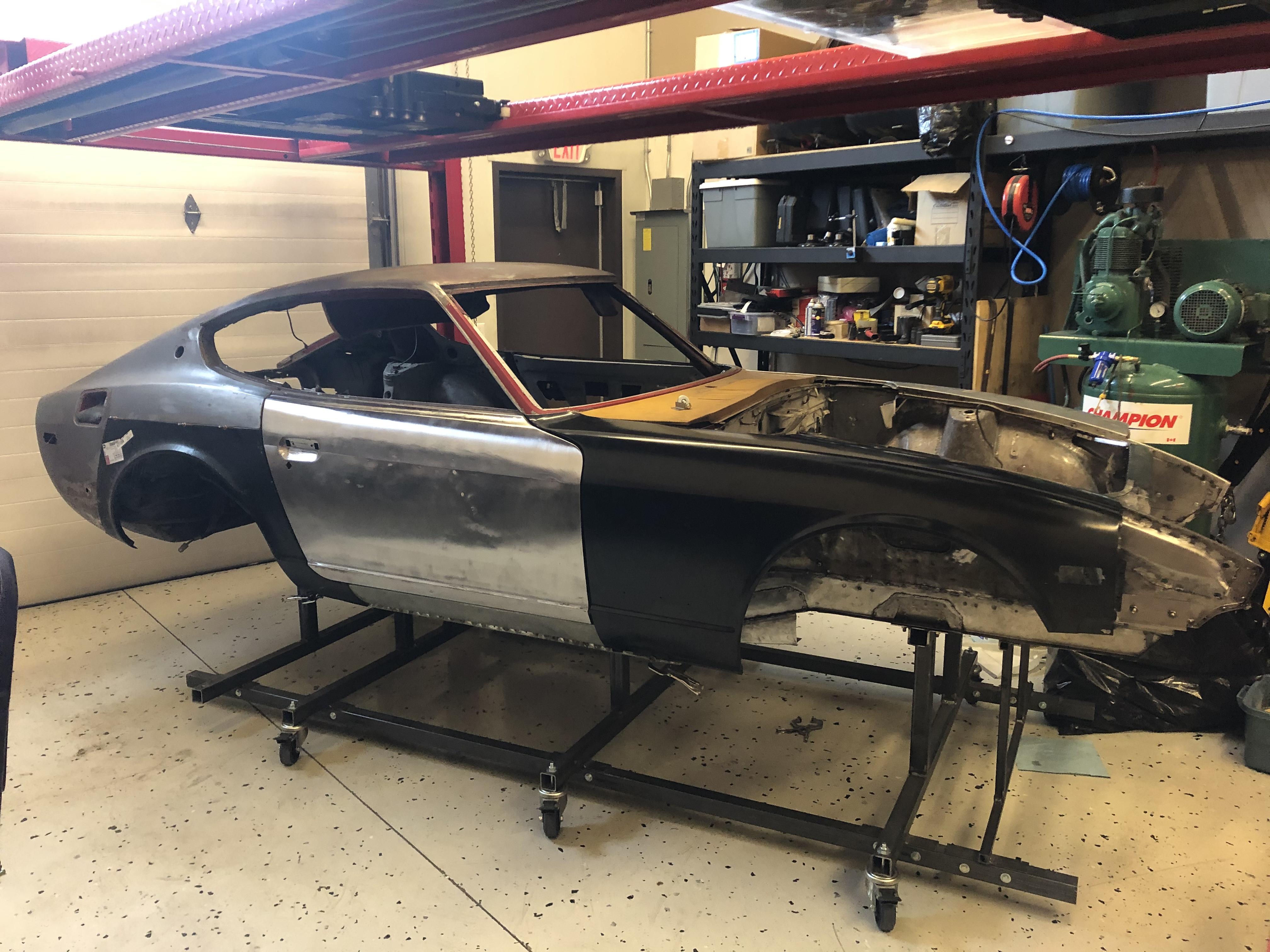

For now I am going to bolt it up to check my work on the passenger side ....
Thanks!  Our mutual friend "G"suggested that I get all the panels to primer and then have a mobile PDR (paintless dent repair) guy go over the whole car to minimize the amount of filler needed.  So I might give that a try ...still a few weeks away....
