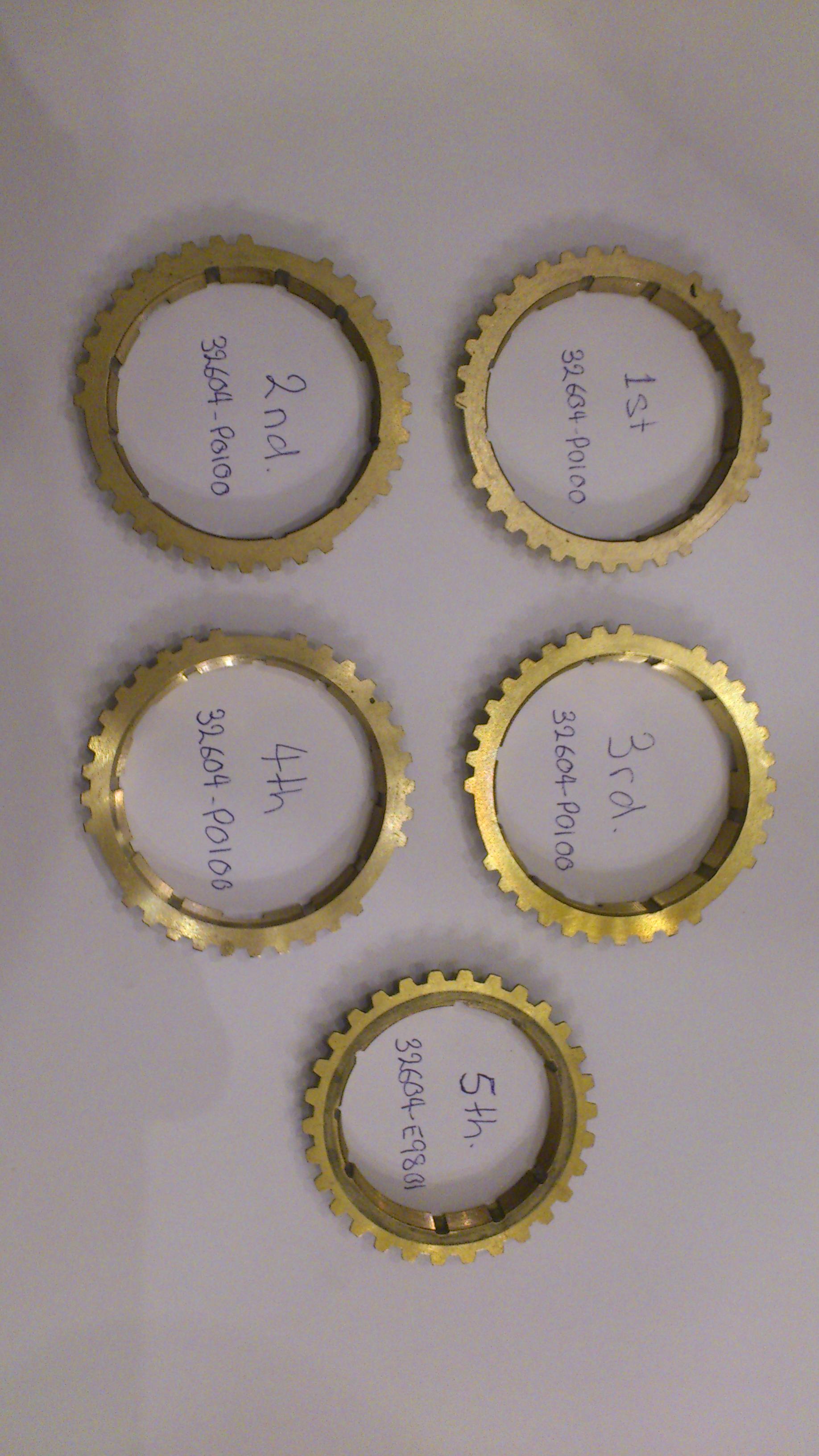

A kit like this would be what you would want for the bearings. They also sell bearing kits with synchros, but I have had poor performance from the aftermarket rings and endd up sourcing the rings from Nissan.

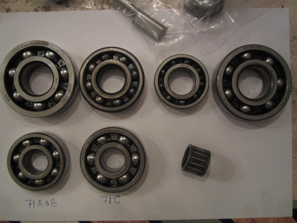

Most of the parts in my list were for my 71B, but will fit the 71C. Main difference is the selector control section and the front cluster shaft bearing.
The bearing kit will have all the main bearings, front gasket and rear oil seal. Optional are the synchro rings (Baulk rings).

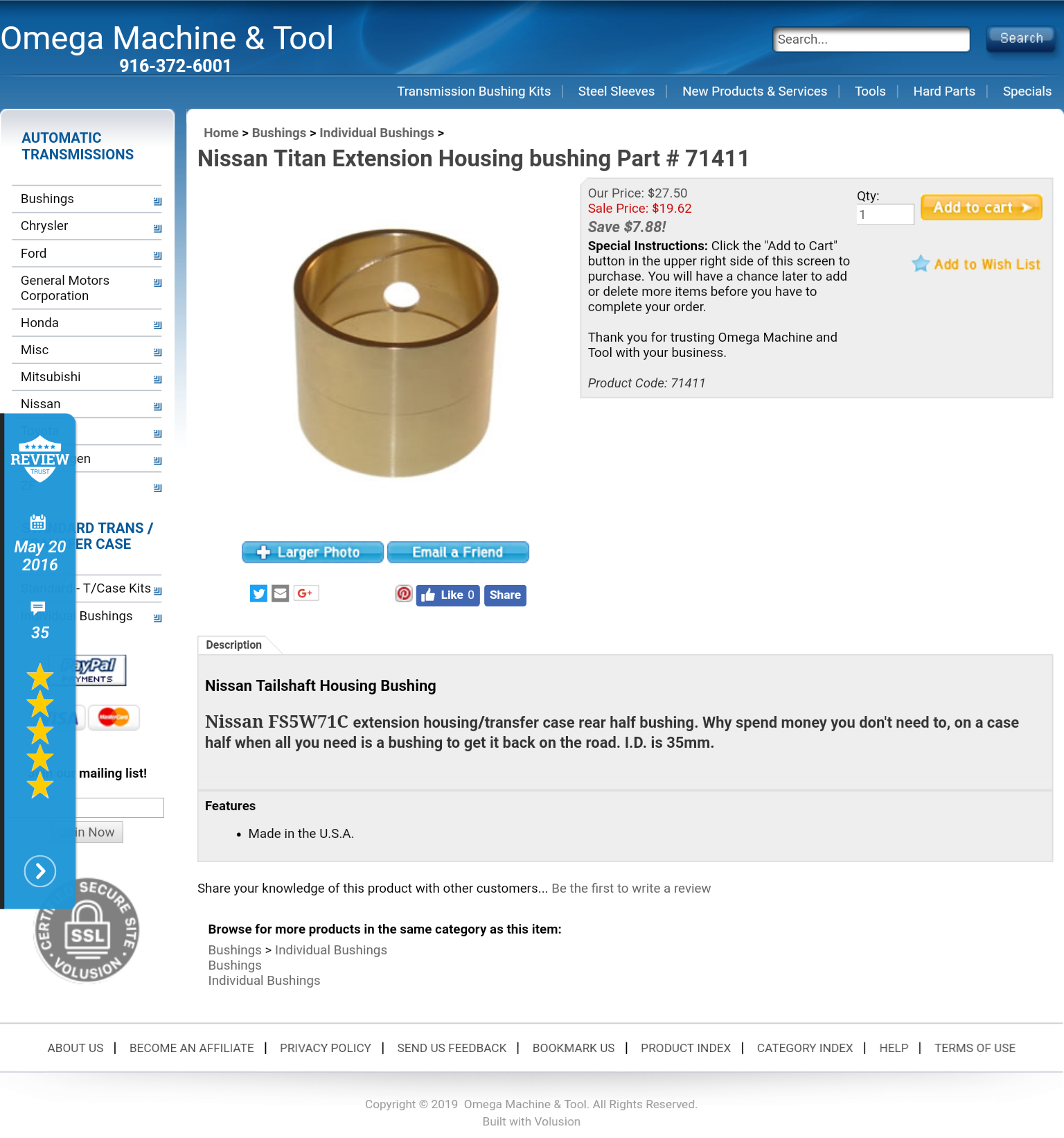

I ordered all the parts through Nissan with the exception of the Omega rear extension bush.

See photos for the bearings, synchros and rear extension bush.

The BK-104 kit will work. It comes with two front bearings, or it use to anyway. The 63/22 C3 for the 71A & 71B and the larger bearing for the 71C.
