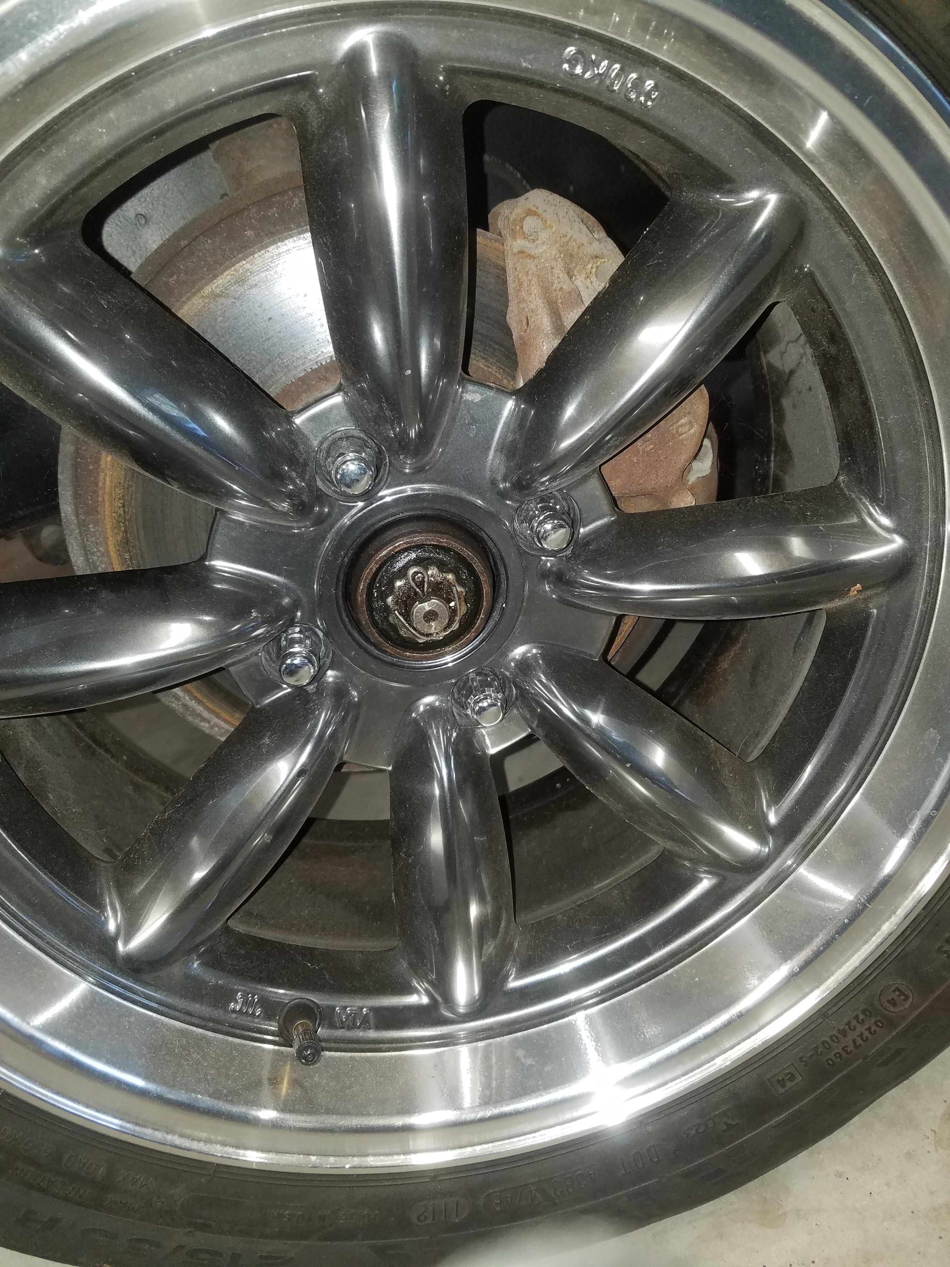

here are pics- front wheel  cap cannot be inserted, rear wheel cap snaps right in
Sandpaper and elbow grease.  Seems like the walls must be too thick to fit in the gap.  Take a picture of the back of the cap.  Take some measurements.  Things will become clear.
Even then you might have to get all Hulk on the dust caps.  You don't want to leave your bearings exposed.
Edited by Zed Head
I understand the issue. Give this a try... Take a front wheel off the car, snap the cap in, and then put the front wheel back on.

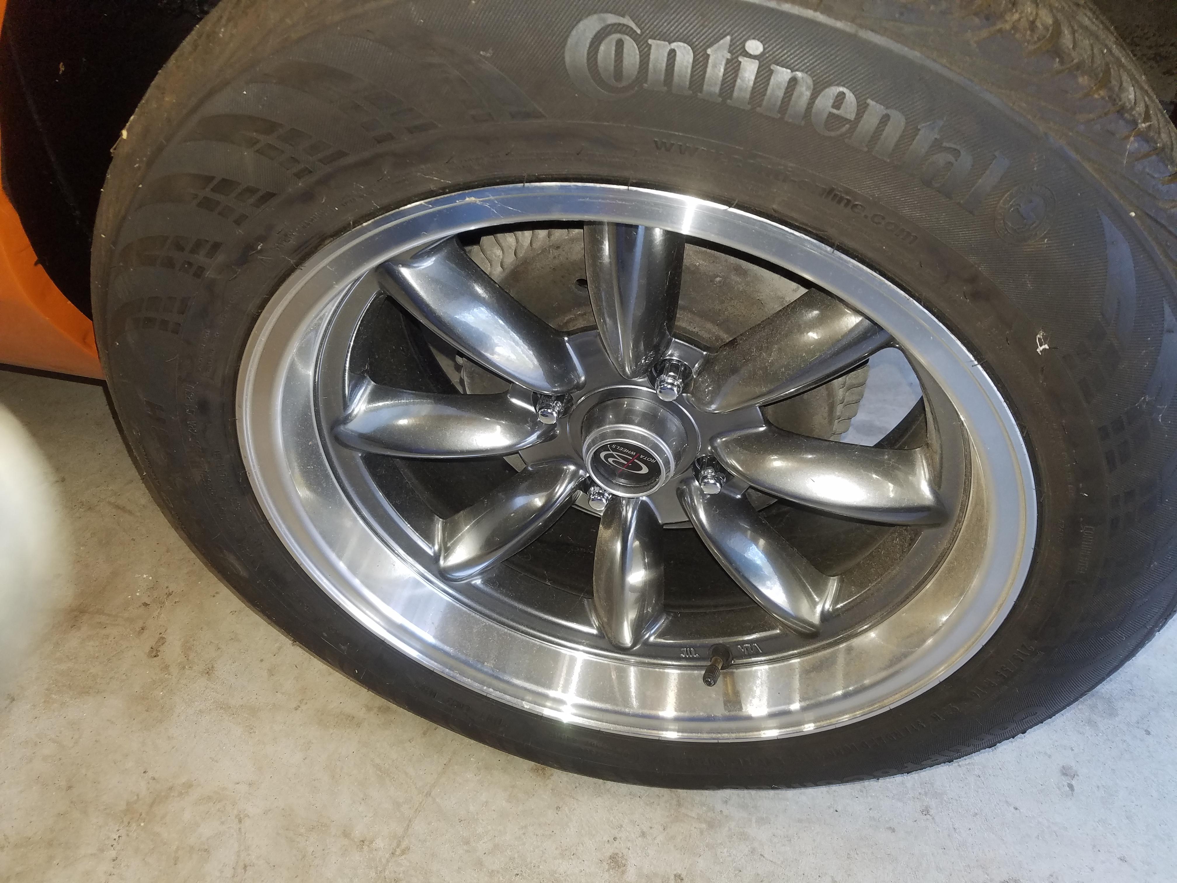

Those caps look like they're not as tall as the ones that came with my wheels. These caps fit over the dust caps just fine with no mod to the cap. I bought my wheels here; https://www.18racing.com/collections/rb/products/rota-rb-1570-4x114-3-4-73-gunmetal-with-polish-lip Maybe they will sell just the caps.
